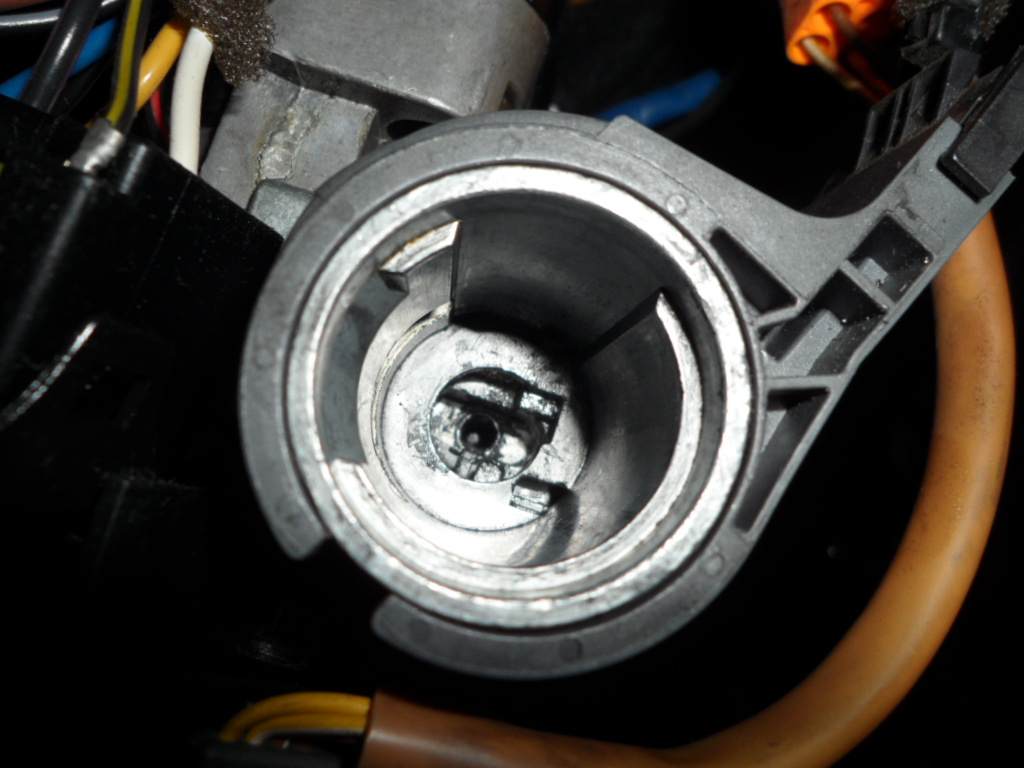

I've removed the current ingition barrel, to replace it...
It came out fairly easily, but the replacement won't go back in now...
I've tried another 3 ignition barrel's and none would go in all the way...
Is there some sort of trick to this???

and have you got the key in the correct postion on the new one??? and the small lock tab is held down by a pin or something as you insert it ??

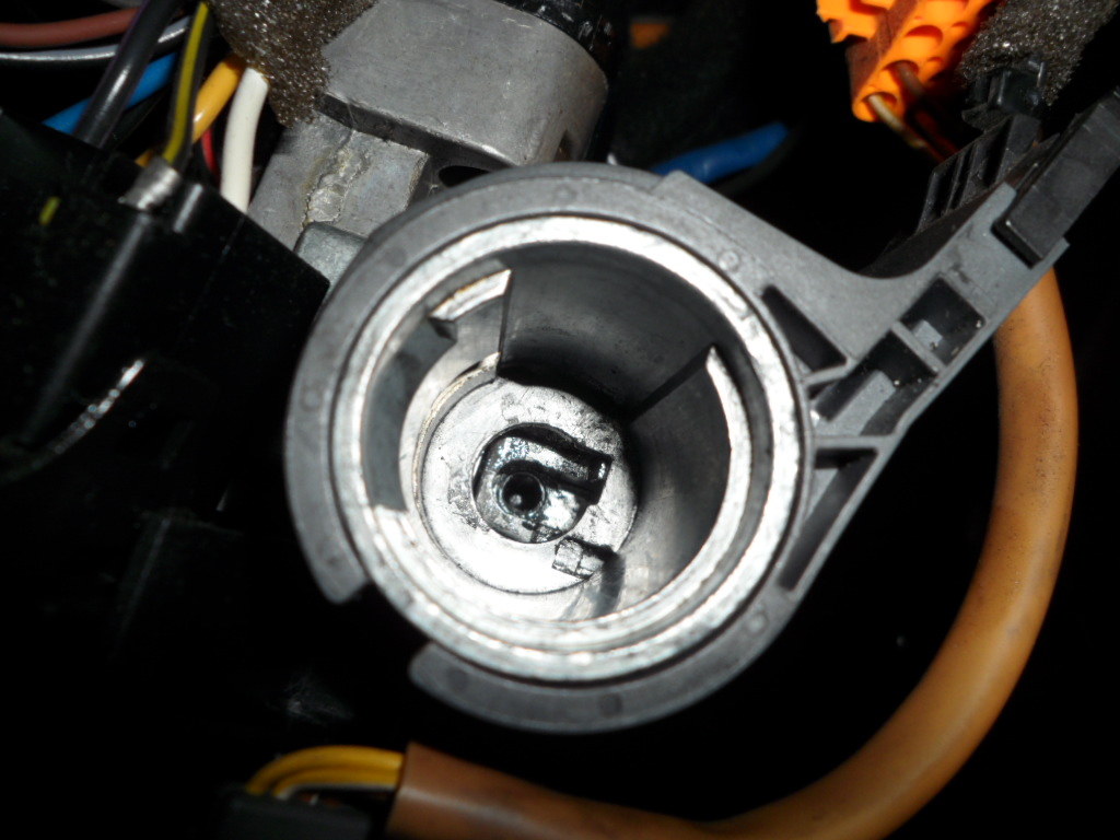

I'll add some info and pics, once it's all done!!!

Finally, I got the Bugger fitted...
THE FOLLOWING STEPS WILL HELP ALOT...
1 - Ensure that the 'Steering Wheel' is NOT Locked...
That's why I had problems, getting it to fit correctly...
2 - Use a small screw driver, to depress the Tab at the Lower Right of the Ignition Cylinder...
3 - Turn the key one click, so that the Locking Tab on Top of the Barrel, will depress and allow insertion...
4 - Use some WD-40 or Olive Oil to lubricate the Barrel, prior to fitting...
5 - Gently insert the Ignition Barrel into the Ignition Cylinder fully, then turn the key to start the car...
6 - Turn car off, and retract the Key... Repeat this Test a few times...
I'm sure these steps, will help those in need of this info some day...
