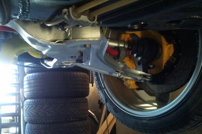

The front brakes callipers are mitsubishi evo fq320 4 pot brembos and the two piece rotors are black diamond 320x32 but they did need a specially machined spacer ring on the back of the bell to offset the rotor. The wheels arent the best make but it was a real struggle to find alloys where the spokes cleared the big brembos and that wasnt motorsport derived yet still the wheel offset had to be machined to get them back as close to the favoured vauxhall offset but leaving just enough calliper clearance. nightmare really!
