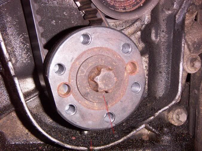

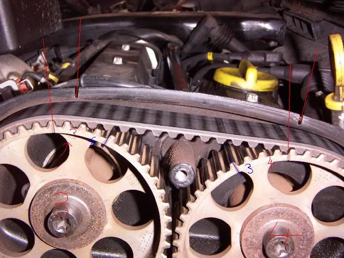

and I still think your timing is out, pictures you posted showed the bottom mark on the cover mark, the correct mark is behind the bottom pulley

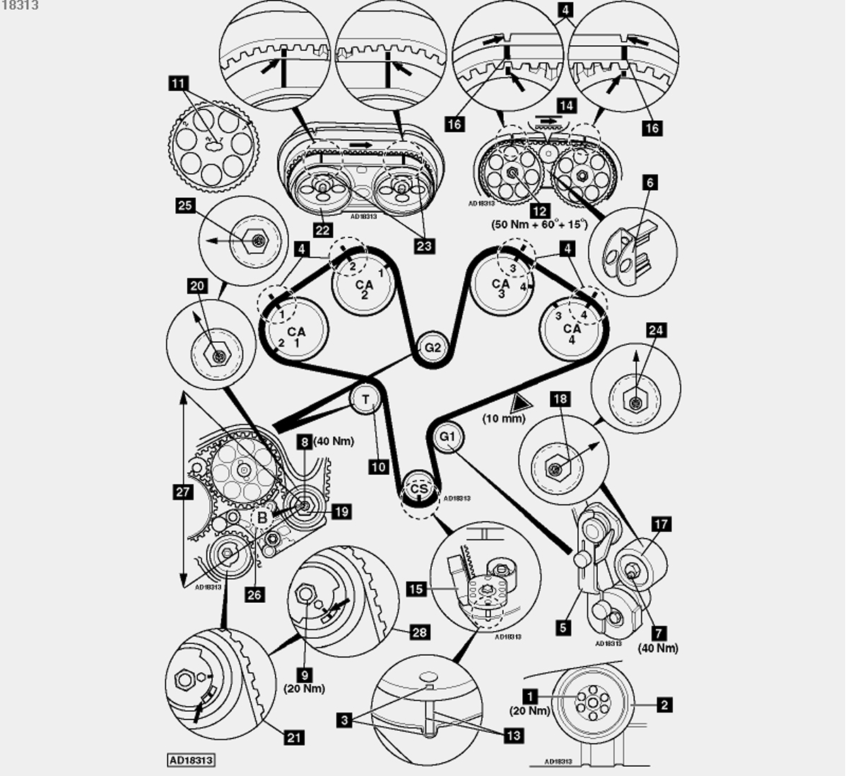

fraz have you got any pictures of the correct timing marks

I have that pic somewhere, 2 secs

As I said rich you showed a picture of the timing marks...only you had it all timed using the bottom mark on the cover...that is not the correct mark to time the engine when replacing the belt
the correct mark is behind the bottom pulley ...so if you have set the belt using the mark you used, the timing is out by about 10 degrees ( i think the mark on cover is that)

found them and its not the cove ryou used but the oil pump
this is wrong
this is wrong

wee search and
this is the correct bottom mark though its not very clear there is a notch in the crankshaft pulley that aligns with a notch in the bottom of the timing back plate ...if you look there is two red marks shown ..they both should be in line
cant really see for the pictures you posted but the front bank marks are
cant find a picture of the back bank but, if you look at the picture that was posted the marks are shown
