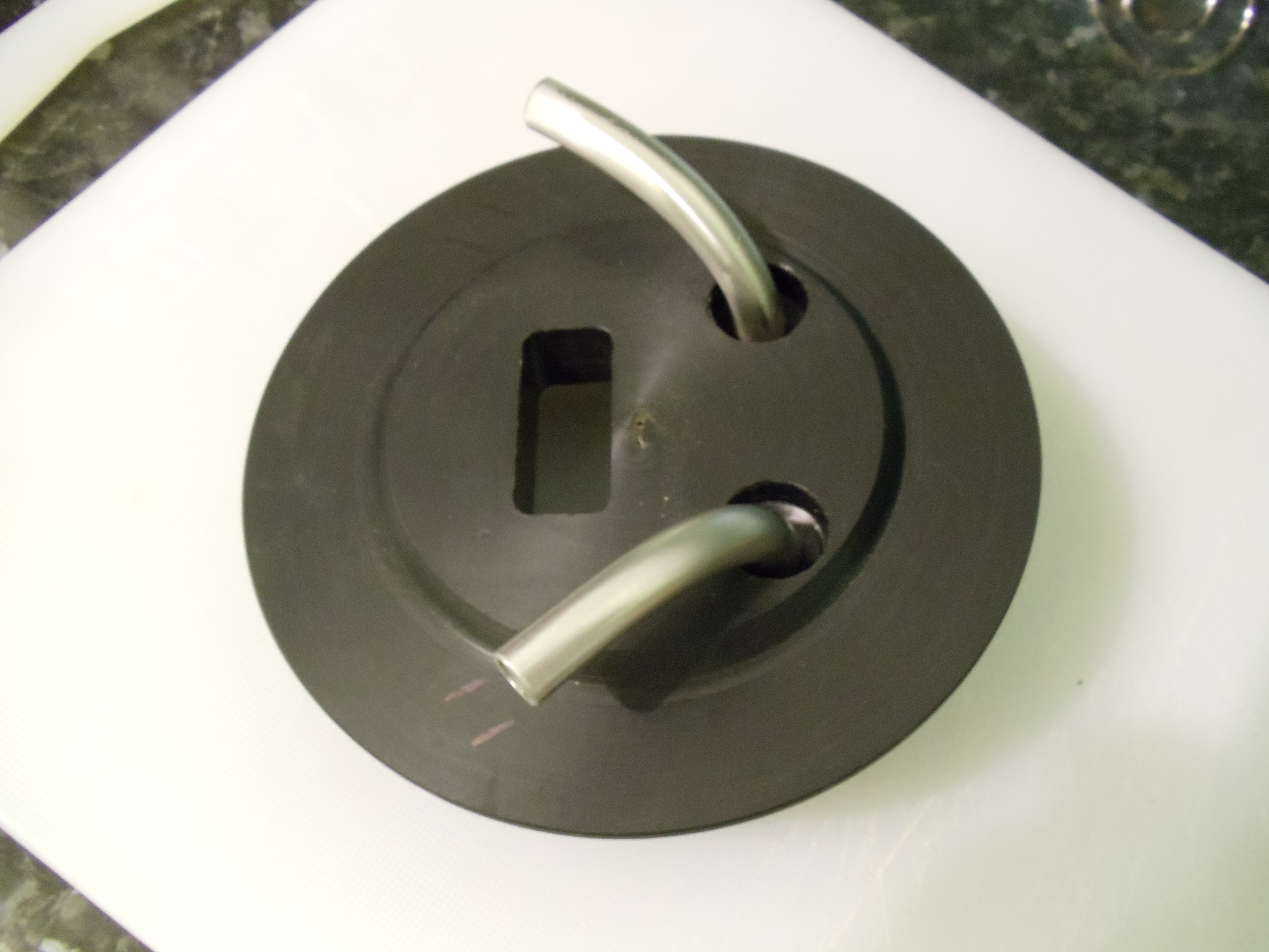

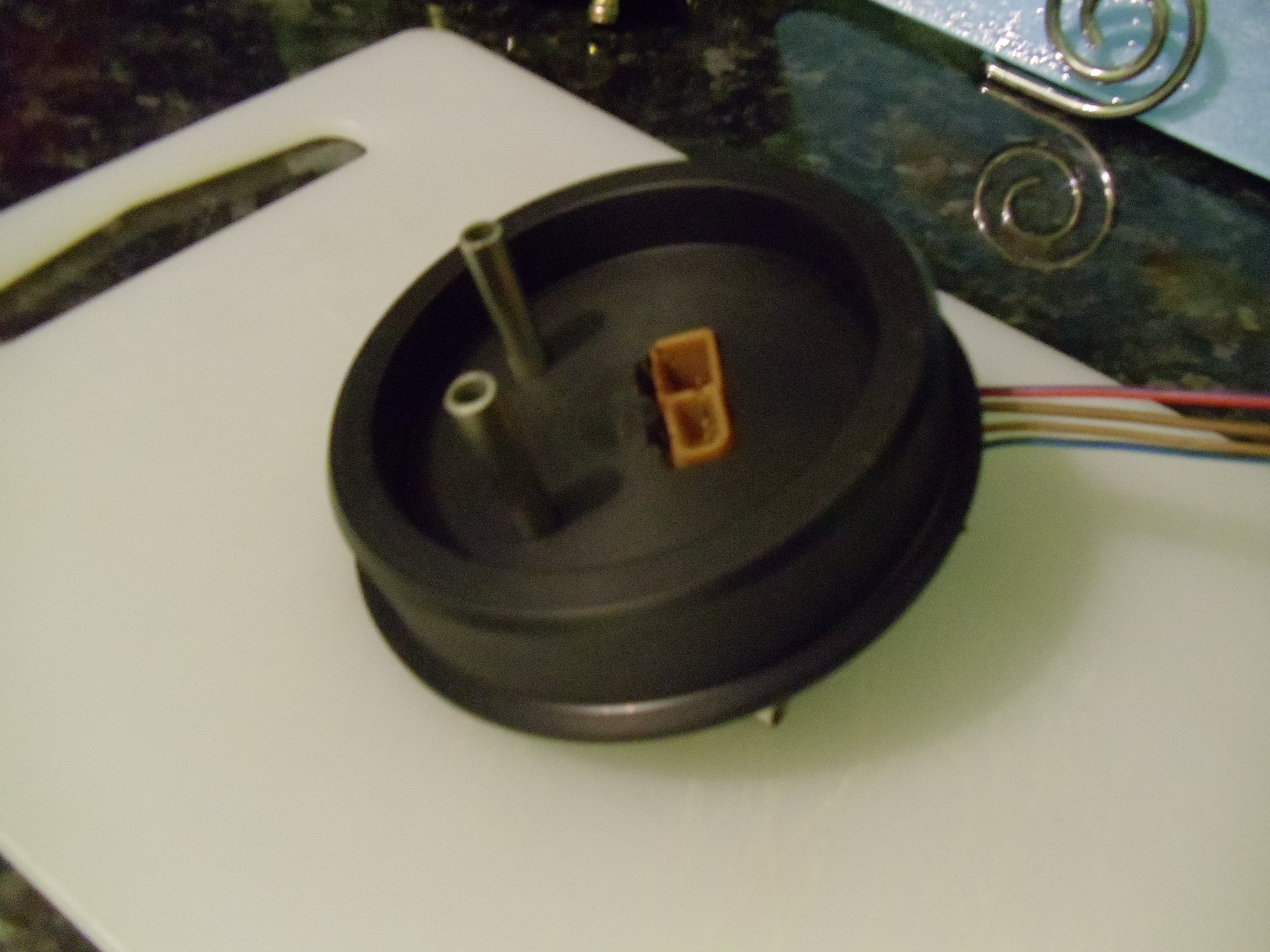

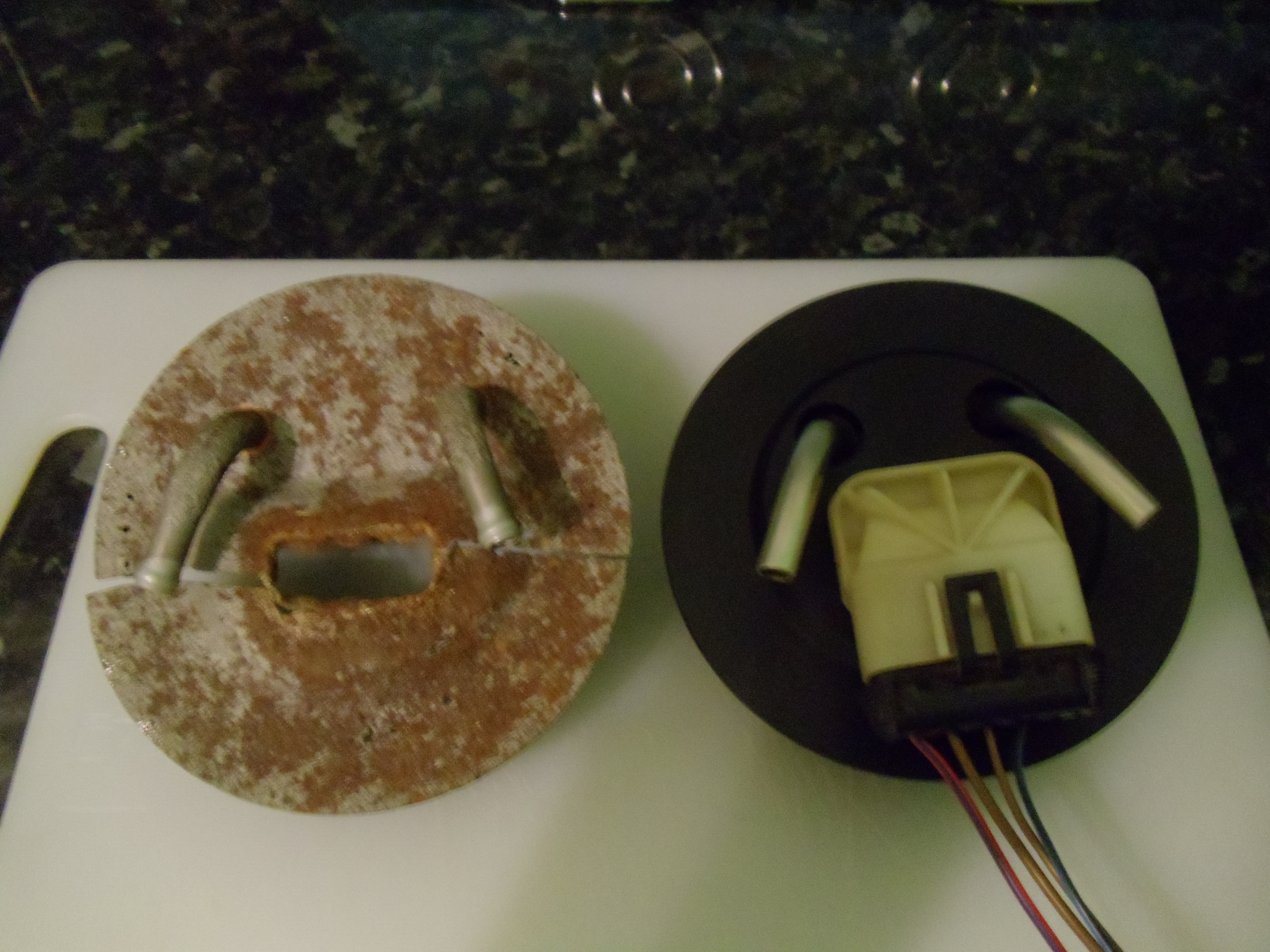

I got this made as the metal one was fooked. I can't get anymore made as i don't work there anymore. I'm not sure but i think its made from some type of plastic.

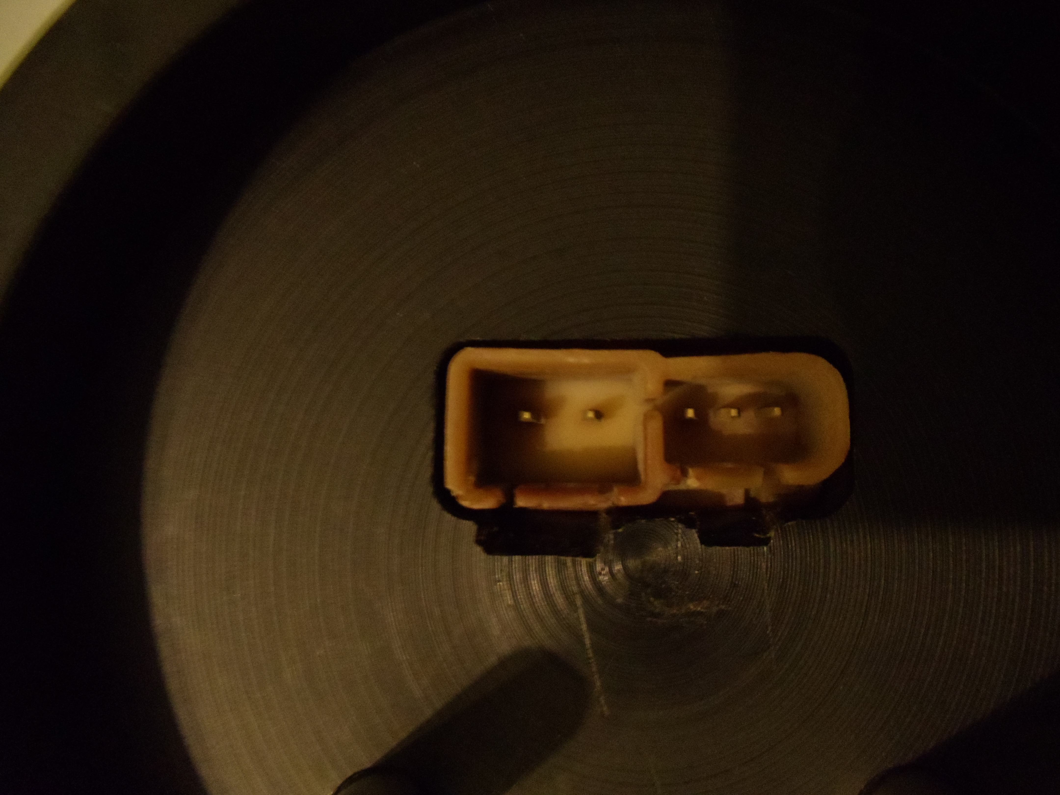

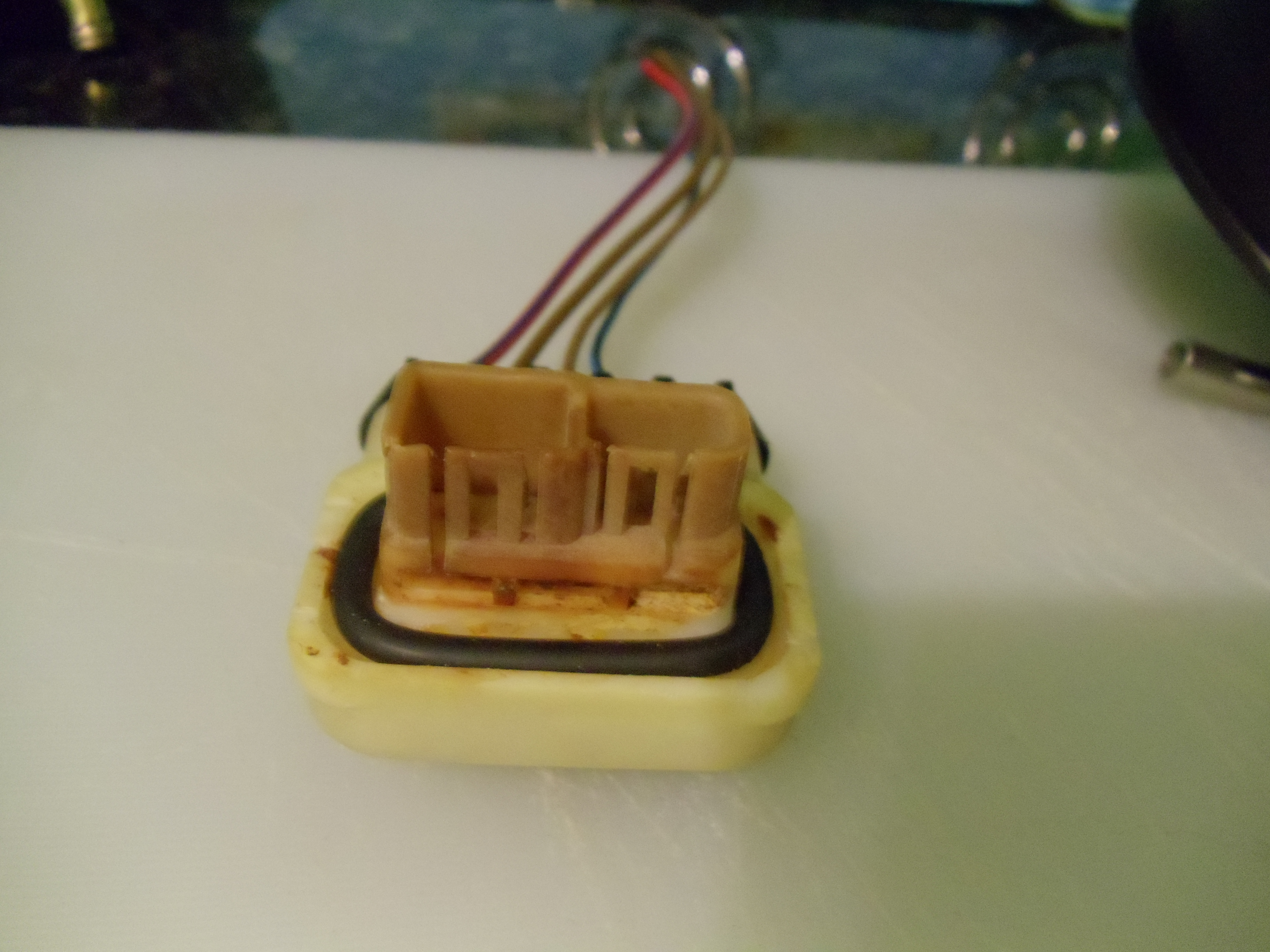

I removed the old multi plug from the old flange
I had to change it a bit so i could remove the plugs if i needed to.
there is a countersunk ring around the s/steel pipes to put some type of bonding compound in to hold the pipes but i may change this part.

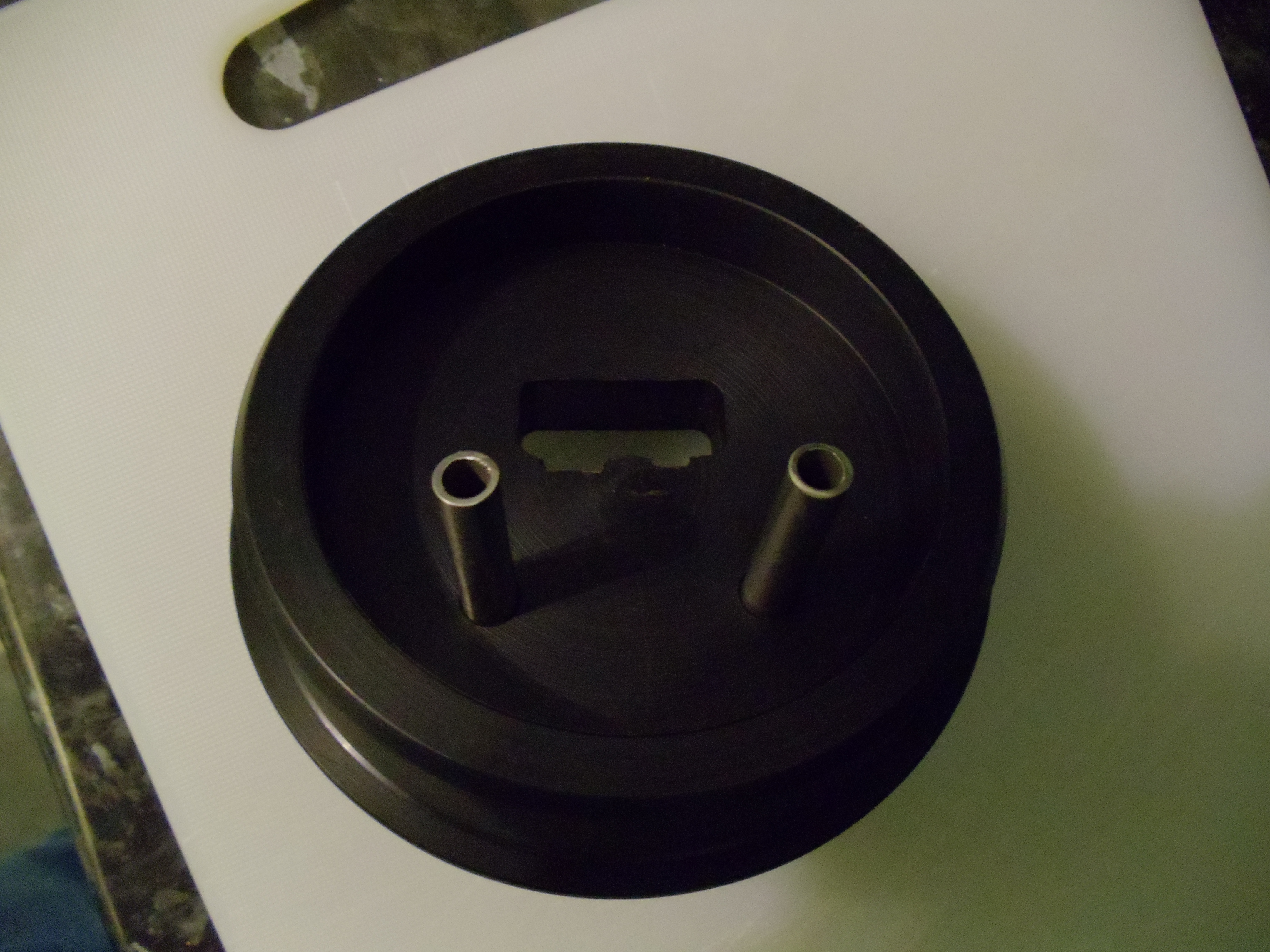

Hi Alan, i hope you can get them made. I would say to the guy to mod the under side a bit because i hadn't removed the multi plug from the old flange when i got it made. As you can see from the 2nd and 3rd photos the multi plug sits flush to the base and the mod i had to do to remove the plugs if i ever need to as the multi plug will need to be bonded to the flange as i dont trust it just being pressed in, i bet it will work its way out over time and let water and dirt in.

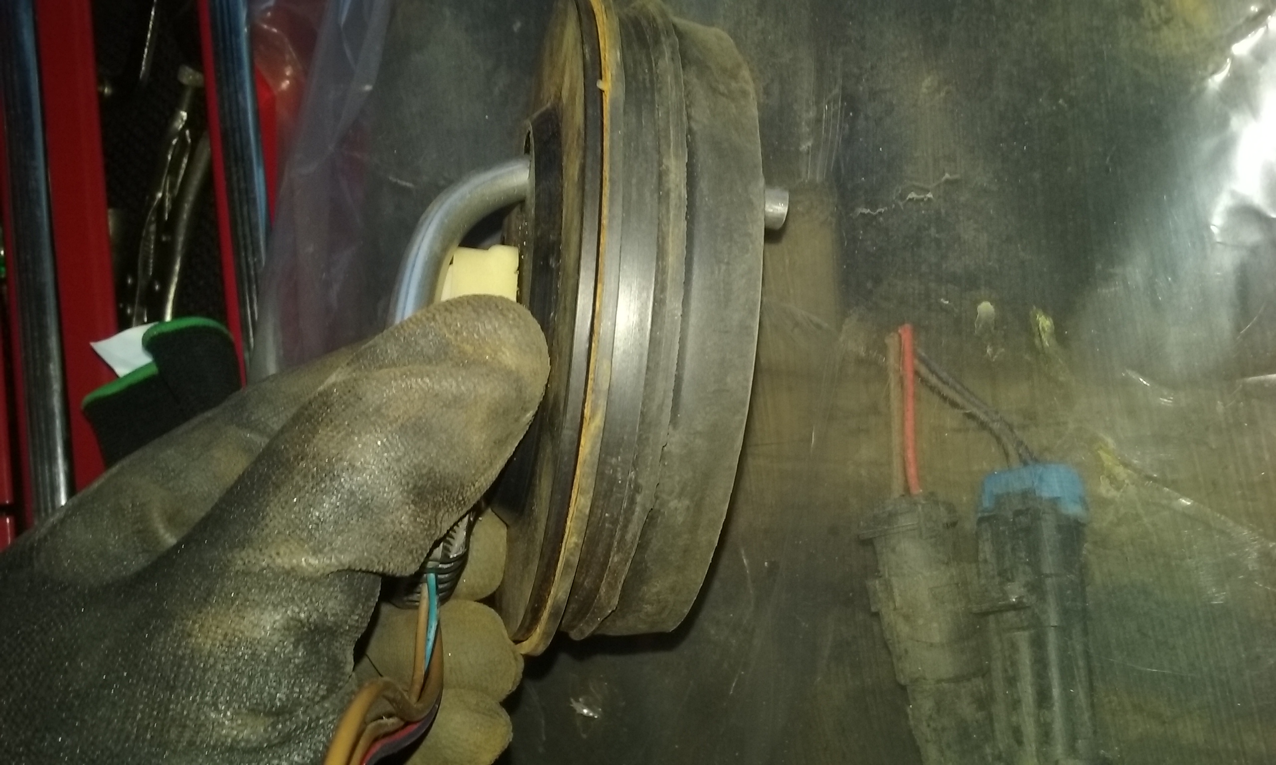

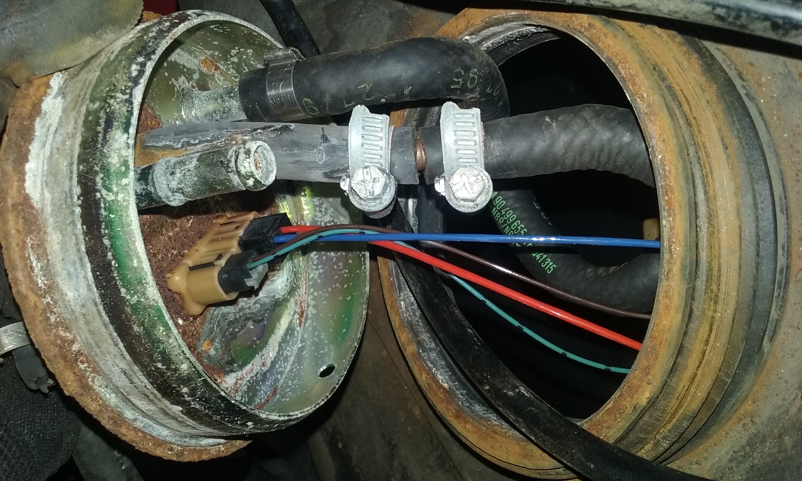

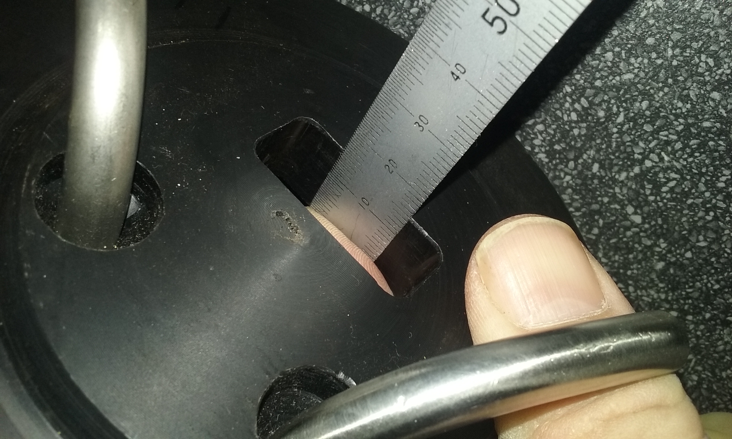

. I have been out to the hut and dug out my spare tank from my old ecotec to prove it fits. The 1st photo shows the plugs for the fuel pump and sender unit that we need to be able to remove to change the pump/sender.
The 2nd is the depth from the top to the underside of the flange, 15mm. The mod i was talking about is to cut/turn that down to 10mm or 5mm as that should give the room needed.
The 3rd and 4th and 5th shows the rubber seal fits the flange and both parts fit the tank. i didn't fit it all the way as im not ready to fit yet.

Hi Phill,
The drawing shws the overall height of the cap at 31mm with the 90mm dia bore being 23mm deep. This means the thickness left is 8mm, so no mod should be required ( if i have read it correctly ), so this should be fine for putting the electrical connector in.
