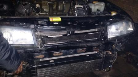

Bit more body bashing and plastic removal (from the sides of the saab radiator) resulted in all 3 items fitting as pictured and with no need to move the rad from the original calibra mounting points
just need to make up a couple of small brackets to locate things in place and get James to slap a coat of black paint on the bent metal and the jobs "a goodun"

Can't quite tell as that's a s**t pic Andy but looks like you have the intercooler quite proud of that front impact beam (where we had it initially it was nicely below it).
Don't count your chickens until that's been held in place with cable ties & you try getting the bumper over it (as much as the bumper will need a little chopping to accommodate the intercooler, you may be pushing your luck there)!

The bumper beam isn't on there mate!!

Which doesn't mean that I'm not planning to refit it !!
It was removed to make hitting the panel behind it easier!! that's the one you can see with the holes in it - rest assured the intercooler is in exactly the same place as it was!! (with the exception of now being the right way round
DanSE4 wrote:I'd be getting those front brakes uprated sooner rather than later then!
Umm !! me too !! but that's a conversation we've already had!!

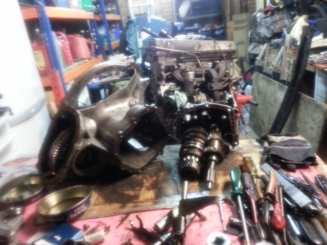

Stripped and half the bearings done!!
Hopefully the rest tomorrow
Then I just have to get it back together!!

Ho lee fuq. That is quite a sight! Andy I swear you're one productive guy when I'm not there! You trying to tell me something??
I was NOT expecting to see that this evening! I will shower you with fags and chicken burgers come Sunday!
Well, yeah. Erring on the side of caution a bit. Bought it from a gentleman called Vauxmaster on MIG. He recalled a vague mileage of 60-70k iirc? Wasn't certain on mileage (and not sure I remember right even) but it came from an Astra GTE along with the engine, which he'd stripped and noted as having been in incredible condition internally and externally. He'd mentioned if it were him that he'd change the main bearings and give it a little tlc. Offered his own guy to do the work if I couldn't get it done but his guy wasn't available. Got that F20 and another one in unknown condition for £50 I think it was.

Bit more done today although a breakage during the F20 stripdown (nothing to do with me!!) means the F18 is going in for now, what James does about that in the future is up to him.
I'm not entirely happy with the clutch arrangement but again, if it gets James by for now then it'll do.
The F18 had a pot flywheel but that wont fit on the b204 as the centre hole is larger then the flange on the crankshaft end so have to use the SAAB flat flywheel which means also having to use the SAAB pressure plate. Have to use the friction plate from the F18 as the input shaft is thinner so the SAAB friction plate is no good.
The friction plate is notably smaller than the pressure plate now.
It's got to the point of use what we have to make this thing at least drive otherwise James's shopping list will be going through the roof & it'll just carry on taking longer & longer.
Clutch & gearbox all assembled now & attached to engine.
So, engine in tomorrow & then I'll leave James & Andy with the plumping while I don the soldering iron & get this loom sorted out. I chopped the 3 small connectors with plenty of wire on each from the old NE loom so got to get my head around that lot!
