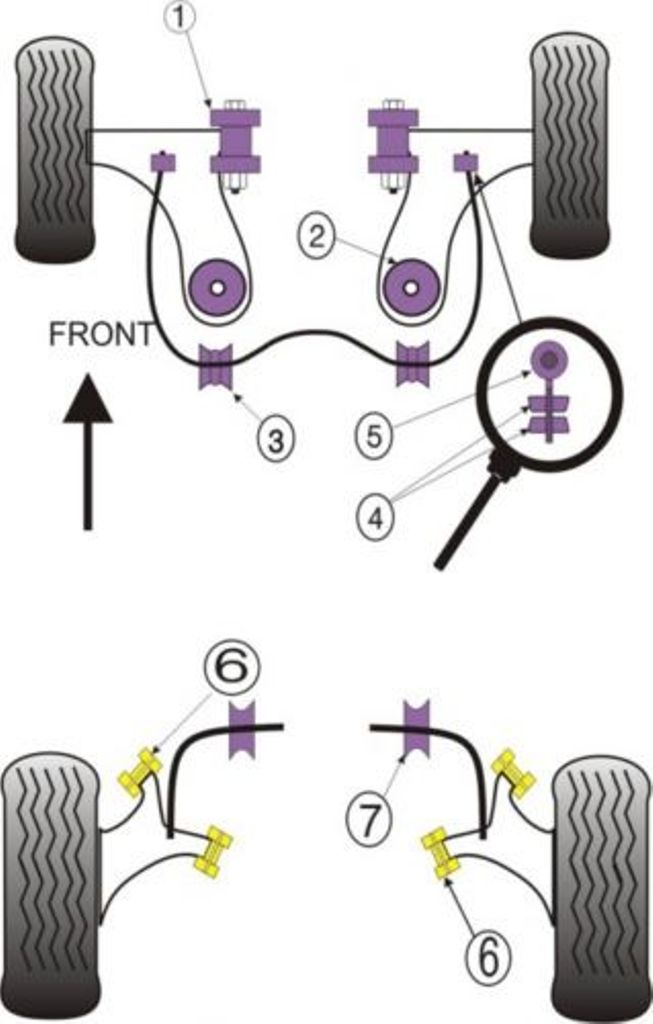

can anyone explain to me where the front anti roll bar
eye bolt bush goes,as i got the front set of bushes
today and the diagram ive got is not very clear. A
photograph would be appreciated,thanks

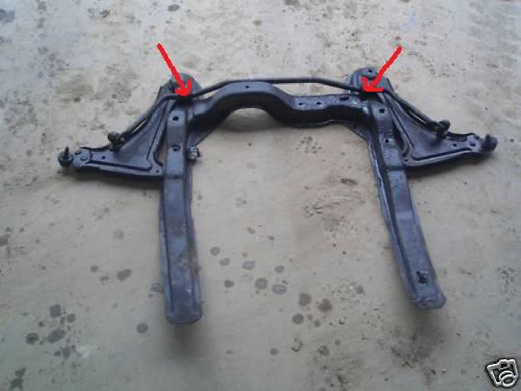

Re: Front bushes
Well the front anti roll bar bushes are on the subframe mate

Ive got them mate but these other bushes
say on th pack front anti roll bar eye bolt bush
Re: Front bushes

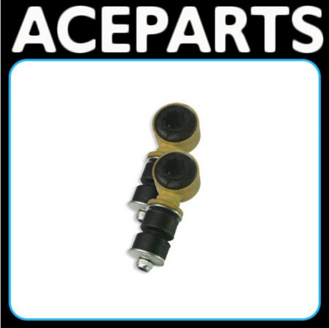

Ok craig if you are on about number five.these were for the early calibras and cavaliers which had a different anti roll bar link to yours mate
Re: Front bushes
Here is a pic of the older type of anti roll bar link.if i remember i use to hate fittting these god they were a tight fit.
Re: Front bushes
Thanks alot for that mate,i was pulling my
hair out trying to think how they were going
to fit.i'll send them back for a refund
