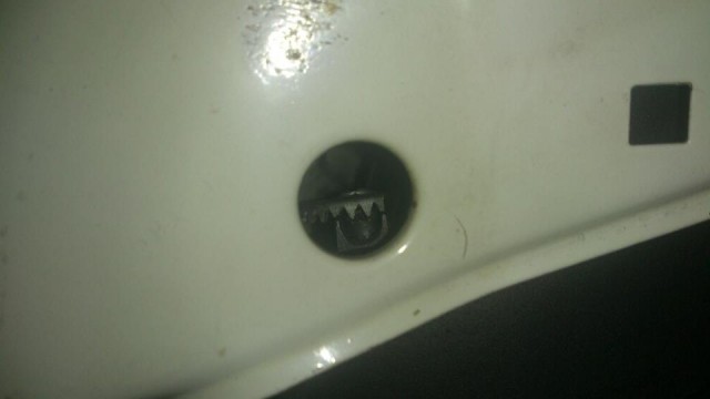

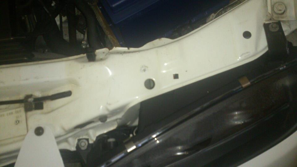

craigyboy wrote: Does anyone know how to alter the beam, to face to the left on the sonar after market headlight units?
I just want to know, before I go and strip the front of the car...
No need to remove anything...
Get a screw driver, stick it in that hole, and turn that jagged wheel accordingly...

Gave it a try and it doesn't seem to be working
I think that's for altering the main beam and not the
dipped headlight. I'll have to take off the bumper
and get the lights out.
