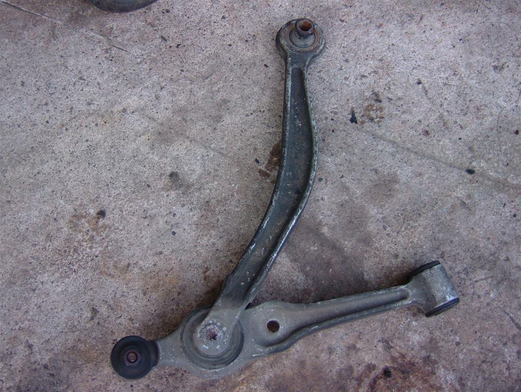

by DanSE4 » Mon Oct 06, 2014 4:56 pm
The 9-3 (2000 'W') I was under this weekend looks like it has the alloy wishbones.
Didn't do any comparisons as they are to remain in place to keep the Saab "rollable" but visually they look like a direct fit to a Calibra.

by DanSE4 » Mon Oct 06, 2014 5:02 pm
These ones I think.

Re: What is best donor Saab?
by Chavtastic » Mon Oct 06, 2014 7:47 pm
They are the puppies! Apparently you need the anti roll bar too from the Saab
by DanSE4 » Tue Oct 07, 2014 10:05 am
Chavtastic wrote:Apparently you need the anti roll bar too from the Saab
Could be where the anti roll bar drop links connect to the wishbone, the locating holes may be in a slightly different place. I'll take a closer look this Saturday.
by Chavtastic » Tue Oct 07, 2014 4:11 pm
Yes Dan that's what I've read
v6 steve wrote:didnt you already do this to one of your calibras Ben
No mate I think I got the wishbones but realised they needed the ARB
