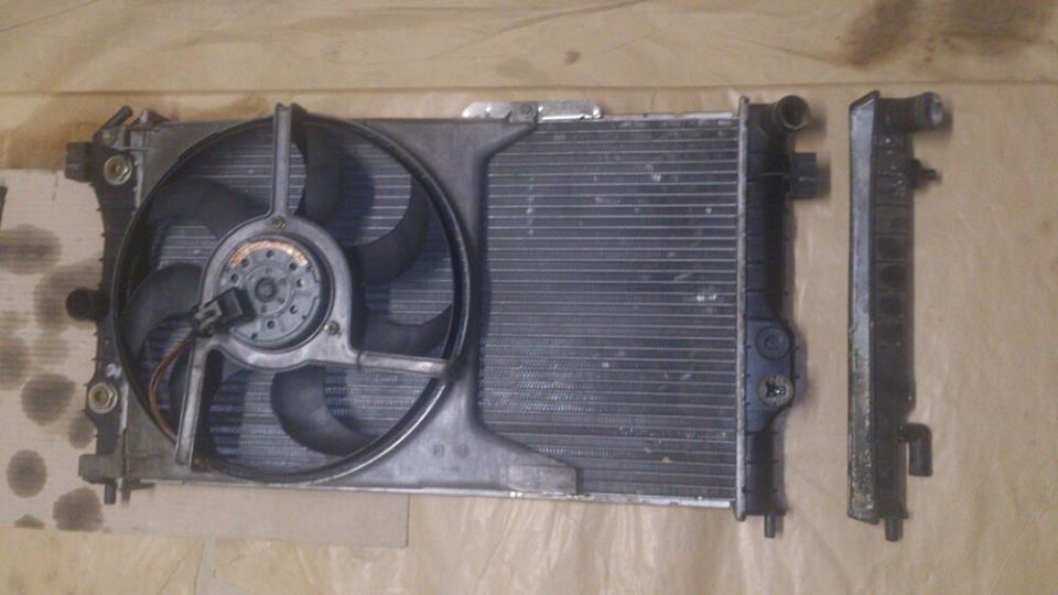

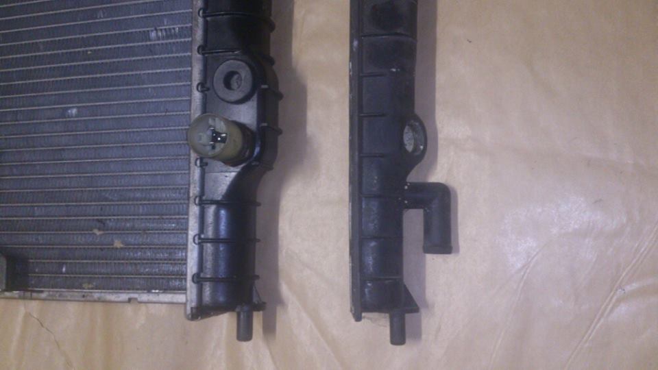

Installing new rad today , unfortunately new rad is useless as it doesn't have the connections on it for the pipe work for the secondary water pump

Unless suppliers have an alternative, I'm looking at a recore

You can swap the side tanks over...
A mate recently had this same issue...
I sent him over the side tank, with the 'Aux Water Pump' fitting...
He heated it up in the oven, in order to fit in back onto the Radiator Core...
Also, I once scored a Radiator off a V6 that didn't even have a fitting for the Aux Water Pump...
It being so cold over there in UK, perhaps it might not be so necessary to have the AWP connected...

While the rad is out might as well remove the front a/c rad as it's all disconnected anyway
Re: Body Kit fitted
couldnt you just cut it in ?
Re: Body Kit fitted
v6 steve wrote:couldnt you just cut it in ?
Eh?
Rad is breached, needs a recore
Managed to get the rad out, also removed the a/c rad as surplus to requirements as a/c is disconnected
