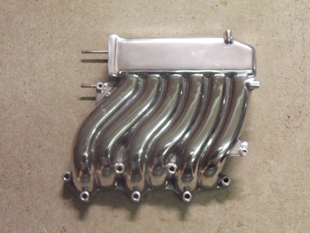

rich30mex wrote:Shinny mmmmm looking good mate keep up the good work
Thanks Mate...
I'm hoping that this 'Polished Manifold' will blind people, when I open the bonnet on a sunny day!
The Chrome Bonnet Struts are also on the Shopping List...

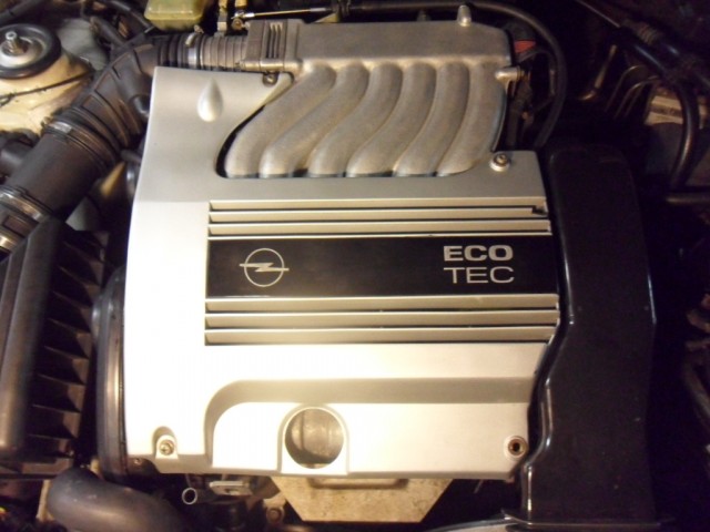

Did You have any work to do to get the Engine Cover back on, after the Cam Cover Upgrade?
Some Dude told me he wasn't able to put the cover back on, after he did his Cam covers!!!

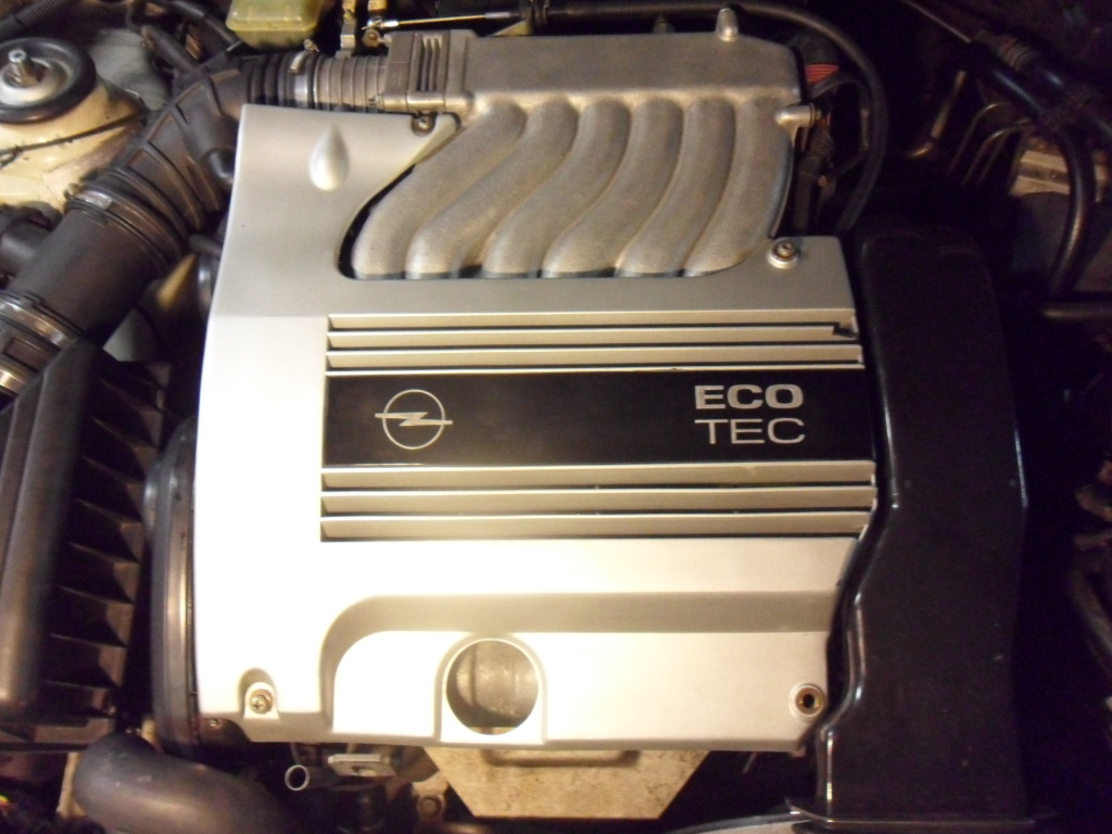

I intend on Trimming the Current Engine Cover!!!
Rear Cam Cover: Decent Clean, as it's barely visable...
Front Cam Cover: Nicely Polished Finish, as part of it will be visable...
let me Guess a Dude from Scotland????
and as i have said ...you can fit the engine cover on with the vectra cam covers...only problem is the oil filler aperture is now in the wrong location ...so you have 4 options
1. leave cover off
2. keep cover on with the aperture in wrong place ..means taking cover off to top up oil
3. Fill the hole in the cover (like Steve has) ..means taking cover off to top up oil
4. Fill original hole in cover and cut new one for the oil filler
Re: Eddey's V6 Profile
the cover wont fit if you have metal covers on unless you cut some of the fins so the oil cap fits as it sticks up to far for the cover to sit right down, if you look at my pic you can see just under the v6 badge where iv cut the fins, and as fraz says i need to take my cover off to top oil up and iv filled in the old gape

Do You have to 'Touch Up' that Polished Manifold often, to keep it Sparkling?
Did You try to modify the Oil Cap, in order for the Engine Cover to fit back on?
I have a few ideas in mind on how this might work, but the Oil Cap is certainly on the Modify List...
i never did anything to the cap to be fair i never thought about doing it that way, i just polish the manifold at shows but my car dosnt get used very much

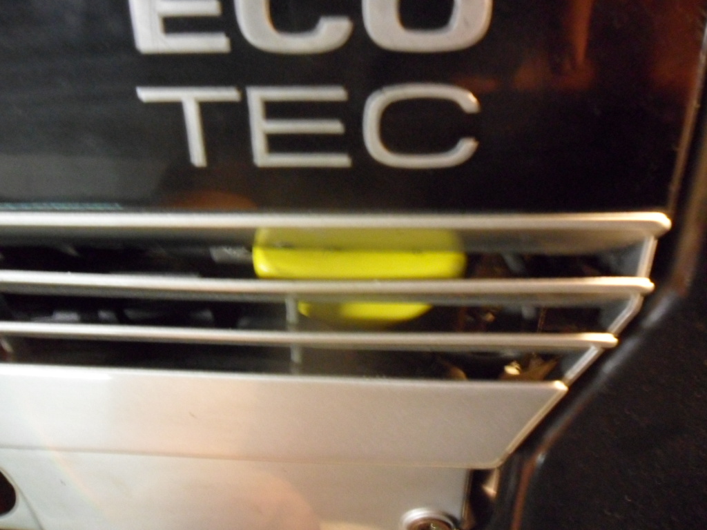

I had a go at getting the Engine Cover on, after fitting the Metal Cam Cover...
I snipped a small tab, which enabled the Cap to sit in the Gap between the fins!
I've got some ideas on other ways of doing this...
I will try them out tomorrow...
