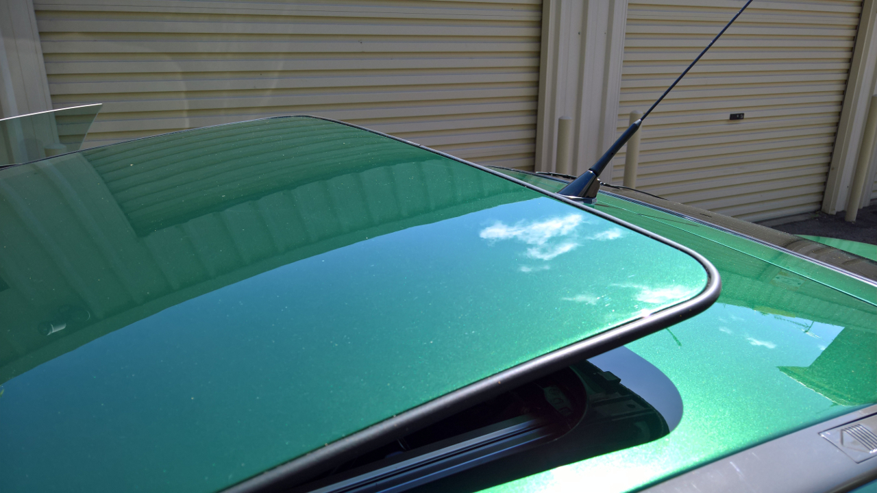

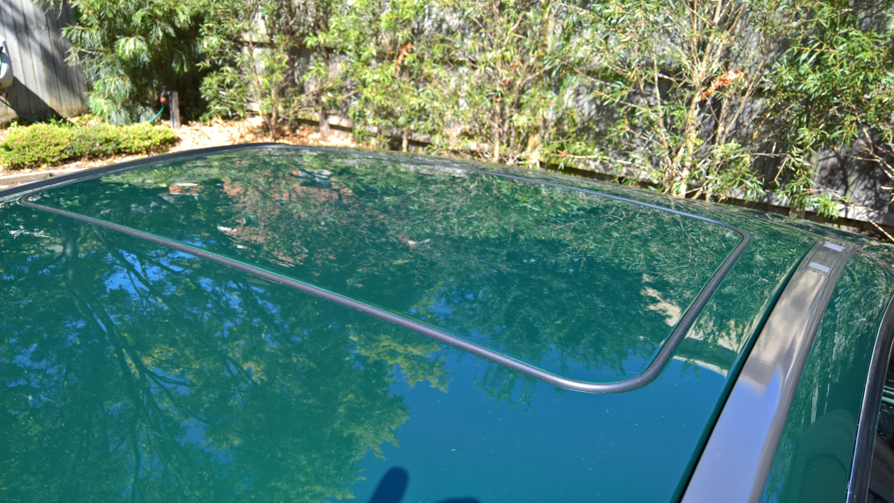

by cal16v » Fri Mar 31, 2017 6:07 am
Sunroof rubber...

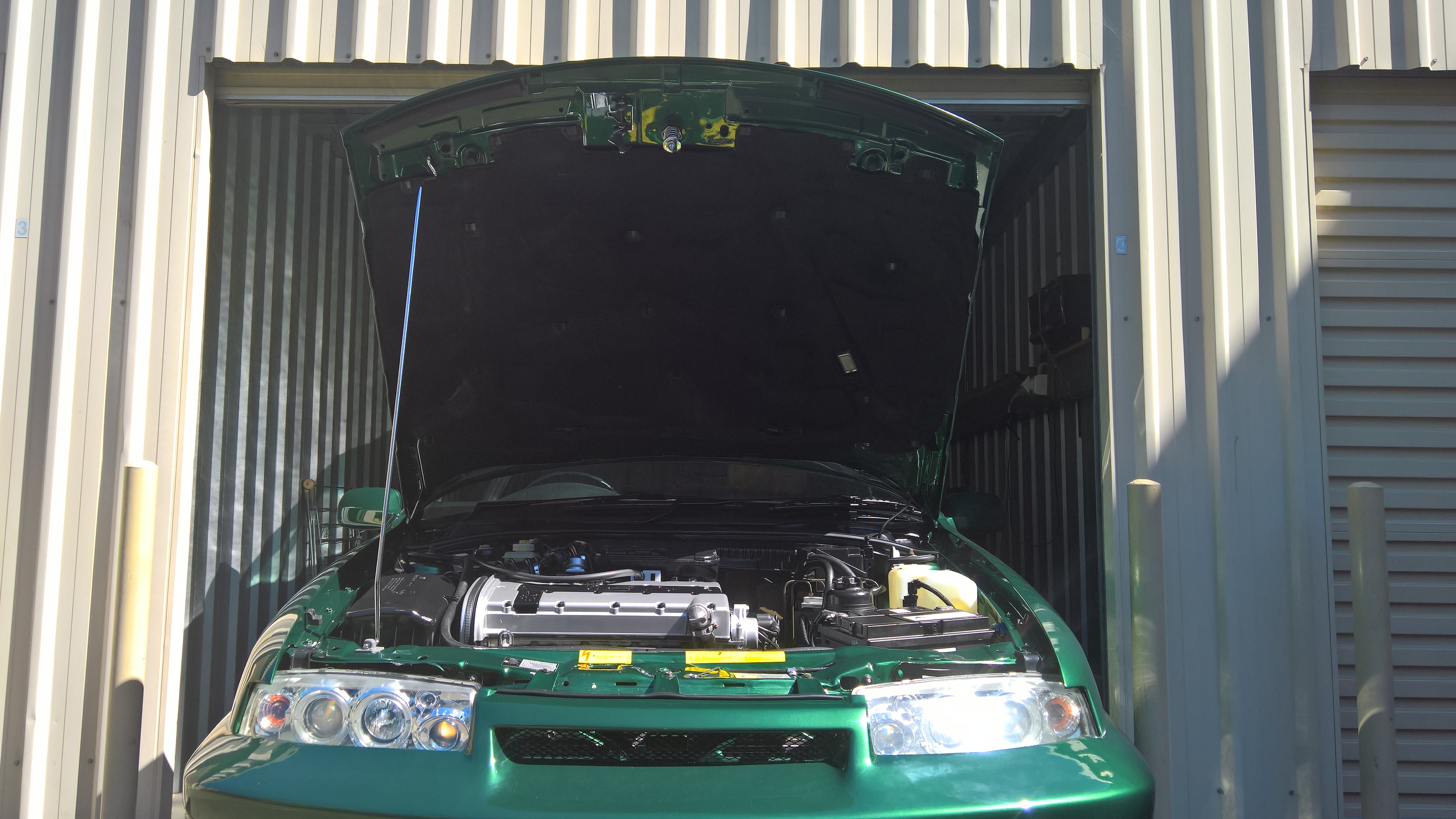

Re: cal16v's WIP
by cal16v » Sat Apr 01, 2017 2:26 am
Under bonnet lining...

by cal16v » Wed May 03, 2017 12:54 pm
Decided to ditch the clear lenses in favour of the oem glass. Coincidently in the pic the drivers side is running the new 55w kit while the passenger side has the previous 35w 6000k bulb running on the 55w kit. The difference in light intensity is pretty plain to see.
Posts: 220
Location: Sydney Aus
Re: cal16v's WIP
by Cliff » Wed May 03, 2017 1:03 pm
Definitely - curious, why did you swap lenses? Prefer the look or?
Posts: 515
Re: cal16v's WIP
by cal16v » Wed May 03, 2017 1:12 pm
Yeah I think I prefer the look. Plus I was able to use the rubber seal with the glass and not have to silicon in the clear lenses...
