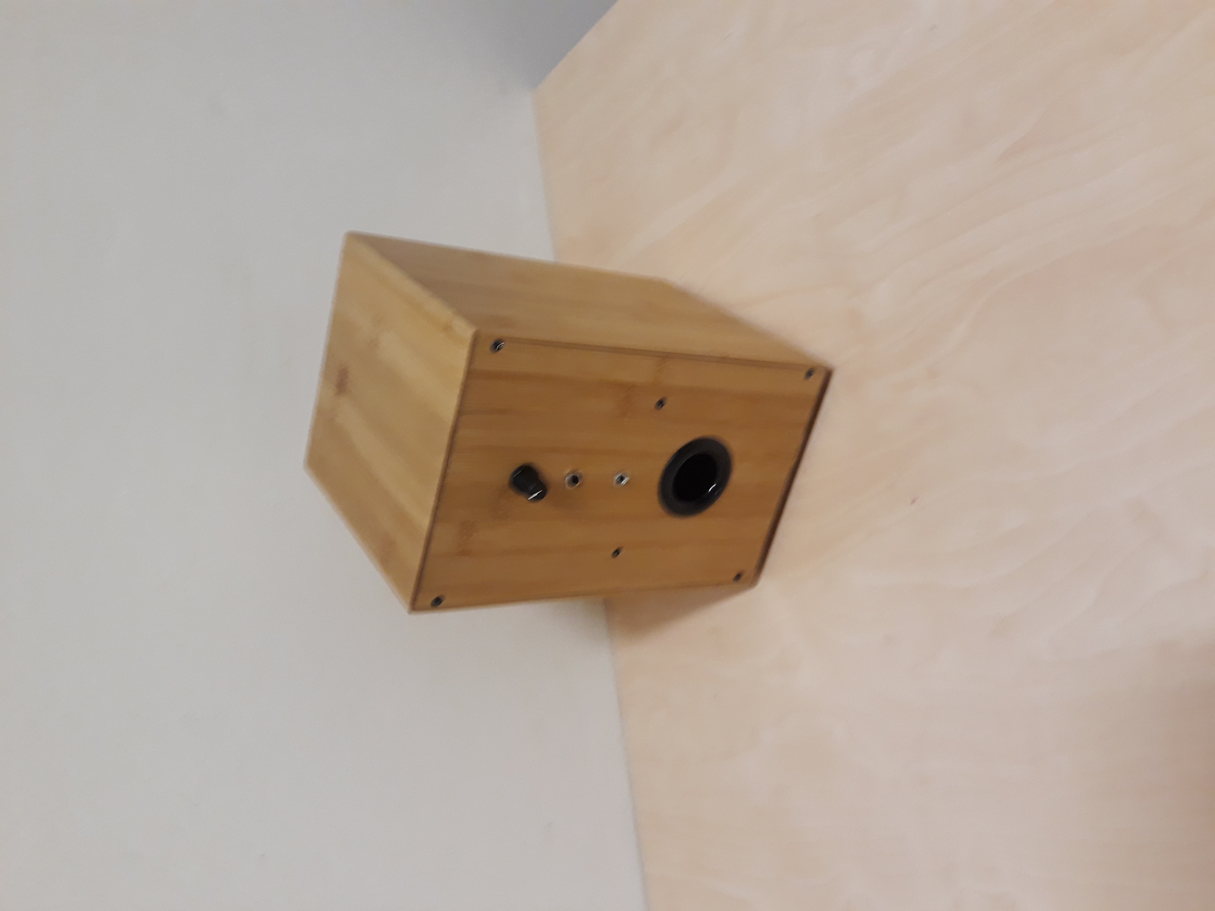

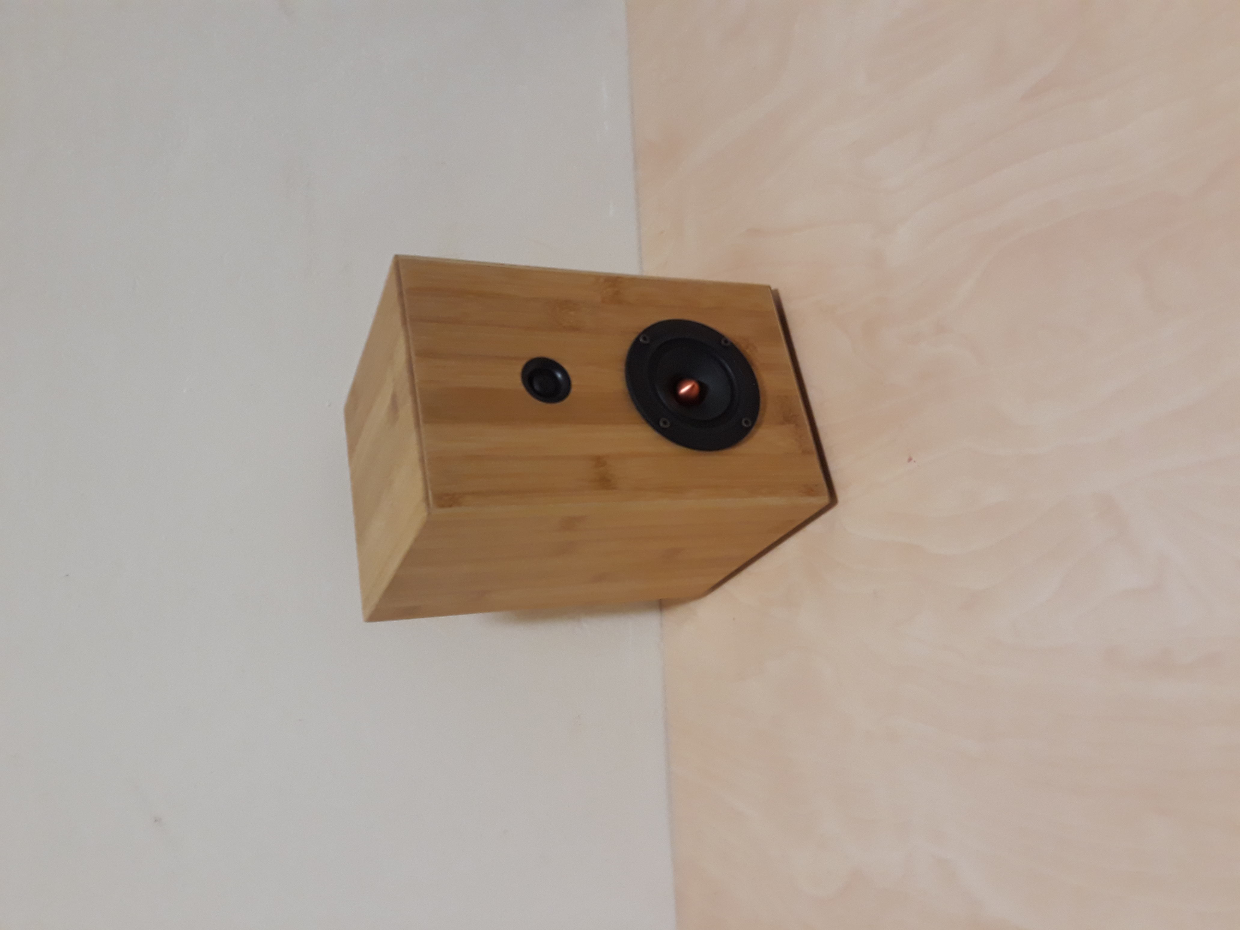

Away from the cali I've been spending time building some bluetooth speakers to listen to tunes and podcasts etc
Some pics;

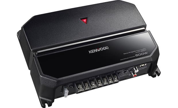

and 2 of these...
and this...
which of course leaves me to remove the headlining again to run handsfree mic & wiring, then fix the sunroof rattle while I'm there, modify the dash to take the HU, run the cables & wiring to 2 x amplifiers located in the boot.

and 2 of these...
and this...

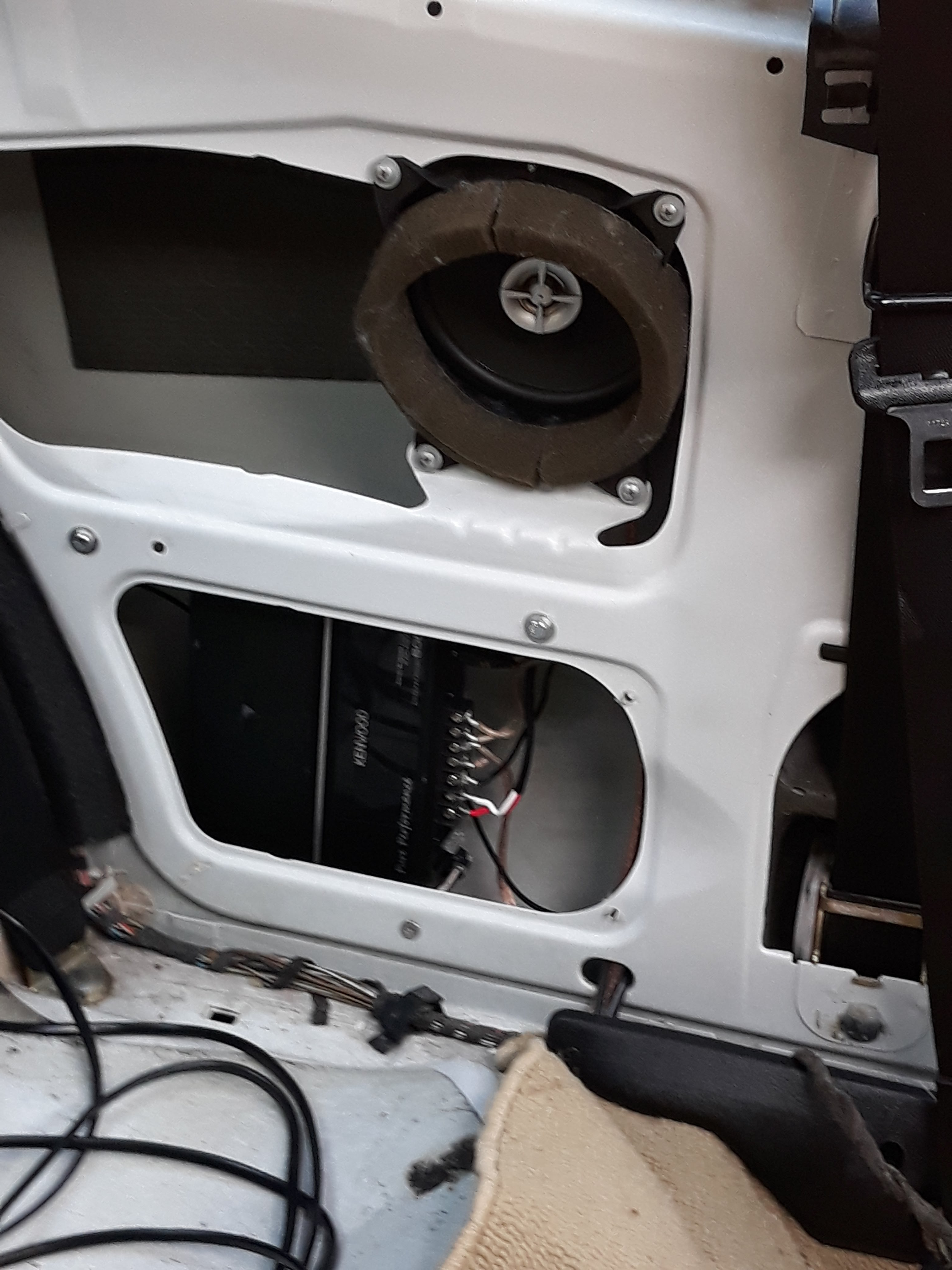

Made a start today. Location of amps changed... happy with how this turned out

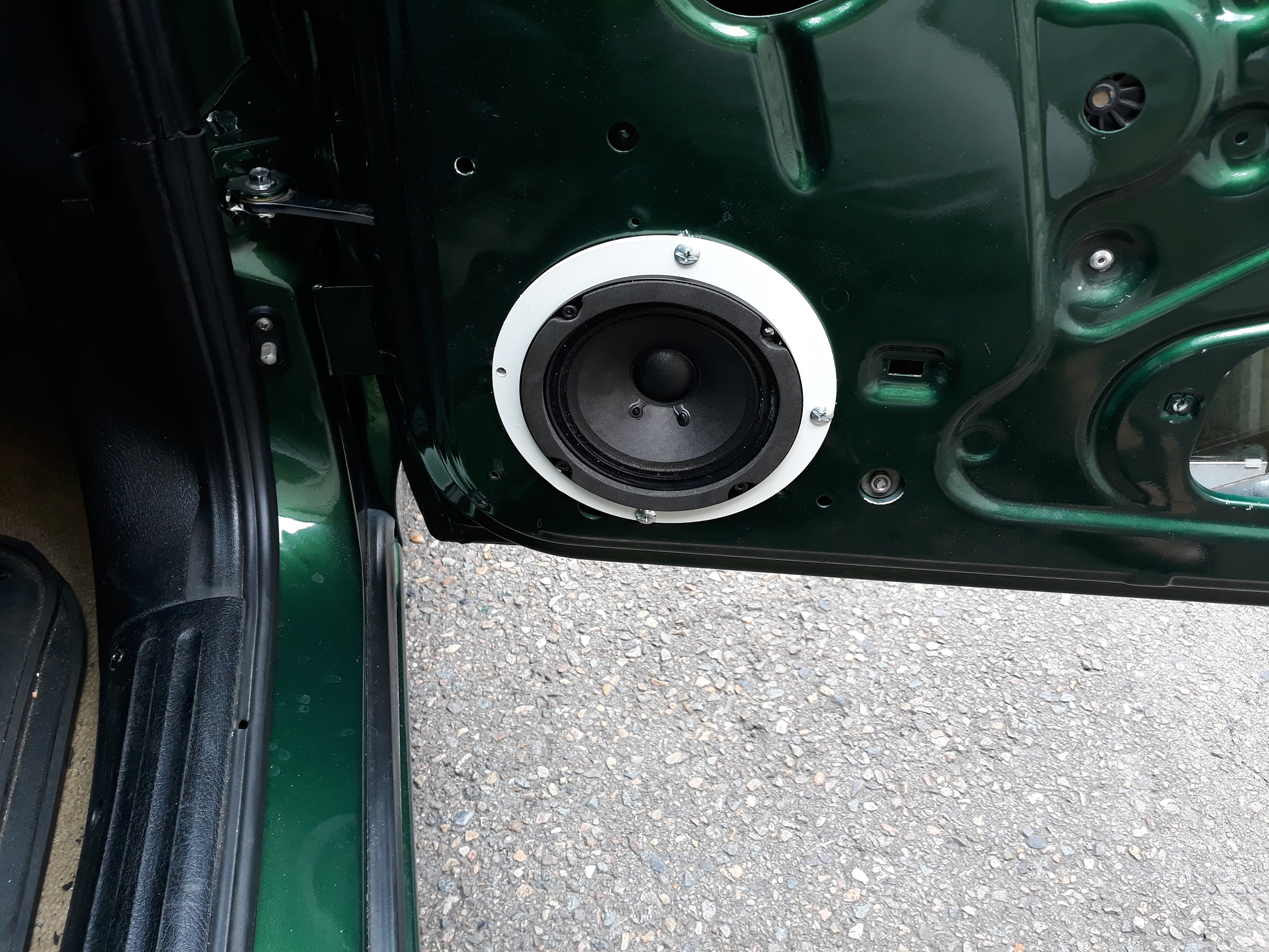

I had a close listen to both the front and rear speakers separately today and tbh I'm wasn't too impressed with either pair. The fronts were absolutely horrible so I've already replaced those with some FR units but these were 5 1/4" and the previous pair were 6 1/2" so had to make some mounting rings up for the smaller drivers...
Just trial fitting atm but look ok, solid and don't foul anything and still lets me use a mid-woofer in the rear and some delicate tweeters up front to compliment this pair.
