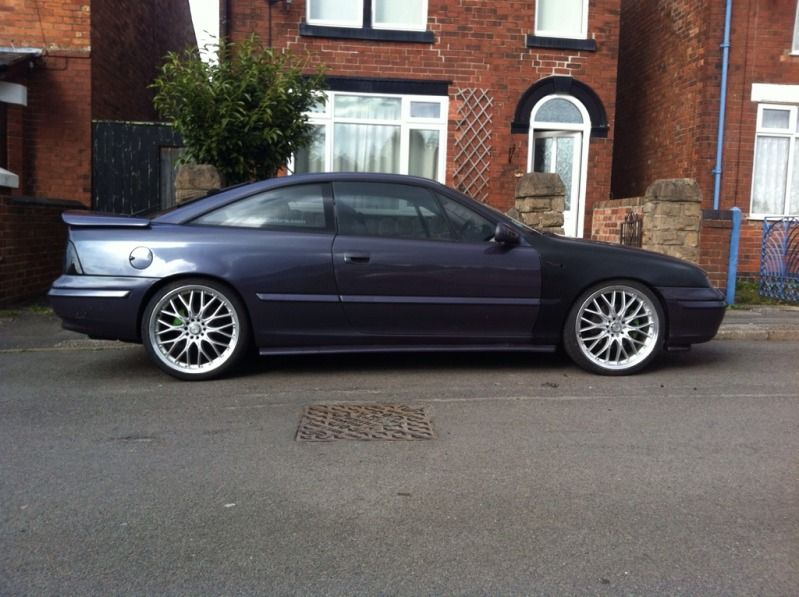

So rolled arch wings fitted and 19"s on ready for the body shop
It turns out the rims were originally Shaza's!!!
I knew I'd get them eventually!

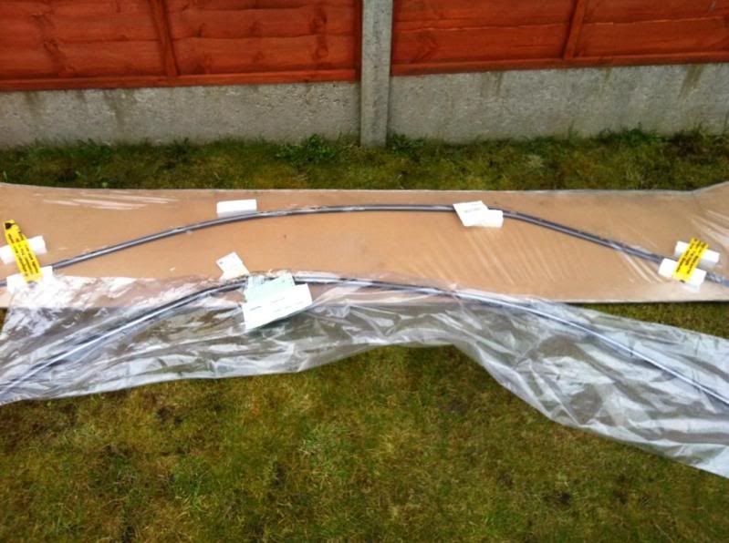

A few new parts to go on
New Rieger kit (front and rear aprons and side skirts)
A full set of upper and lower door seals and weather strips
New side repeaters

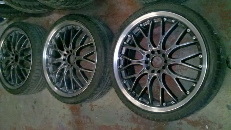

First the wheels got a refurb
Went with a polished lip but gun metal centres
Will live with them but might refurb again to silver

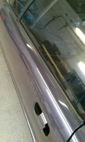

Now the body work starts!!!
The wings came off again to stone guard the voids and the inner side of the outer wings
A few dinks identified
Bonnet off ready for fitting the vents

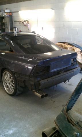

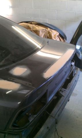

Body Kit fitted
Work starts on attaching aprons and smoothing in
More dinks isolated
