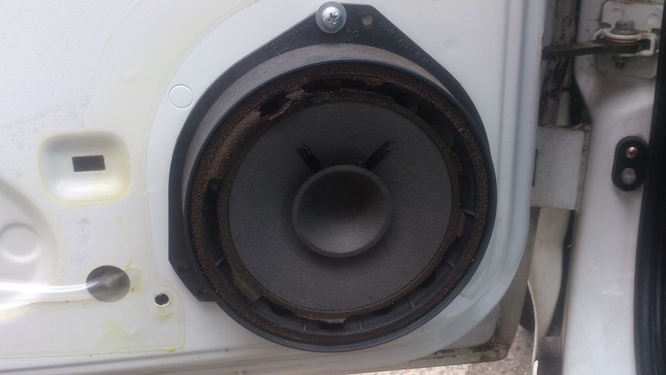

I replaced the Front Door Speakers, as both were BLOWN

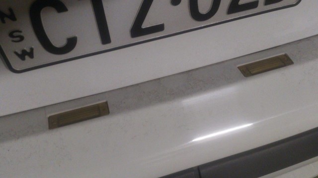

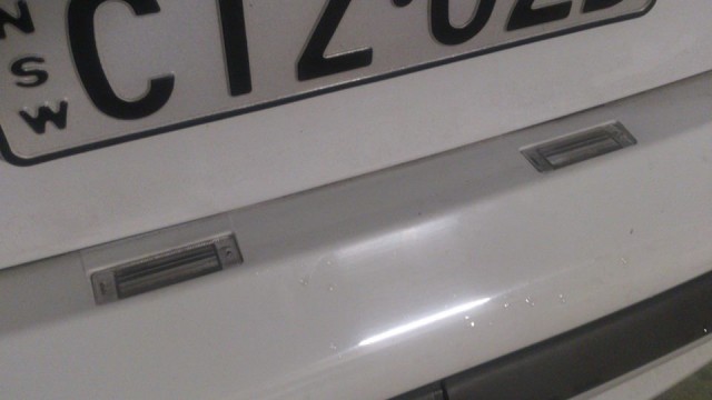

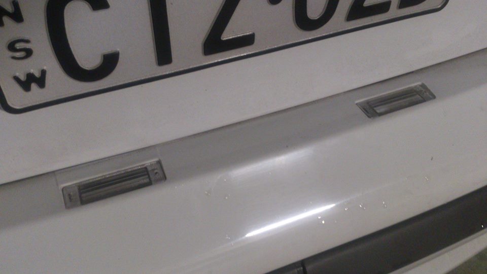

So I finally fitted a Set of NEW Rear Number Plate Lamps...

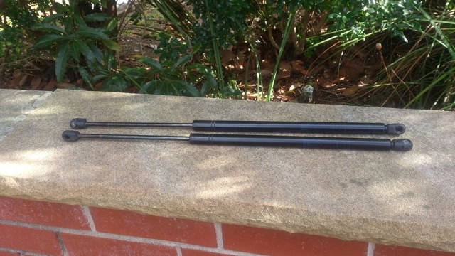

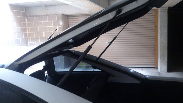

I also replaced the Original Tail Gate Struts, as they were getting worn...

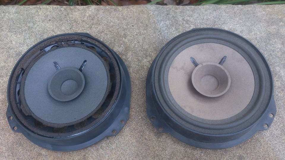

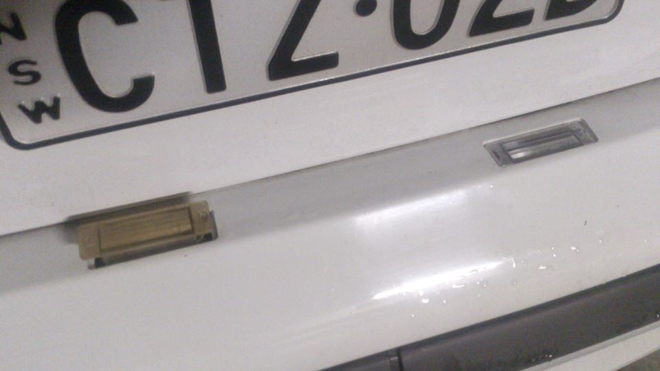

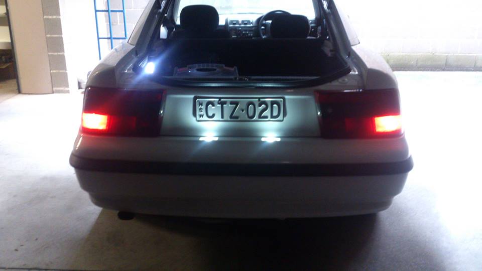

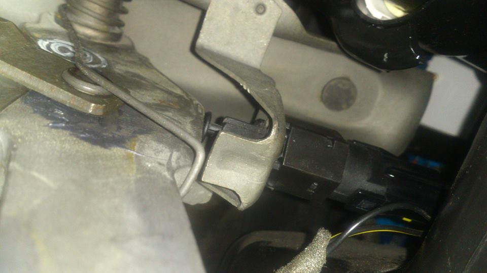

Replaced the Brake Light Switch (Part No: 90 196 375) as my Brake Lights suddenly stopped working...

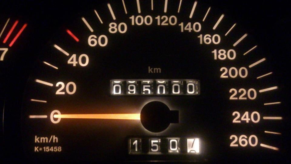

ACTIVITY UPDATE: 30 APR 16 @ 95,000Km
More progress...

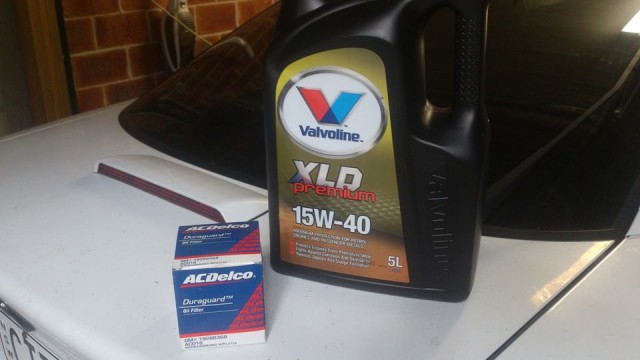

The Stocky got Serviced @ 95,000 Km...
Fitted an AC Delco Oil Filter & used Valvoline 15W-40 Oil - 5 Litres...

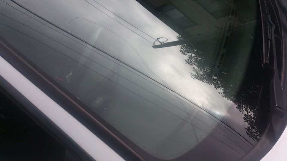

Also, the Crack just got so big, so I finally replaced the Windscreen...
I also added a bottle of Rislone's Injector Cleaner...

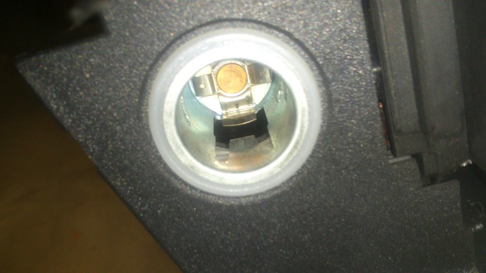

Cigarette Lighter attention, and LED fitted...
ACTIVITY UPDATE: 23 JUN 16 @ 96,450Km
More progress...

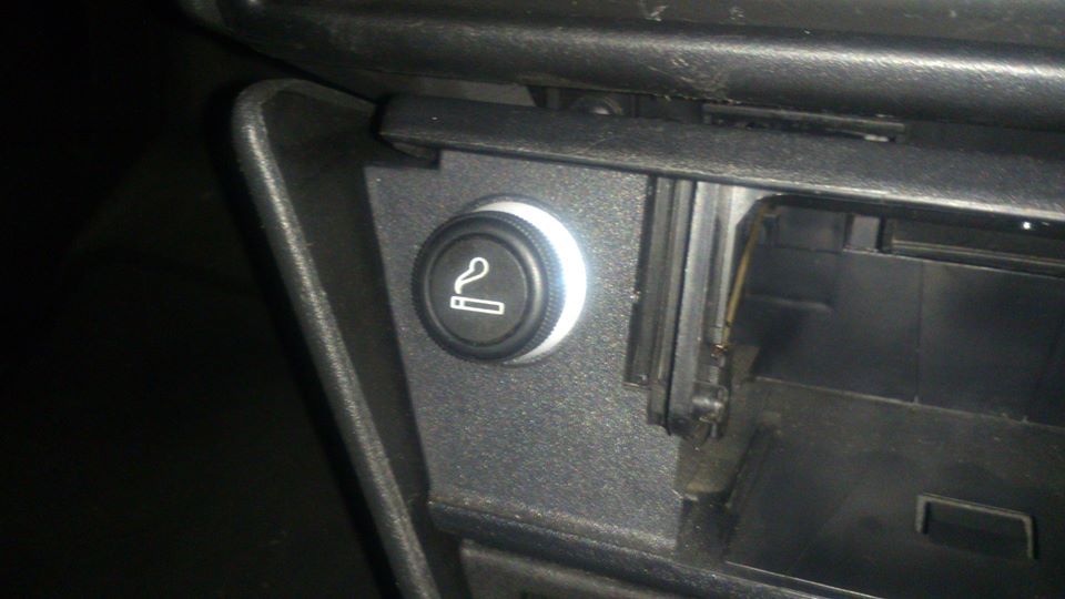

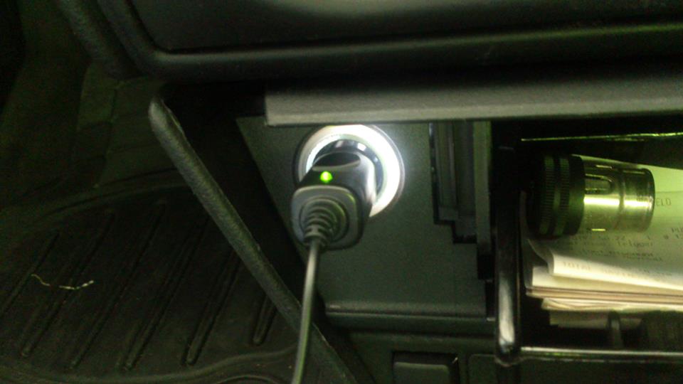

I hated that the cigarette lighter connection was always so loose, so I adjusted the internal prongs, and fitted an LED Bulb...
More progress...

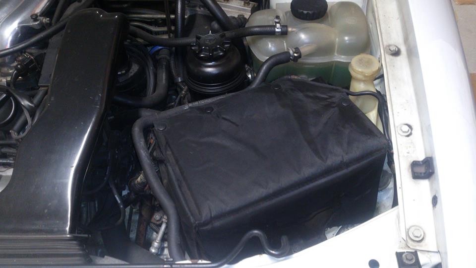

Batteries Swapped...
ACTIVITY UPDATE: 02 JUL 16 @ 96,550Km

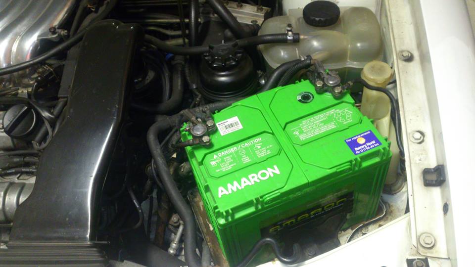

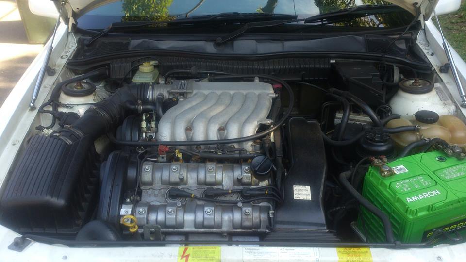

Today I decided to swap over the Batteries, between both of my cars...
Mainly because The Ghost doesn't get driven that much, so to recharge, and for the cosmetic aspects too...
So now The Ghost gets some Colour, in the Engine Bay, whilst The Stocky gets back some Originality...

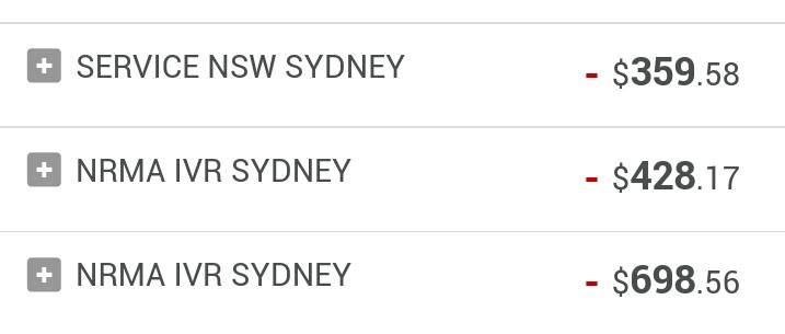

$40.00 - Pink Slip
$359.58 - Rego 12 months
$428.17 - Third Party Ins
$698.56 - Green Slip
TOTAL COSTS: $1526.31

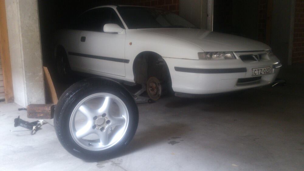

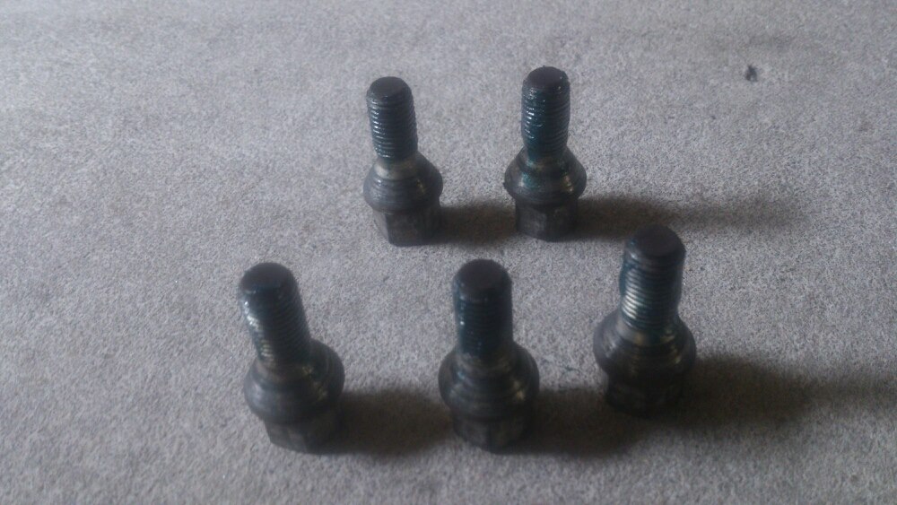

ACTIVITY UPDATE: 05 OCT 15 @ 110,550Km
Front wheels rotated and given a really good clean, even though surprisingly, they weren't that dirty...
Travelled 21,550Km since NEWLY fitted, two years ago... Front wheels bolts lubricated prior to fitting...
I noticed uneven tyre wear Outer Front Left of the tyre... Right side tyre had similar wear, but wasn't as bad...

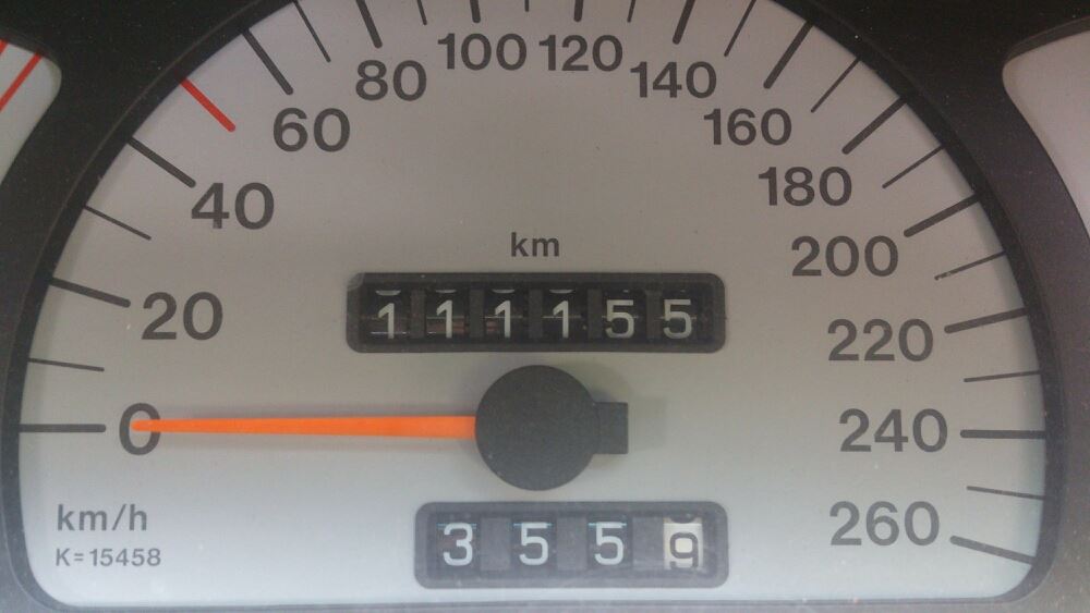

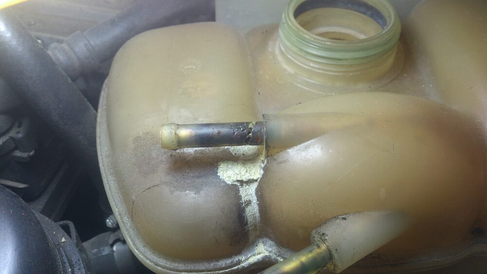

ACTIVITY UPDATE: 31 OCT 17 @ 111,155 Km

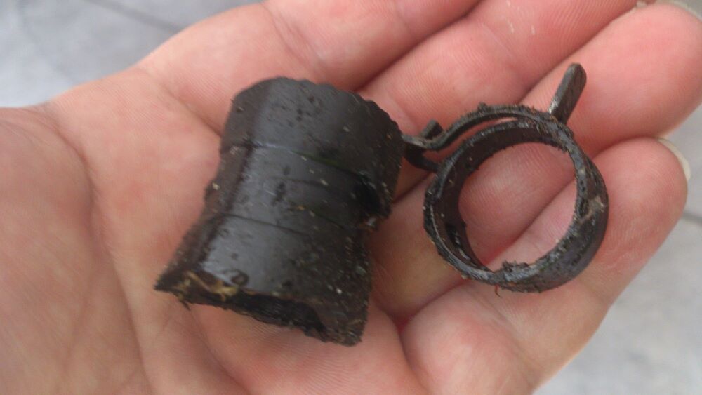

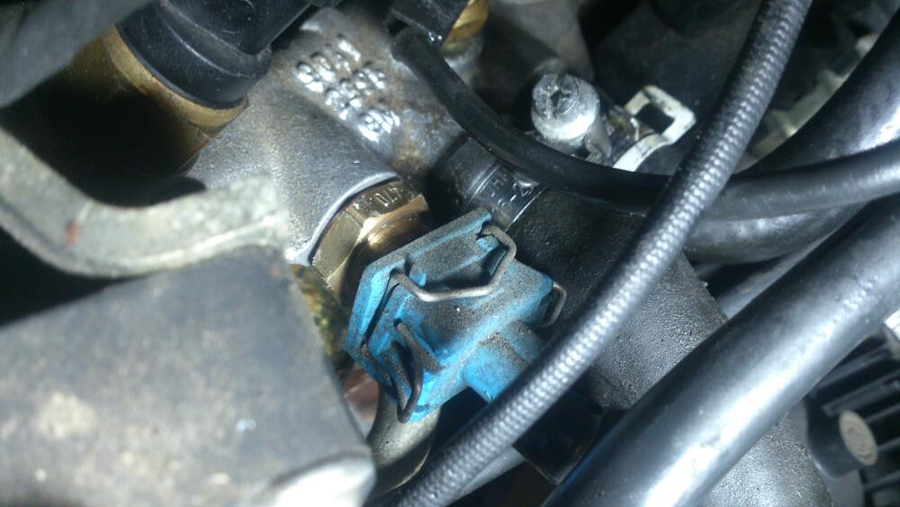

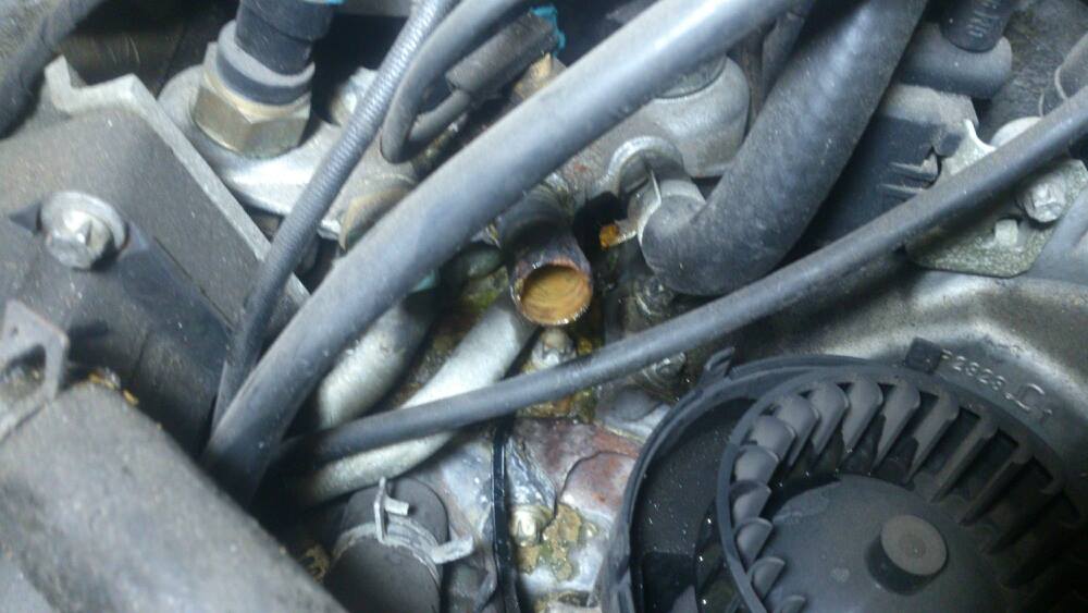

I finally attended to the 2 x minor Coolant Leaks... First one being the Heater Hose, that is connected to the Coolant Bridge...
The leak was caused by the Original hose clamp, so luckily it was close to the edge... I simply cut off 2cm of hose, and re-fitted it, and also used a new hose clamp...

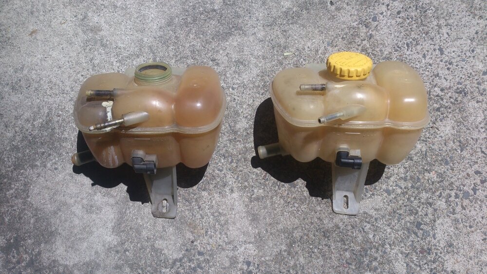

The second leak was located at the Coolant Header Tank, small upper stem... This part was simply replaced, by old stock that I had already in my garage...
I then topped up on coolant, and started the car to observe for any leaks, and monitor the level of coolant in the header tank and cooling system...

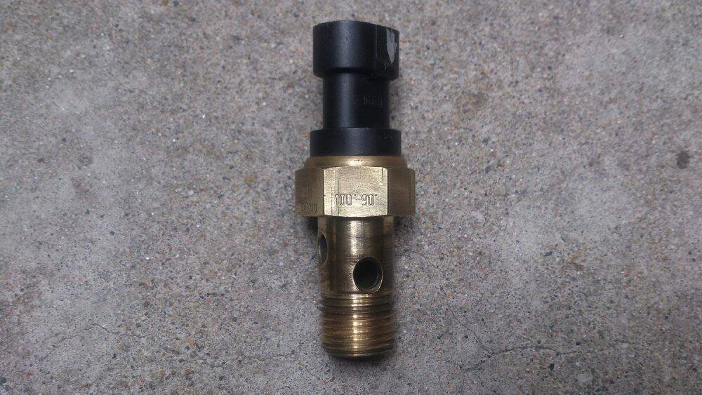

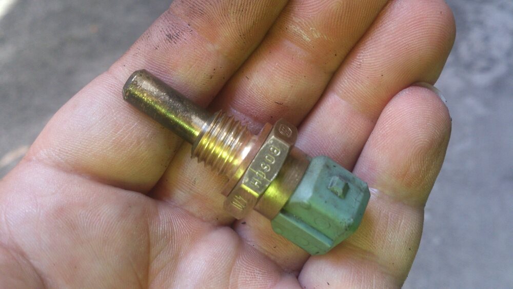

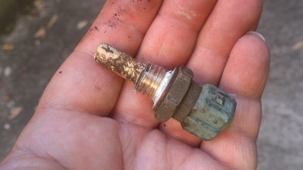

Whilst I had access, I also decided to check the condition of the CTS, and to my surprise, it was shockingly VERY dirty...
So I gave that a much needed clean up, and re-fitted it... Surely a clean CTS can't be a bad thing...

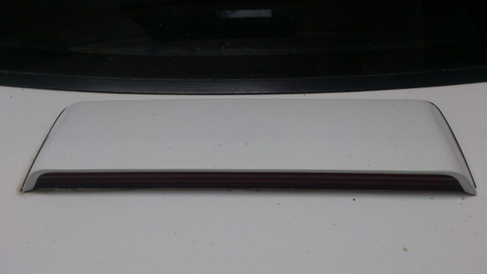

ACTIVITY UPDATE: 04 NOV 17 @ 111,222 Km
Since I recently cleaned the CTS, I thought I'd also give the Alternator Cooling Fan Switch a clean as well...

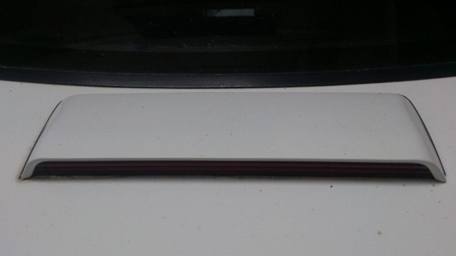

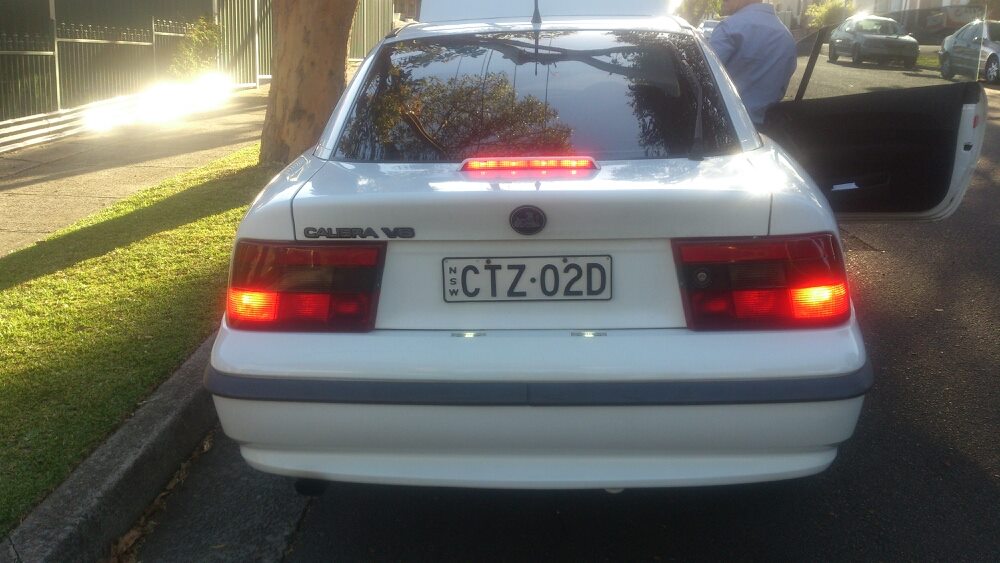

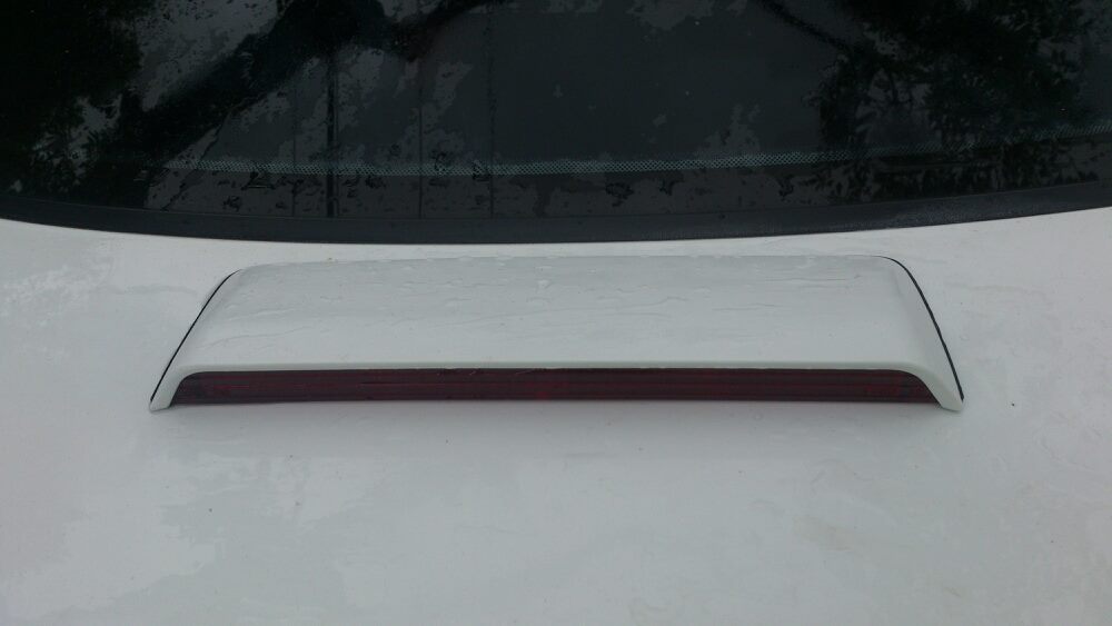

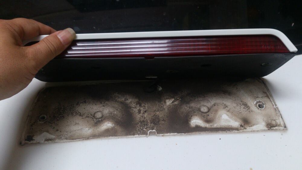

I also fitted 4 x New Bulbs in the Rear Centre Brake Light, as 3 were now blown, so it was time to sort this issue out...
I adjusted the Boot Lid Locking Mechanism, and rubber mounts... I removed the Boot Weight to see if it made much difference,
and although the boot was much lighter to lift up, it required some force to close it properly... So I decided to keep it fitted...
Now when I drop the Boot Lid from 6 inches high, it shuts smoothly, and locks properly... Happy Face...
