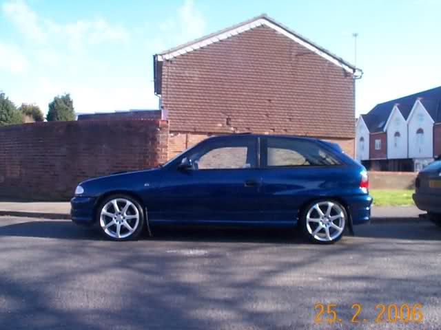

so lets start with a picture of my 1991 Astra GSI!
i bought it back in 2005 and always wanted to C20let her so bought a calibra LE turbo in 2008 but decided to keep the calibra instead but couldnt bring my self to sell the gsi so it was stored down my dads for a year untill my partner needed a car as she had passed her driving test so she was going to have the gsi untill i decided to break the calibra due to excessive rot! so instead of sticking the LET in i wanted to go down the saab route! so picked up a Saab 900 se turbo with rear end damage off ebay for £200

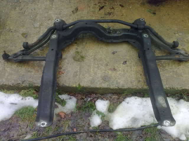

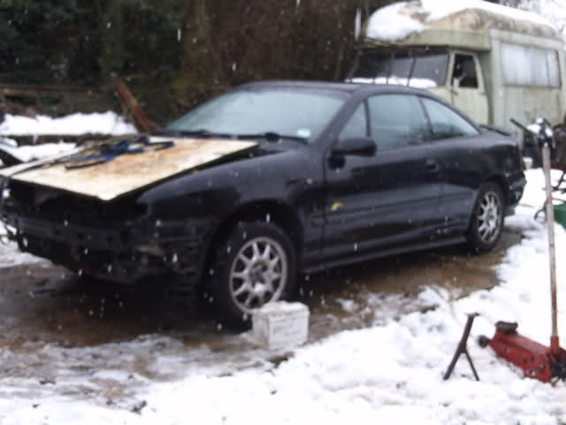

first job of the day was to get the calibras subframe on so i could move it off the tarmac so i could begin removing the saabs engine!
so subframe back on the calibra sporting some lovely saab alloys

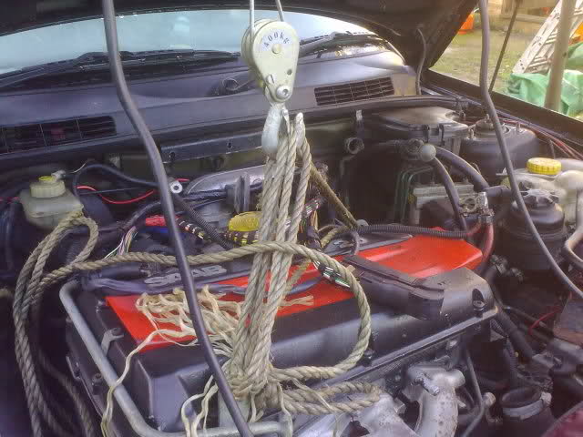

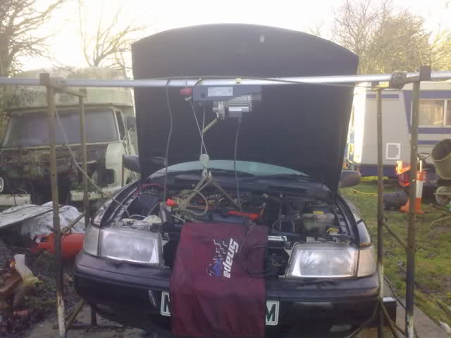

i have started removing the engine and hope to have both the saab and the astras engines out by the end of this week!
i also plan to convert to 5 stud by using the saab front legs and rear axle and may try an use the saab instrument panel to!

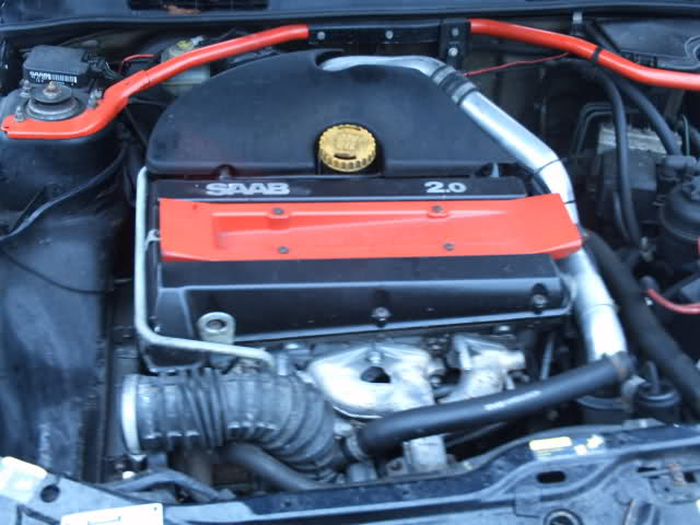

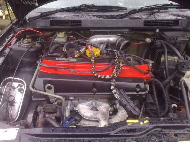

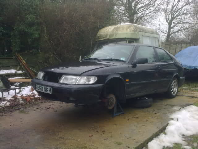

just a shot of the saabs engine bay!

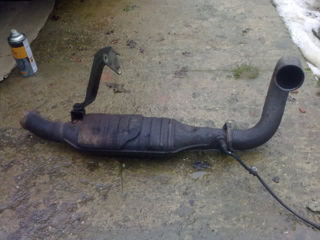

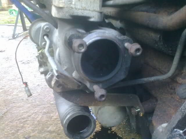

so with the interior out i jacked up the front and removed the turbo down pipe which has the cat' convertor built in, i will cut out the cat and weld in a straight piece of pipe and a flange to connect to the astras custom stainless system!

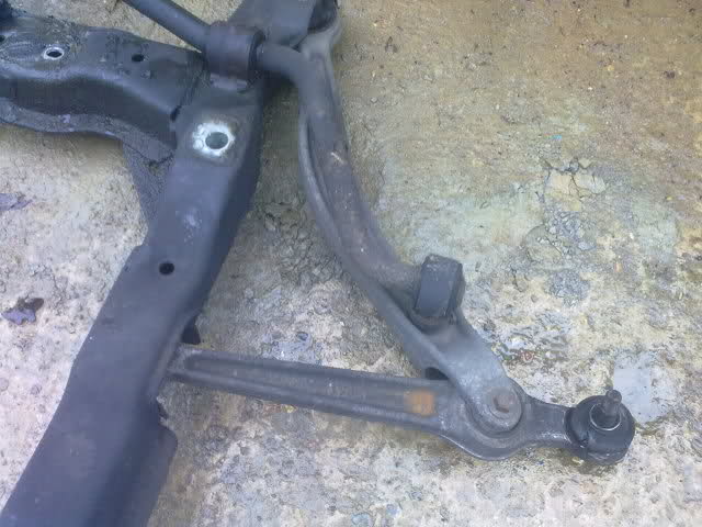

i could use the saab subframe if i swapped off the lower arms but i dont see any advantages in doing this as the saab and the astras subframes are the same so i'll just stick to the astra one!
close up of the lower arms!

so engine all ready to drop!

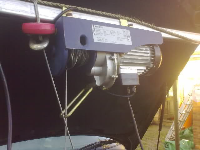

as this is the 4th engine i've had out down my dads i really should invest in a engine crane, due to having no crane i have been using a hoist that is meant be be attached to the roof, i just have it on a bit of 2x2" square tube straped to some scafolding frames! works quite well, i normally drop the engine out the bottom them attach the hosit to the front off the car and lift the car up and drag the engine out!

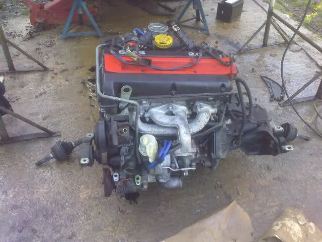

one saab engine out
this is one heavy engine, me and my dad strugled to pull it out from under the car!

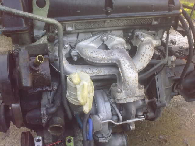

some ramdon photos of the engine

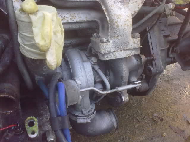

a lovely T25 garett turbo

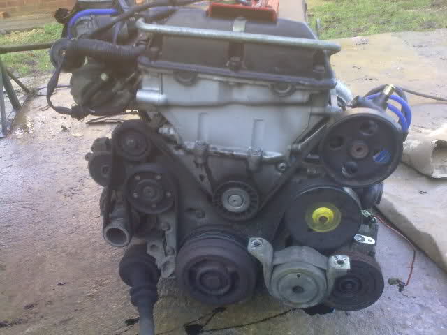

aux belt pulley set up,saab engine has a chain driven timing system
will be loosing the a/c pump

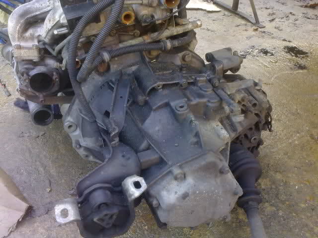

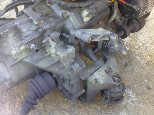

saab gear box

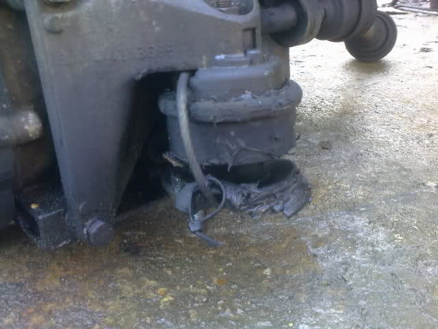

knackard rear gear box mount due to being covered in oil from the leak!
saab want £130 for one so i think i'll get one on ebay for £30 lol
one saab engine out

saab gear box

with the engine now out, before going full steam ahead i wanted to swap all the required parts over to fit the new engine so to day i started with the saab radiator
front end removed from the saab
bumper off the astra
drilled out the spot welds from the cross member and removed along with the astra oil cooler
saab radiator in, god it was tight, took me ages to get it where i wanted it so i had enough room for the intercooler pipe work!
to keep cost down as i need this on the road asap i am using the standard saab intercooler untill i can afford a nice shinny one
so radiator and intercooler fitted along with pas pipes, i need to get custom hoses made up from the saab oil cooler and tidy up the wiring harness then modifiy the gsi bumper ( keeping the standard look) so i can go back on!
swapped the throttle cable over as the saab has a different fixing for the throttle body and swapped the heater pipes around!
so with the engine ready to go in i replace the rear crank seal and refitted the gearbox, alternator and aux belt and removed the air con pump!
the day was getting on and had the get the missus from work at 5 so i just replaced all the vaccum pipes as the old ones were all soft!
so next saturday the engine will be going in and i will have a new camera so promise i will have better photos!

while the gearbox was off i took it to work and gave it a good clean and a lick of paint!
replacment rear mount fitted!
next on the list was S**t scary, i drilled out the 8 debugging pins on the ecu and soldered in the pins which will allow me to remap the ecu on my home pc!
that was all i could do in my lunch breaks in the week.
so yesterday i removed the engine from the astra.
