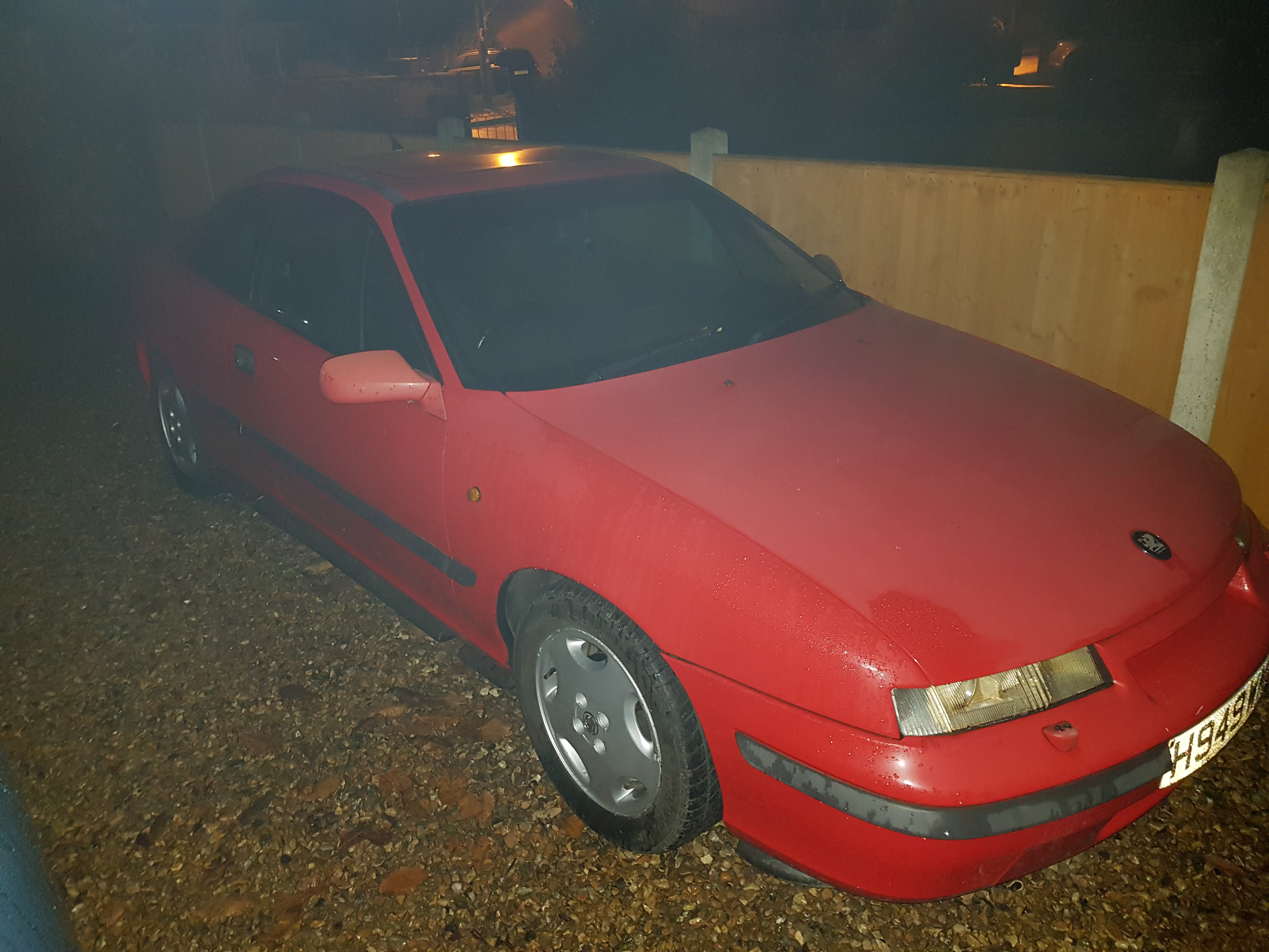

Back in 1994 my neighbour purchased this H reg calibra for some £5000 in 2hich time it was used occasionally covering very small mileage . For the past 5 years or so it sat on his driveway going more and more pink and gathering mould and not a week went past where I didn't ask if he wanted to sell it . Finally ! Just before Christmas he did ! For the sum of £250 a set of alloys and my ford puma lol

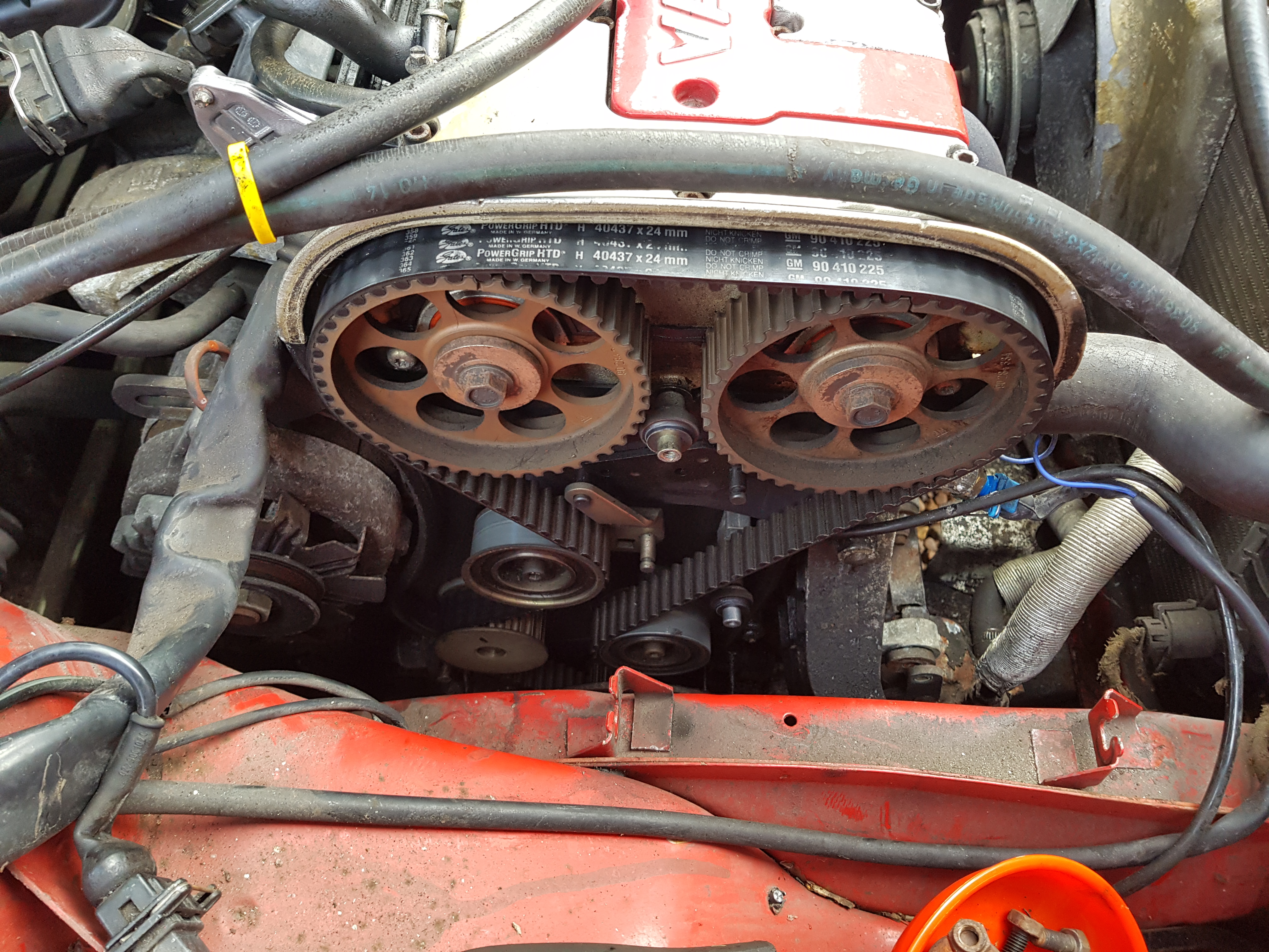

And with a fresh ticket there she sat for a month until I gathered some parts , time and , money . Sorted the heater which didn't work at all ( resistor ) and run it up as much as I could to get decent fuel through it I then proceeded to change the cambelt kit . Water pump . Thermostat and the aux belts aswell

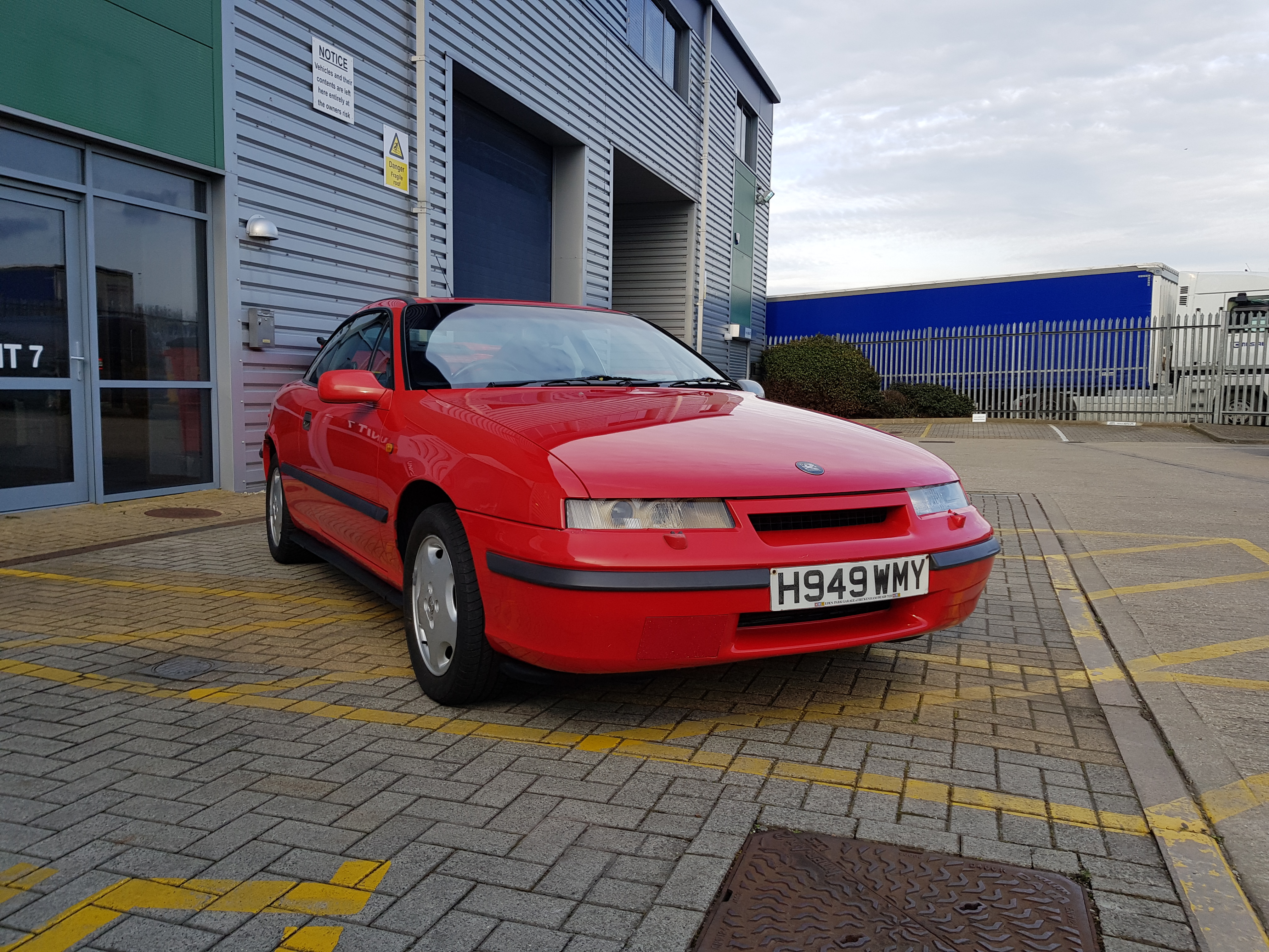

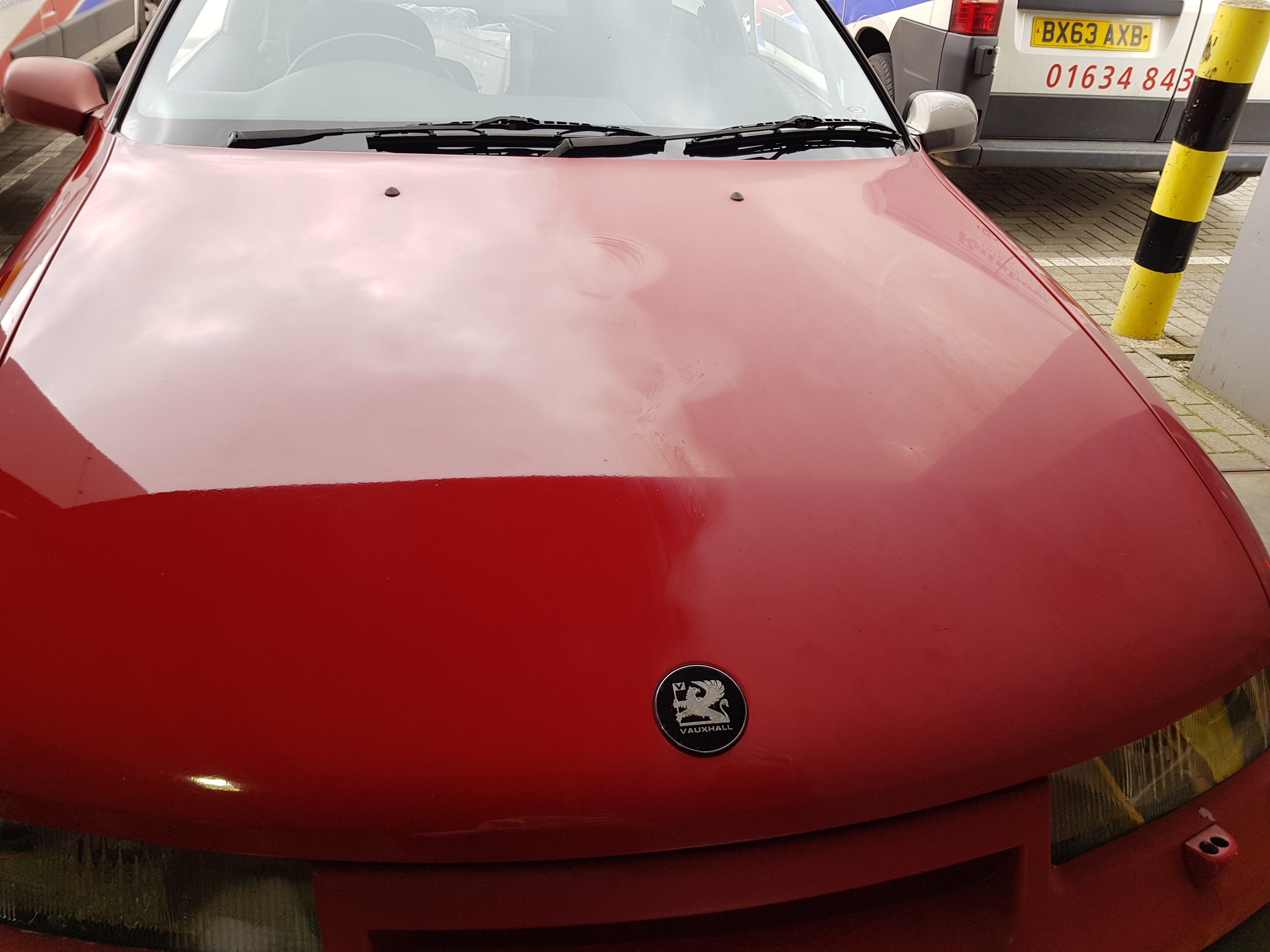

I decided to tax it and temp insure it and drove it for the first time in months and she drove like a dream . A very pink and dirty one lol . I got it to my work and then hit it with TFR and the jet wash then came the mopping and polish
