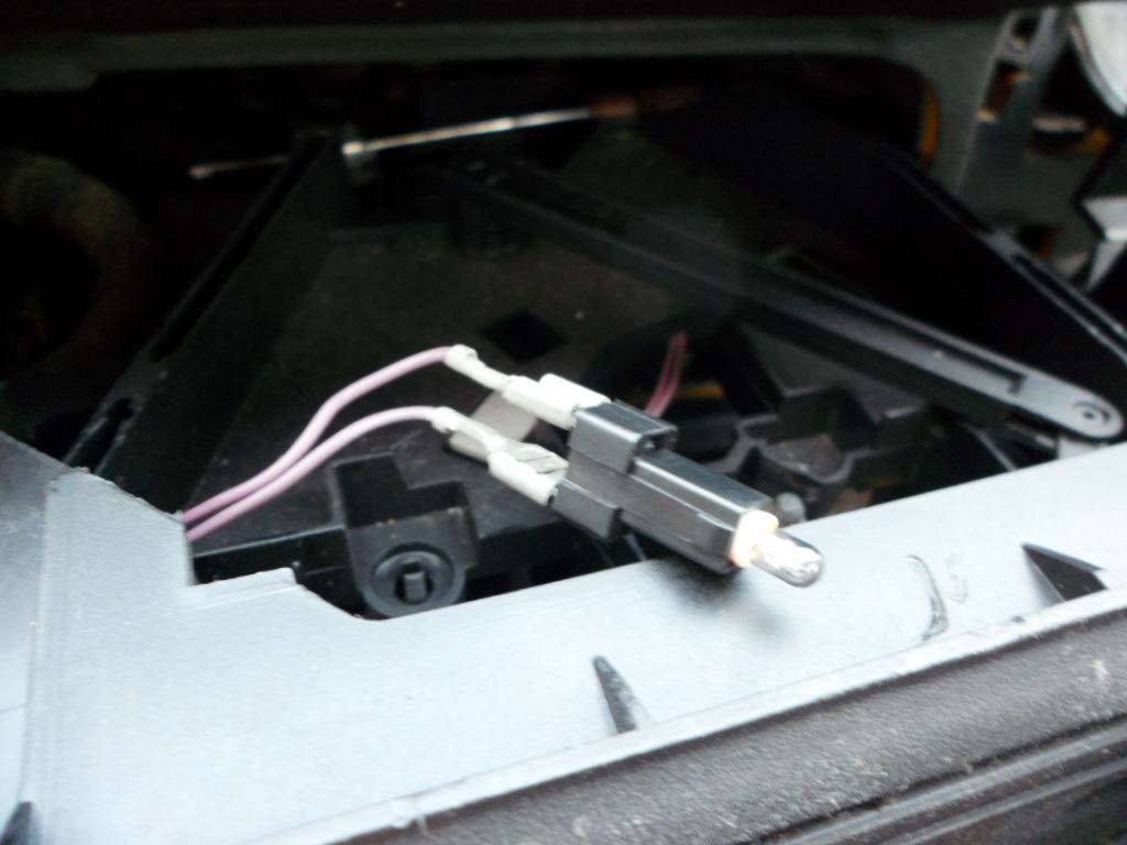

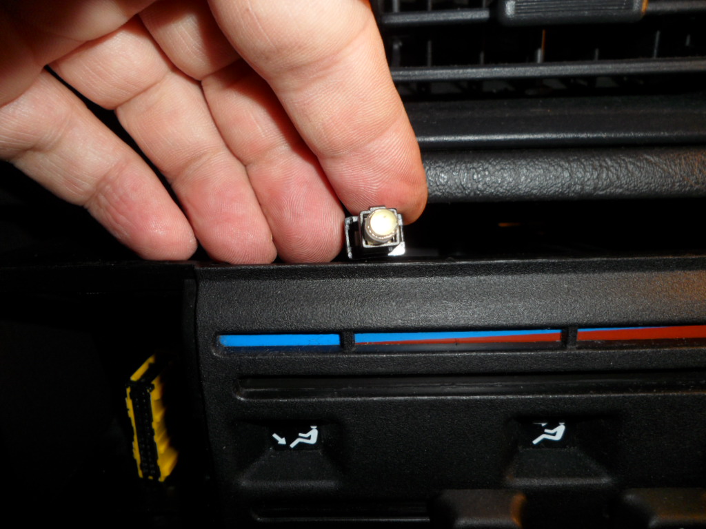

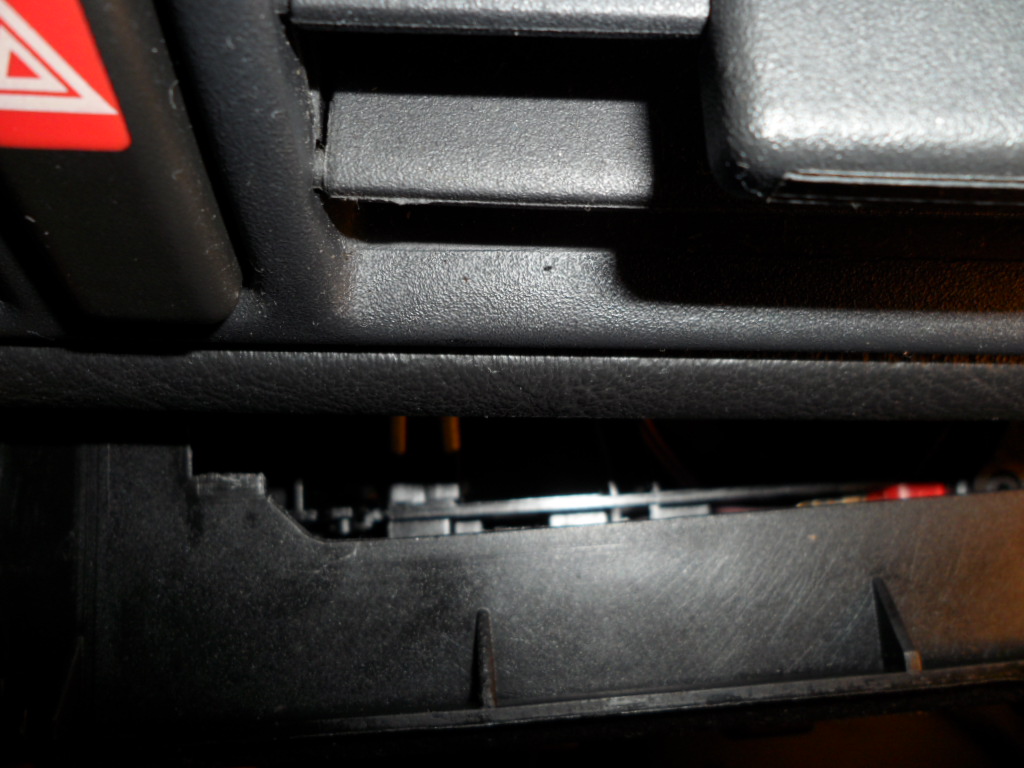

Re: Heater Control Panel
by EddeyDancer » Tue Nov 06, 2012 2:53 pm
I also fitted an LED Bulb in the 'Heater Control Panel' recently...
It's NOT as difficult a job, as I was expecting it to be...
So anyway, here's some more photo's of this Job...

by MadOnVaux! » Sun Nov 11, 2012 5:50 pm
What LED bulb is it for the panel?
by Fraz » Sun Nov 11, 2012 6:11 pm
509 type
if your wanting the one I used there is a link page 1
by MadOnVaux! » Mon Nov 12, 2012 4:54 pm
Fraz wrote:509 type
Cheers Fraz....i missed the link sorry.
Thats a good bulb with the 3 LED's, rather than some i've seen with one LED so you end up with the brightness centered in one spot.
