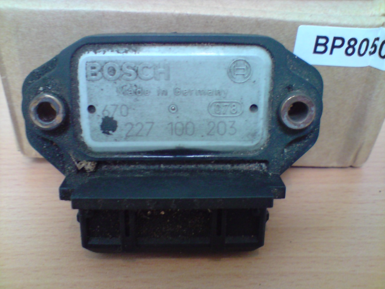

Ok, had a look in the area of the battery and just can't see what is supposed to be the amplifier. Can someone please provide some direct guidance, description of the amp and if possible a photo of the amp either in situ or out so i can at least see what I'm looking for?

by RobbieV » Thu Aug 14, 2008 7:02 pm
Ive been told that you can locate it underneath the battery tray.
Posts: 2357
by sinbrad » Thu Aug 14, 2008 7:40 pm
Actually underneath? How are you to get at it? What does it look like?
Posts: 449
Joined: Wed Oct 19, 2005 12:00 pm
Location: Arbroath
by Fraz » Thu Aug 14, 2008 10:17 pm
couple of pics here...about half way down, post by Cornishtaz
http://www.clubcalibra.net/viewtopic.ph ... eb8b93489b
by sinbrad » Fri Aug 15, 2008 10:26 am
Cheers for that Fraz. Went out hunting after I posted my last post and whipped this out as it was the only thing that I could see?? Lo and behold it matches. Now to get hold of another one to see if it's the problem causer?

by cornishtaz » Fri Aug 15, 2008 10:58 am
Try your local scrappie to see if there are any V6's in or try ebay

by sinbrad » Fri Aug 15, 2008 11:33 am
Been on the phone to local scrappie and they only have vectra v6 so hopefully they'll be the same. Also emailed a couple of sellers on ebay and two got back, one that will sell ecu, coil and amp to me and the other, the one you linked to, has the coil pack and will try and locate the amp. Off to the scrappie in mo so will see what happens?

by cornishtaz » Fri Aug 15, 2008 11:54 am
Just checked EPC and it appears that the Vectra doesn't have the amplifier,as it's the X25XE and possible different management system, still worth a trip as the Cav v6 will be the same
cornishtaz
by Fraz » Fri Aug 15, 2008 12:31 pm
you might just have to get an aftermarket one (non Bosch) intermotor should do one ..or try a local Auto electrician, they should source one
oh and its also used on
Alfa 164 3.0 V6...
FERRARI 456 GT 2+2 2,5...
Volvo-960,S90... 3.0,125-150KW
