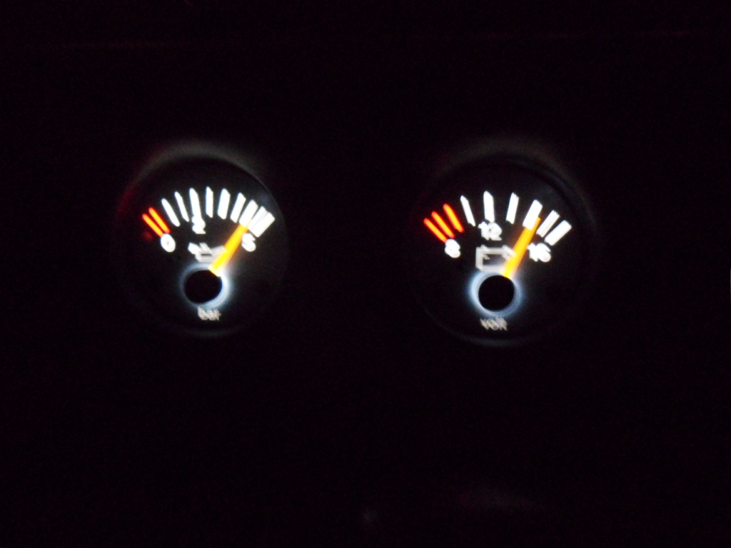

I've tried Blue, Red and White LED's in the Dash...
White was easily My preferred choice, as the other colours had Negative effects on the display...
Soon I'll Post up the Pics that I took, of the Red and Blue LED's and their impact on the display...

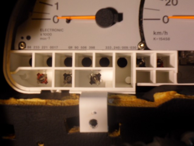

Apart from putting LED's in the Dash Dials...
I also put a few LED's in the 'Most Commonly Used' sections, so that I won't have to change them later on!
For some reason the Air Bag, TC and ABS lights stayed on for Me, when I fitted LED bulbs in them sections!
So I put the Standard Bulbs back in, and they were working normal again...

by EddeyDancer » Sat Dec 03, 2011 7:45 am
LED's in INSTRUMENT PANEL SECTIONS
I also suggest to use Coloured LED's for example...
GREEN: for Indicator Section
BLUE: for High Beam Section
YELLOW: For EML and 'S' Sections
RED: For Handbrake, Oil & Low Fuel Sections
NOTE: ABS, TC & Air Bag Sections didn't like the LED's in them...
Perhaps the Bulb wasn't suitable, but I did try are few in there! :think:
