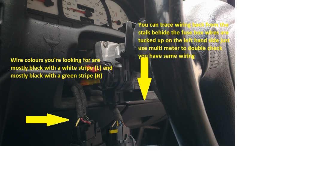

Yes it can - copied from above : you can find the indicator wiring in the car without going to the engine bay though not at the locking ECU (I don't believe). Wire colours you're looking for are mostly black with a white stripe (L) and mostly black with a green stripe (R) - should be relatively easy to locate from the shroud around the steering wheel and the loom running down from there. Connect one brown to one, the other to the other. Hope that helps!

Possibly, haven't done it that way myself - would have thought the wiring might be a challenge to get access to but you can of course locate it in the loom (not sure which side). I don't have the wiring diagrams to hand so can't confirm which colour you'd need to tap into.

You are right, it is impossible to connect to the indicator wiring from behind the hazard warning switch - the wiring is completely hidden by the dashboard moulding behind the switch. As suggested I have removed the plastic casing behind the steering. I can see the wiring connecting to the indicator switch, are plugs used to make the connection or are they hard wired. I have tried pulling the what looks like a plug off the switch but it will not move. I do not want to pull too hard in case I break something.
How did you get access to the indicator wiring.

The switches do come off but I don't think that will help you, better to separate the loom running down the column and find the colours needed then splice your connections in. Maybe Daz can recommend/suggest an alternative though.
Re: Remote Central Locking conversion.
if you unscrew your fuse box in the drivers foot well and let it hang down you should be able to see the rear of the steering column if you look up be hide the dash the bit of loom you are looking for is tucked up on top left corner should be able to follow the loom back to the stalk to be sure it correct part of the loom you are about to cut into to get good access i was lying on my back in the foot well lol which is something i do not recommend if you have a bad back but it did make the job easier i hope this helps pinner man

I am very very pleased to say that I have completed the remote locking system on the car - including flashing indicators when the system locks and unlocks. To access the indicator wires I removed the plastic covers around the base of the steering wheel. I was then able to get to the connectors on the rear of the indicator switch and splice into the Black/white and Black/green wires, I also removed the fuse box cover in order to route the wiring to the Remote control unit. All that now remains is that I have to put all the panels back in place and tidy up the cabling. I would like to thank everyone for their help. I could not have worked out the wiring systems and identified the correct wires to connect to without the help. Thanks a lot, a great advantage to be a member of the Club-Calibra.
