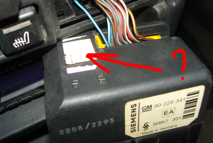

on the back of the comp you'll see a white/yellow plastic chip that has to match the engine in your car or it has to be reprogrammed with a tech 1

by Chipa » Tue Jun 15, 2010 4:56 pm
v6 steve,
do you mean this?

Re: Calibra BC- Doesn't fully work
by Fraz » Tue Jun 15, 2010 5:53 pm
yes that is the chip in the BC
and your code 36 is for 20NE/SEJ, 20SE/SEJ, C20NE/SE Motronic ML4.1
so your readings wil be well out
