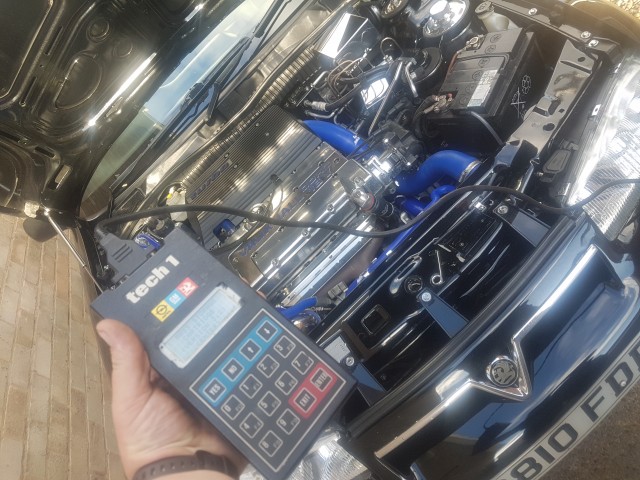

Got up this morning and went to take the car to pistons in the park but she refused point blank to start. Luckily Mr armstrong had his tech 1 with him and was kind enough to lend it to me. When plugging it in I got 2 error codes the first was mass air flow fault the second was immobilizer code 145. I cleared them both but the immobilizer one went for immobilizer code 145 to immobilizer 144 and the car still will not start. Anyone know what is the best route from here on in is as I'm sh1t with electrics

Now managed to get all codes removed and nothing showing but still no joy I have given up on it for the night and took the battery off going to see if the "man reboot" (removing the battery blowing on it and reconnecting the battery ) will work
