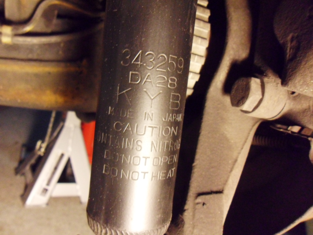

When You do decide to fit them, it's not necessary to remove the rear wheels...
That's if You can jack the car high enough, to get Your arm in and depress the shock enough to fit the sleeve...
That would save You heaps of time and effort, for such a simple job... ;)
Metal Sleeve Part Number: 90 334 270
Hopefully it solves Your rattle issues as well...

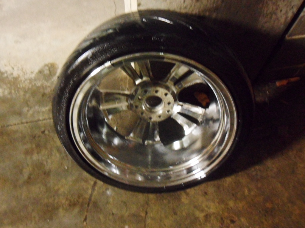

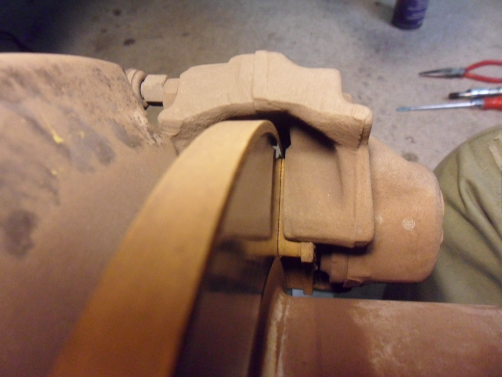

I only took the rear wheels off, as I wanted to inspect the ABS Rings, Brake Pad levels and wash the wheels! ;)
