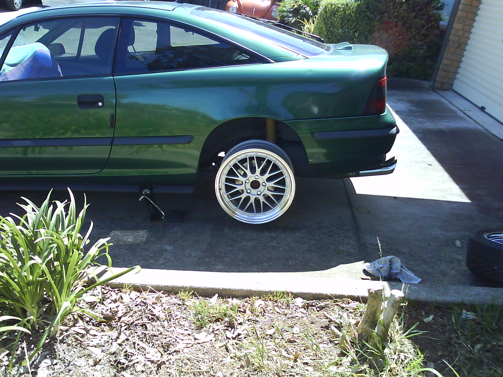

by BMJ » Sat Nov 17, 2012 3:57 pm
Hi Guys,
Below a photo with the test fit. I took out the old trust vernier caliper to measure up all the gaps and it will be OK with an ET45. The wheels have an ET of 42, but i have some four 3mm and four 5mm shims coming in to set that straight.
Posts: 148
