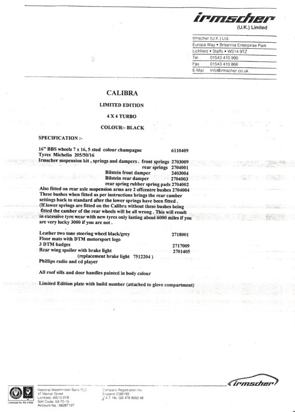

How's your Turbo LE coming along, Thomas?
Here's the Irmscher spec sheet confirming those part numbers:
Turbo LE Irmscher Parts.jpg (85.81 KiB) Viewed 11674 times
Making some progress. The shell is ready for dipping and e-coating. This weekend I've modified the front bumper and bracket to accept the front intercooler. I removed the large towing flap and have replaced it with a cover from a vectra and a vectra towing point on the shell. i really must start my own resto thread.
