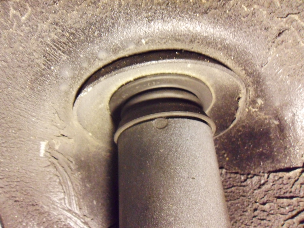

I've been hearing rattle sounds towards the rear...
It sounds like there is something is loose, back there!!! :evil:
At first I suspected that it might be movement, due to worn Rear Axel Bushes!
They were inspected, and were surprisingly found to be still in great condition... :shock:
So while I had the rear inner trims removed, I conducted a Test...
Click on the Photo to view the Video! ;)

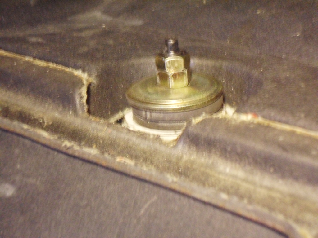

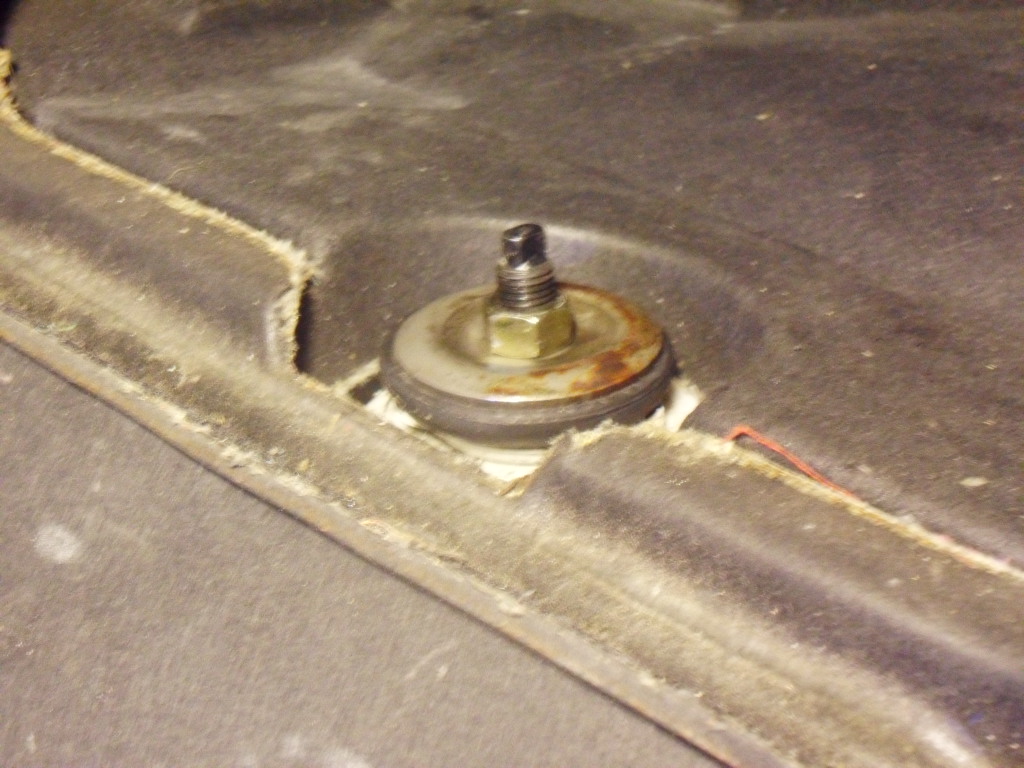

by EddeyDancer » Thu Dec 01, 2011 5:59 am
Mark1 wrote:Have you check the shocks?
I tightened up them Top Nuts, and the Rattle Sounds reduced greatly...
Whilst driving with a person in the back seat, there was NO rattle sounds at all!
So I'm thinking that it must have something to do with, the Rear Shock Bushing or Mounts!

by EddeyDancer » Mon Dec 05, 2011 1:17 am
MadOnVaux! wrote:Sorry, but what am i looking at in the video?
I too have rattling from the rear end on mine... oddly just seemed to start after i had 4 new shockers fitted...
Mate... The Video is more about listening, rather than watching...
Before I made this video, I placed my fingers on the top nuts and felt the slight movement with each rattle...
I'm going to check the bottom mounts for wear, but the rattle decreased when the nuts were tightened!!!
So I'm thinking that they are most likely, to be the cause!!!

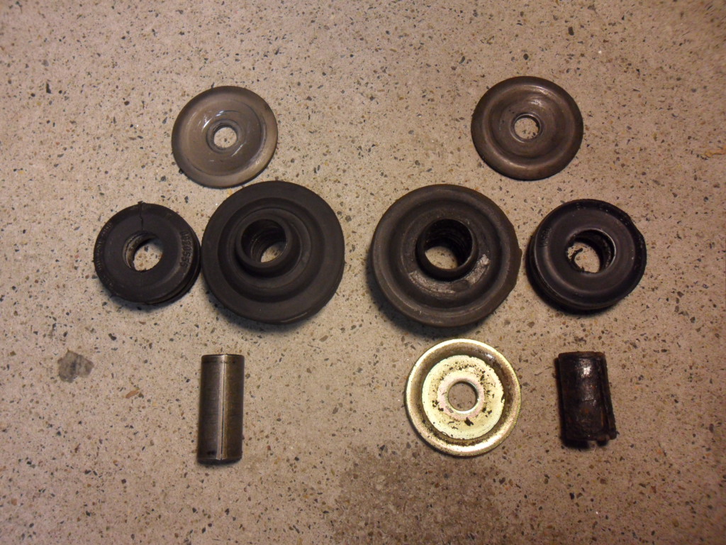

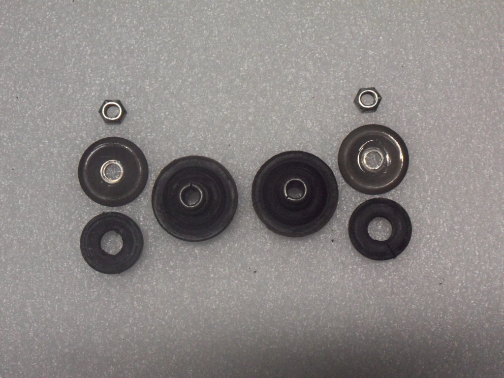

by EddeyDancer » Wed Dec 07, 2011 8:14 pm
I got these Rear Shocks Bushes off a Barina/Corsa...
The bottom Section is like a smaller version of the Donut 'Rear Axel Bush'
I'll try these out soon, and see if the rattle sounds persist!!! :think:

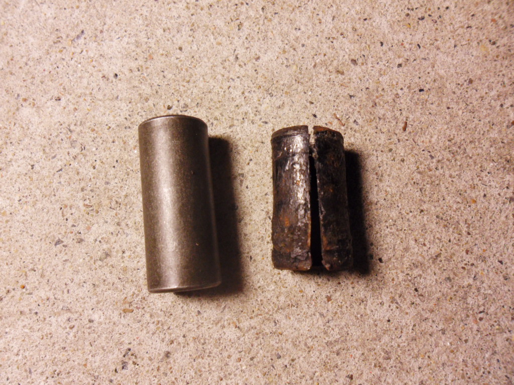

by EddeyDancer » Sat Dec 17, 2011 2:55 am
MadOnVaux! wrote:any update Eddey?
YES... I FINALLY SILENCED THAT ANNOYING RATTLE!!!
Yesterday I fitted the Newer Rubber Mount, Bush and Sleeve...
The Rubber Mounts were fairly worn, but they were NOT actually the problem!
The Metal Sleeve that sits in the Bottom Mount, was the cause of the rattle...
These were replaced, and NOT a single rattle sound anymore!!! :dance:
*Click on the photo below, to view the video of the outcome...
