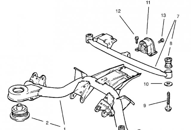

by EddeyDancer » Sat Mar 24, 2012 4:05 am
Is this Diagram of any use?
Can You see the relevant parts, on this???
Diagram Rear Axel.jpg (41.4 KiB) Viewed 14443 times
Re: Rear anti-roll bar links/bushes
by MadOnVaux! » Sat Mar 24, 2012 5:30 pm
I have the parts eddey cheers, they are not on that diagram though....the links attatch the ARB to the trailing arms.
I went to fit them this morning and what a bloody job.....got car jacked up ok and on stands, both lower bolts came out ok, but couldnt shift the top bit that slides over the ARB.....really had to rive at it and cut at the bush.....got the link off the passenger side but couldnt get the metal bit from the bush off the ARB, stuck fast....so had no chance in fitting the new one.........it'll have to be a garage job!! :(
