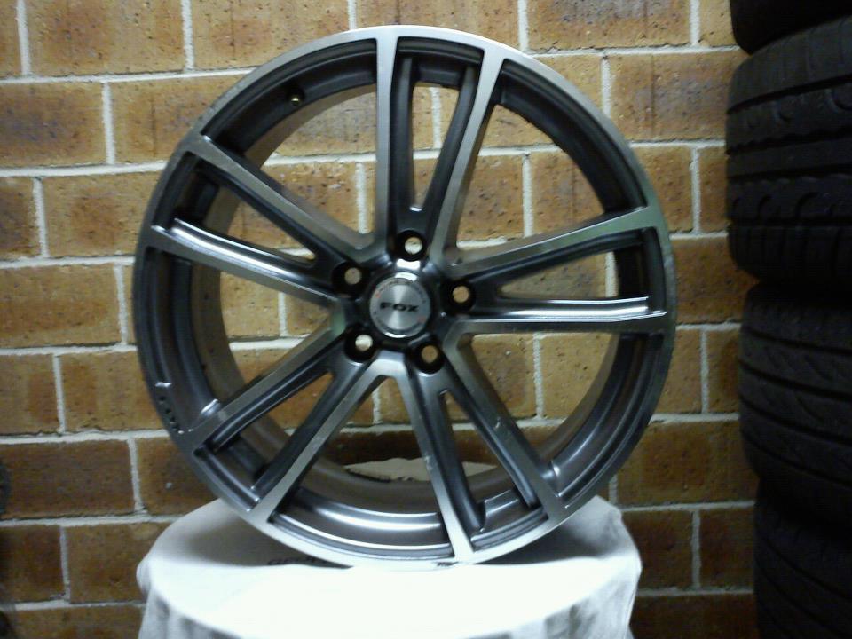

Hi Guys,
I bought the following rims on ebay they quoted 18x8, ET45 and PCD 5x110, link below:
http://www.ebay.com.au/itm/200830469338 ... 1497.l2649
I opened up a dispute in paypal, because I received today rims that were 18x8, ET42 and PCD 5x112, the sellers reponse was was:
Hi there,
You have ordered the wheels to fit a vauxhall vehicle which we have sent, in the uk we send 5x112 wheels to fit 5x110 / 5x112 / 5x114 this is normal practice and we do this every day without problems, we have sent you the correct bolts to fit these to the car and they wheels will look stunning on the car, please let me know if this is ok, so that we can resolve the issue, the only other option is t refund you in full once the goods are back as all of our alloys are 5x112
many thanks, michael, jjt
What do you guys think?
P.S. I looked at the bolts and they have a floating head which would allow fitment 5x110 but would this be safe?

I run a set of 18s with 112 centers on my v6 for many years and had no issues

Nor me...if it was listed as 5x110, then that is what you should have.
and refuse to pay return postage too, it's their mistake!

dont think i would be too happy his advert says 110, but wobble bolts will be fine its just down to how much you want the wheels

Thanks guys for all the responses it is appreciated.
Yeah I didn't appreciate the false advertising either it was upsetting to get something other than I expected, but I think I might keep them as I have been keen on these rims and it seem as per Steve's and Rich's advice they seem to be OK to run with the wobbly bolts, and Rich's seem to have been running on 18's with wobble bolts for years with no problems.
I'm currently running 17x7, ET49, 5x110. I think I'll also fit my 17's with semi racing slick's, and use them for a bit of weekend racing with the club MX-5 boys.
P.S. Just a little side note, as I was curious to know how much of difference their was between the weight of the orginal 205/55/15 rims and tyres they come in at 16.5kg, my 205/45/17 they come in at 17.5kg.

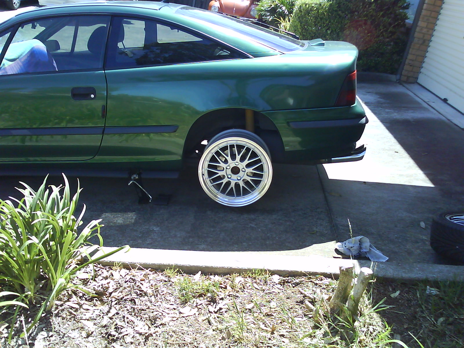

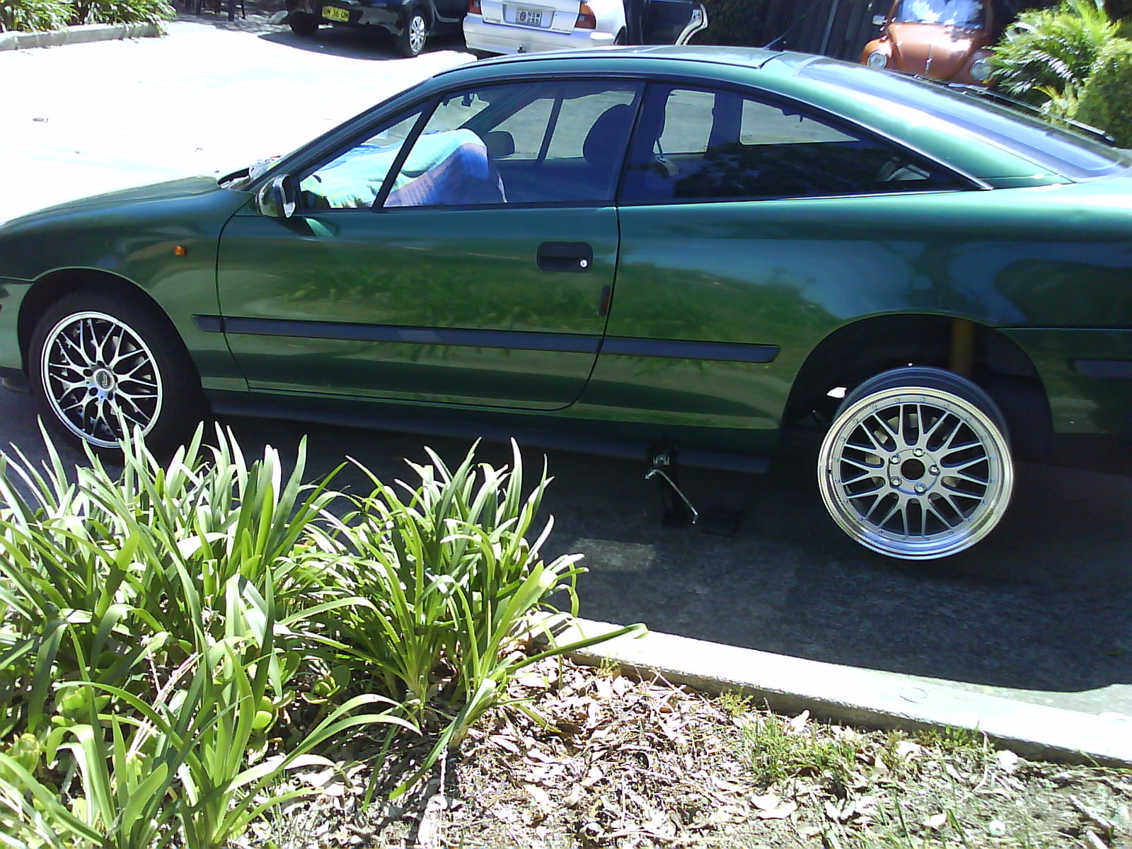

Hi Guys,
Below a photo with the test fit. I took out the old trust vernier caliper to measure up all the gaps and it will be OK with an ET45. The wheels have an ET of 42, but i have some four 3mm and four 5mm shims coming in to set that straight.
