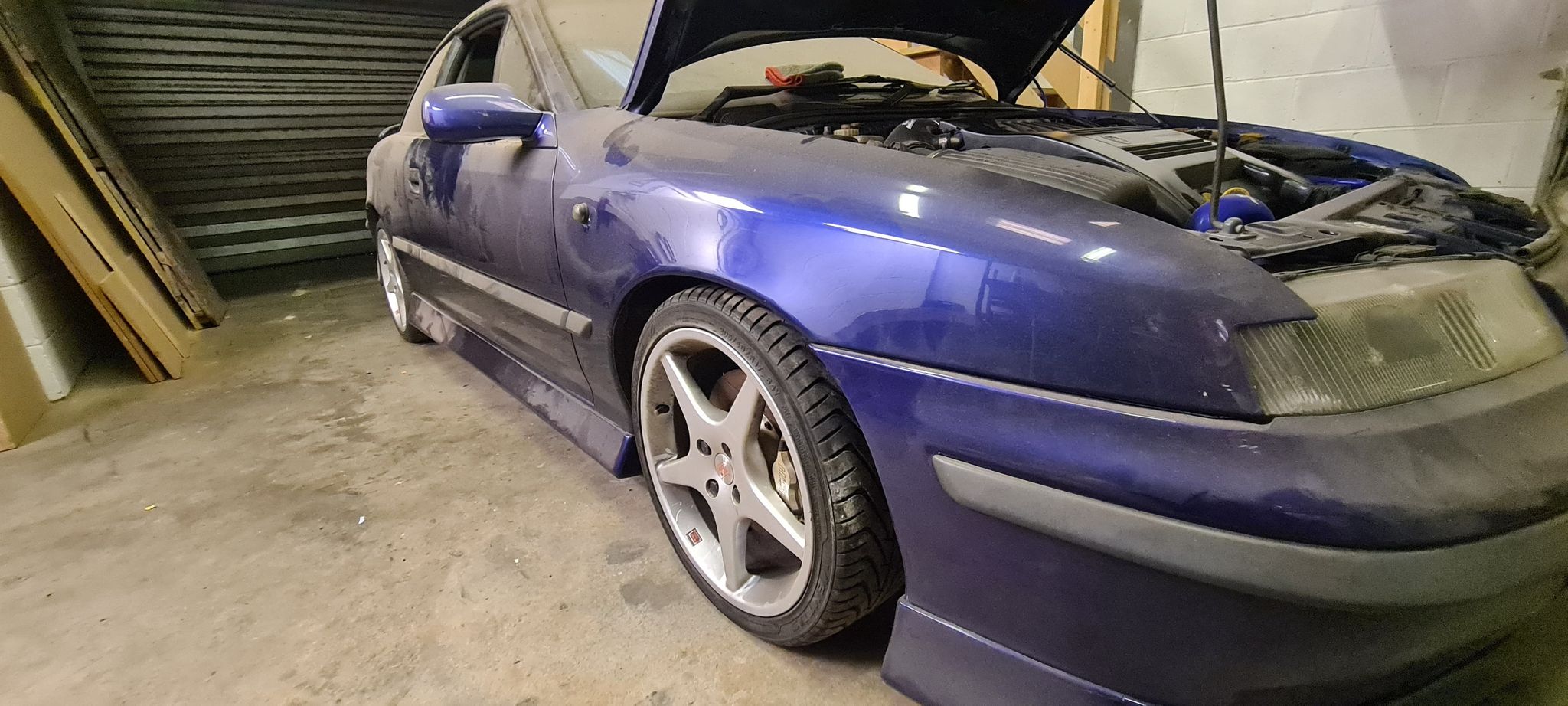

Previous member back on the forum now I have time on my hands! Looking for some advice on a brake upgrade for my DTM.
Originally an eco tech but now a LET so only four stud. I have had the turbo refurbed and she’s flying but not stopping right quick!
Shame as I’ve done a complete overhaul on the brakes including caliper rebuilds.
Looking for the best options available for my set up.
Cheers.

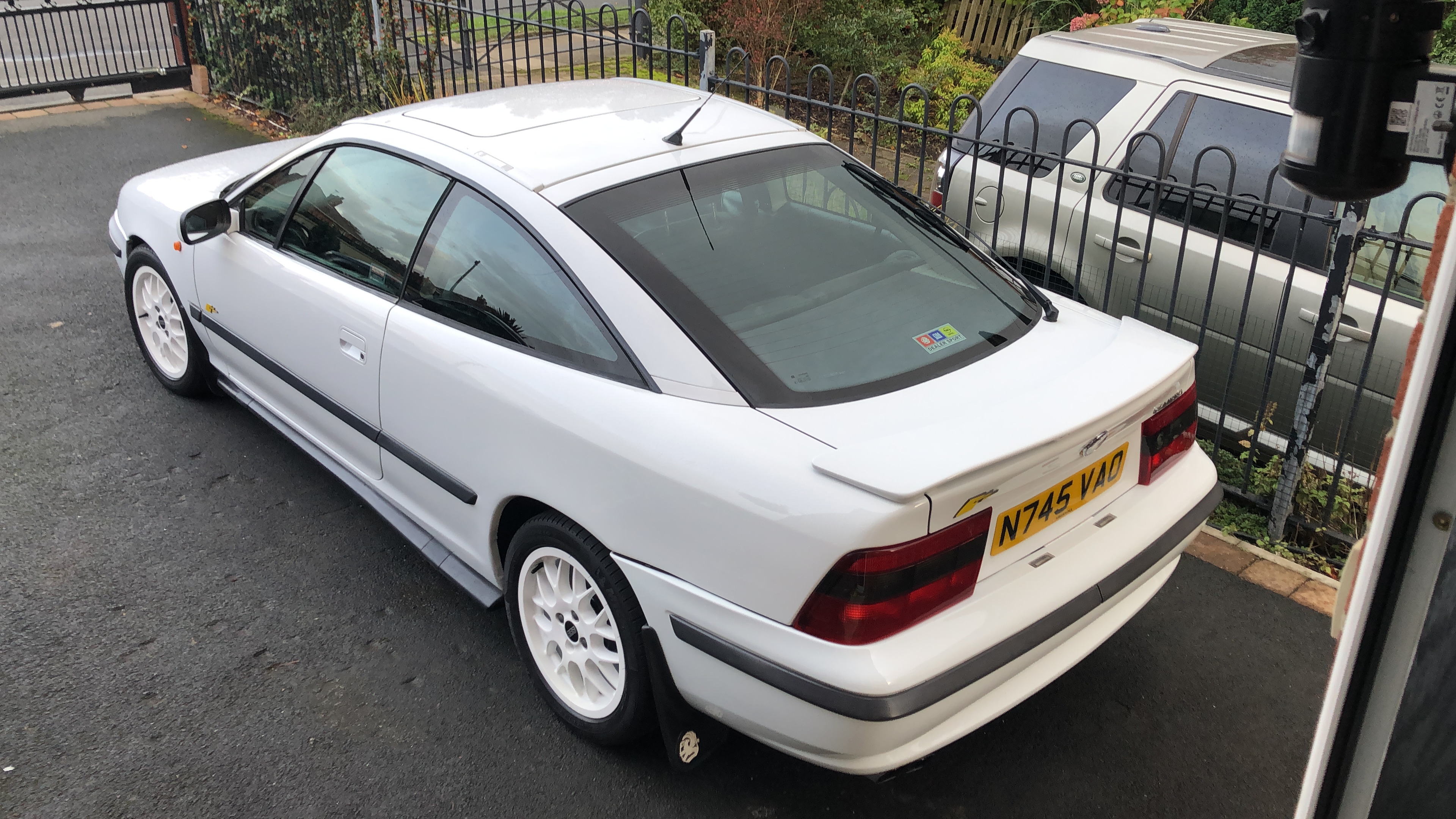

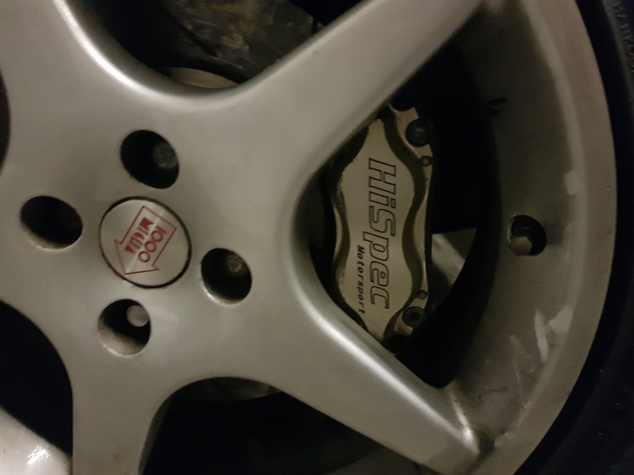

Mine was an ecotec too that I converted to v6 about 5 years ago. I kept the 4 stud since I prefer the wheels I have on the car now. I changed to v6 redrilled discs and calipers but without a spigot ring to centralise the discs I always had vibration on the front ( was horrible to drive) I trawled the fb sites and found some hispec 4 pots with 308mm discs in 4 stud. After spacing the calipers back with strategically placed washers to clear the alloys I've never looked back. Would share a picture but can't remember how to do that on here sorry.

HOT-ROD wrote:Mine was an ecotec too that I converted to v6 about 5 years ago. I kept the 4 stud since I prefer the wheels I have on the car now. I changed to v6 redrilled discs and calipers but without a spigot ring to centralise the discs I always had vibration on the front ( was horrible to drive) I trawled the fb sites and found some hispec 4 pots with 308mm discs in 4 stud. After spacing the calipers back with strategically placed washers to clear the alloys I've never looked back. Would share a picture but can't remember how to do that on here sorry.
Tony PM me the pics on FB and I will upload on here for you.
Re: Brake upgrade
by HOT-ROD » Mon Sep 28, 2020 7:45 pm
Best I can do for now Andy but can get more tomorrow night when I'm at the unit 8)
*Edited*
Andy.
This was with the v6 redrilled brakes on.

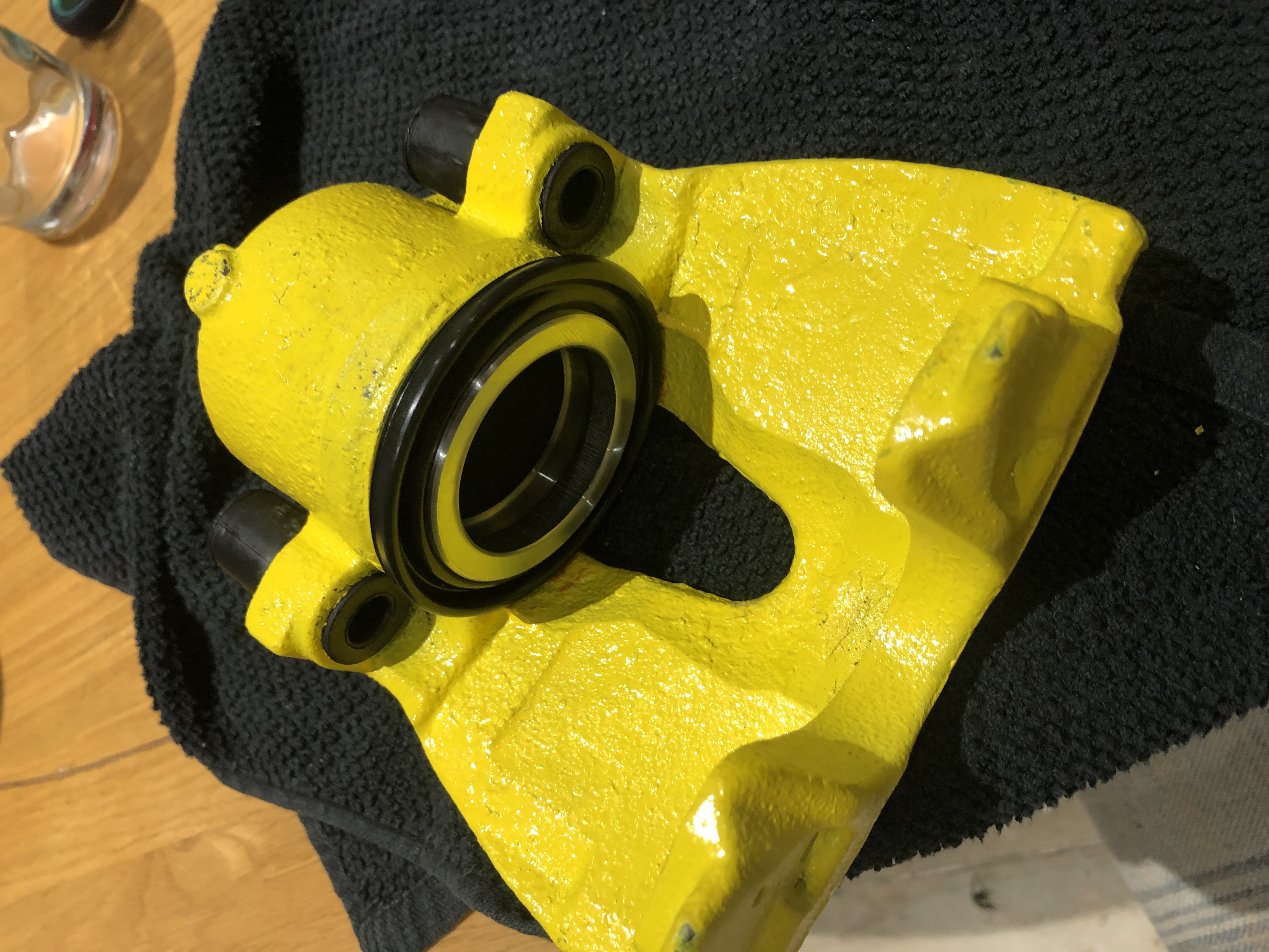

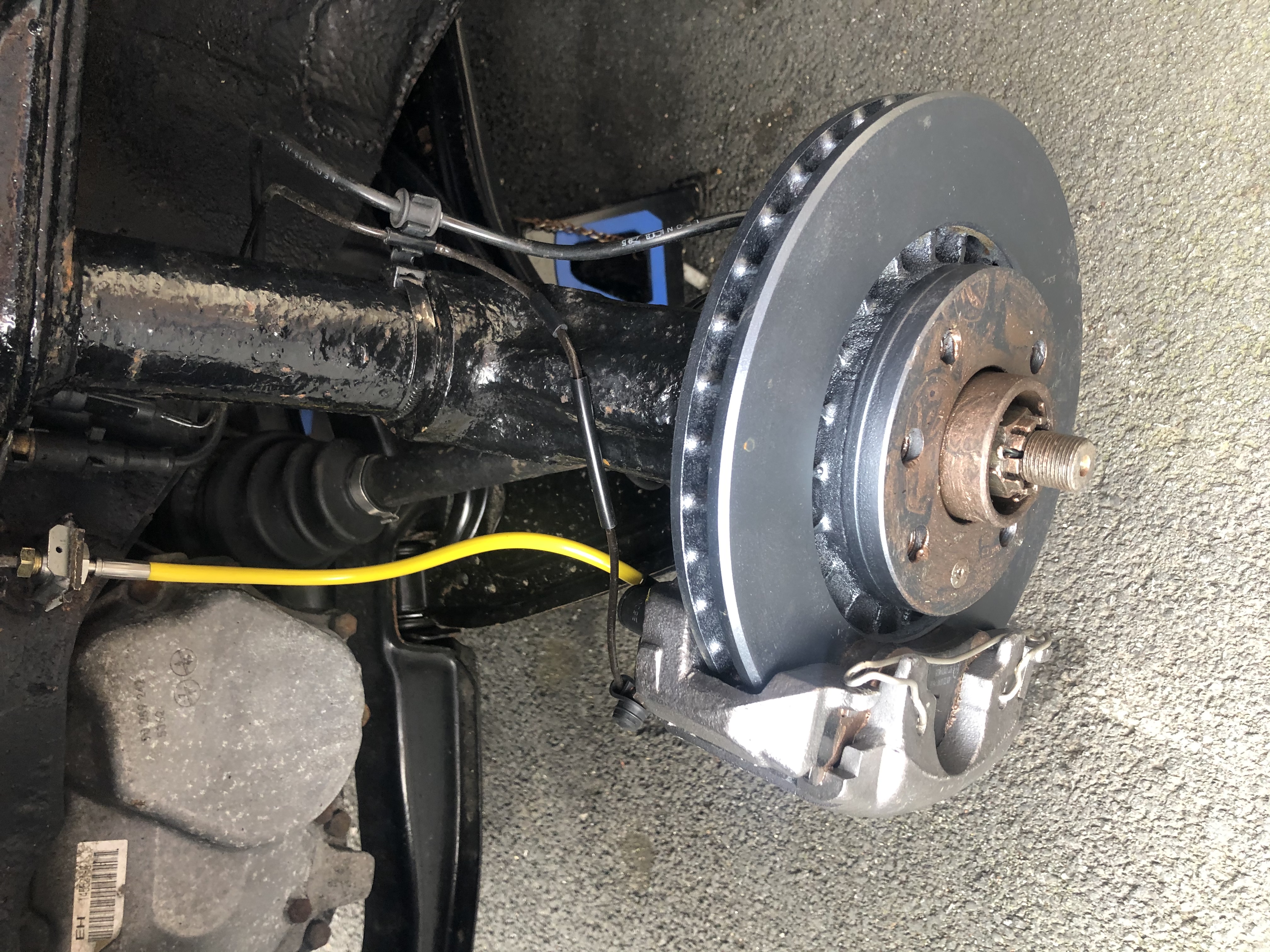

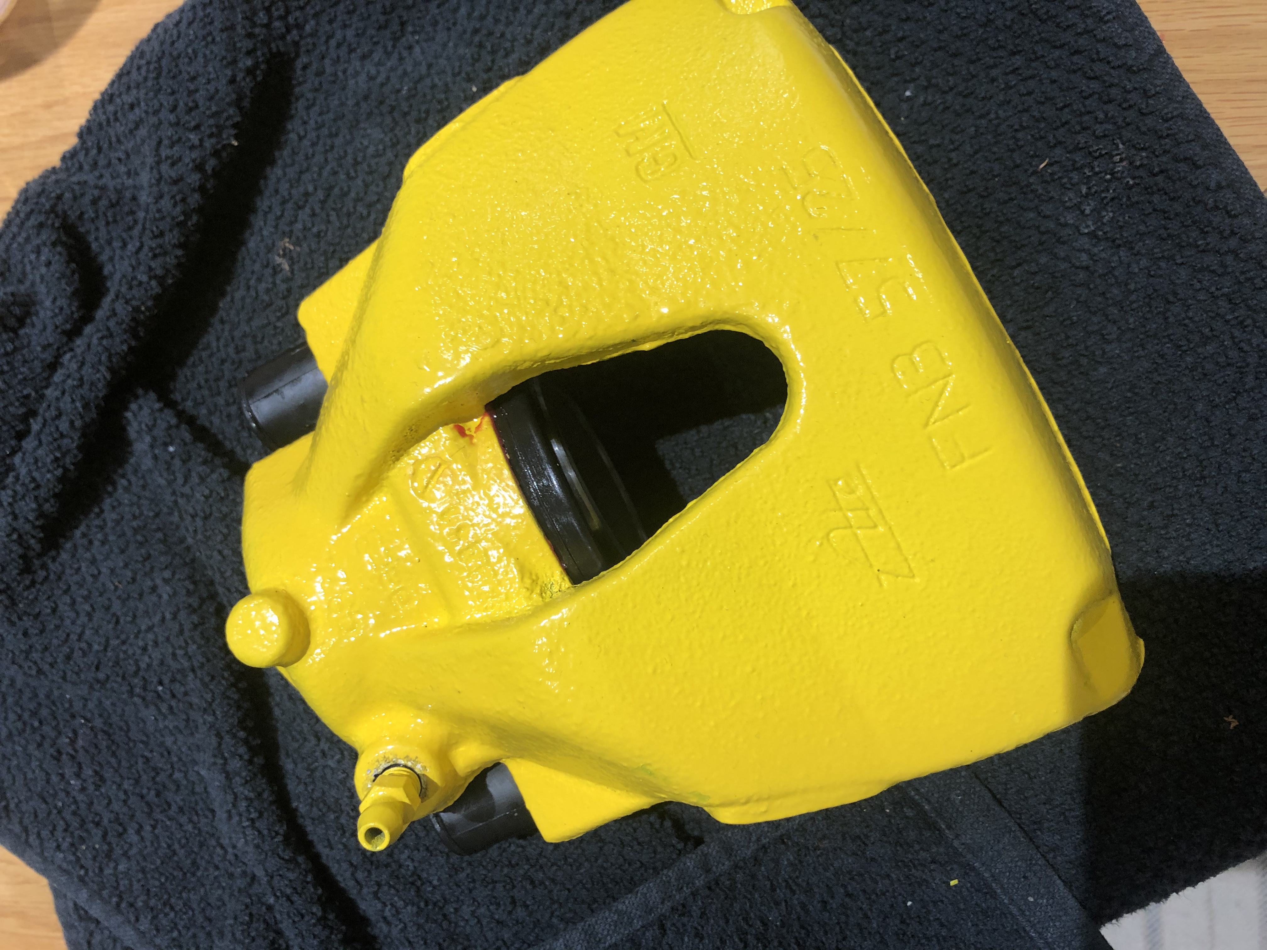

by Crusher » Fri Dec 18, 2020 6:43 pm
Sorted now cheers, couldn’t get Ksports to fit without a load of hassle!
Gone down the V6 Vectra caliper, & hangers along with Mtec 308 discs.
Rust removed and treated and then the yellow.
