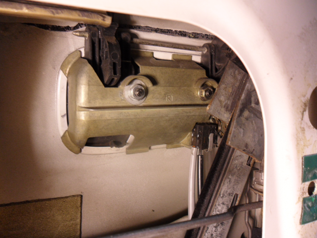

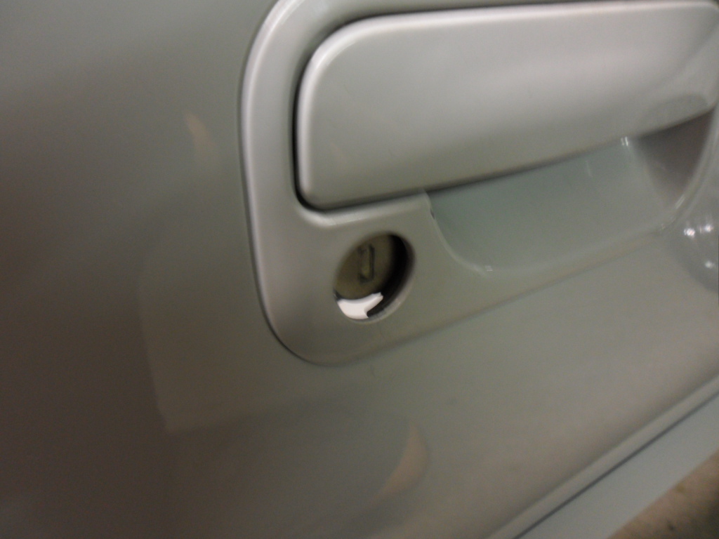

I've fitted both of the external 'Vectra Style' colour coded door handles...
The issue that I'm having, is that the 'Key Barrel' does not align correctly with the Key Hole...
I've fitted the Vectra Door Handles with the Original Calibra backing plates and switches untouched...
It works fine, but it's just that the alignment looks bad, and dirt and water can easliy get inside!!! :doh:
Has anyone else had this issue, who may be able to offer some useful information???

I'm sure you have to use the Vectra backplate, and re-drill the bolt/screw holes.

I was going to do this a while back, and got told i needed the Vectra backplate so the lock would line up, and re-drill the holes.....in the end i scrapped the idea and fitted proper new Calibra handle.
