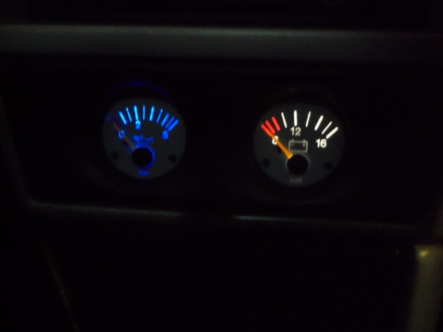

Fitted Bulb in Oil/Volt Gauges - Was blown

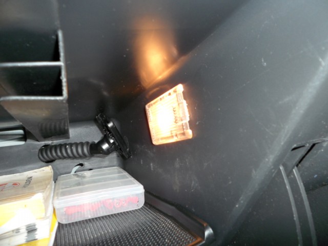

Replaced Glove Box Light Unit - Was burnt out

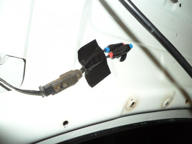

Replaced Centre Brake Light Unit and did the wiring properly - Kaput
Fitted 4 x new Bulbs in the Centre Brake Light Unit - 1 was blown
Fitted Rubber Gasket for Centre Brake Light - Was missing

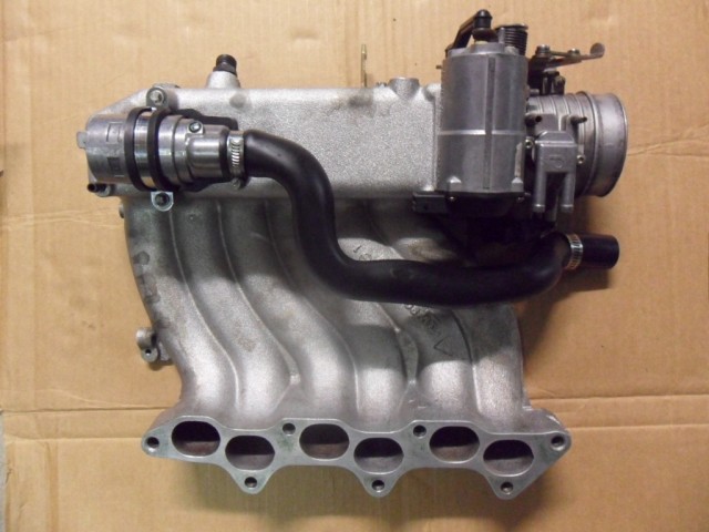

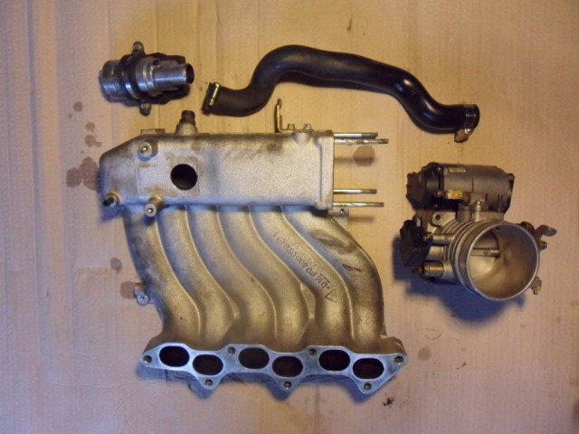

I replaced his door handles, and finally convinced him to ditch the shaggy seat covers...
Also did some Engine Work and for him recently, so he's happy with how it's running now...
- Attachments
- Lower%20Manifold%20Fitted.JPG (72.89 KiB) Viewed 76263 times
- Inlet%20Manifold%20Stripped.JPG (65.7 KiB) Viewed 76263 times
- Inlet%20Manifold%20Reconditioned.JPG (62.39 KiB) Viewed 76263 times
