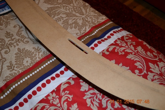

by cal16v » Fri Jan 30, 2015 9:58 pm
I have the top panel now cut and shaped and starting to work on the vent cut outs.

by cal16v » Sat Jan 31, 2015 6:06 am
Almost there...
Just need the recessed holes to secure it in place and a couple of coats of clear and it's ready.

I should have mentioned that this is simply assembled from layers of 3mm MDF. There is no for any “thicknessing” to do the job and only basic hand tools are needed. A coping saw and a hand drill, some sandpaper and a suitable block were used.
I must say that the piece turned out to be much less difficult to fabricate than I had first imagined and I’ll be sure to update this thread with more pics when it is finally fitted and in place.
