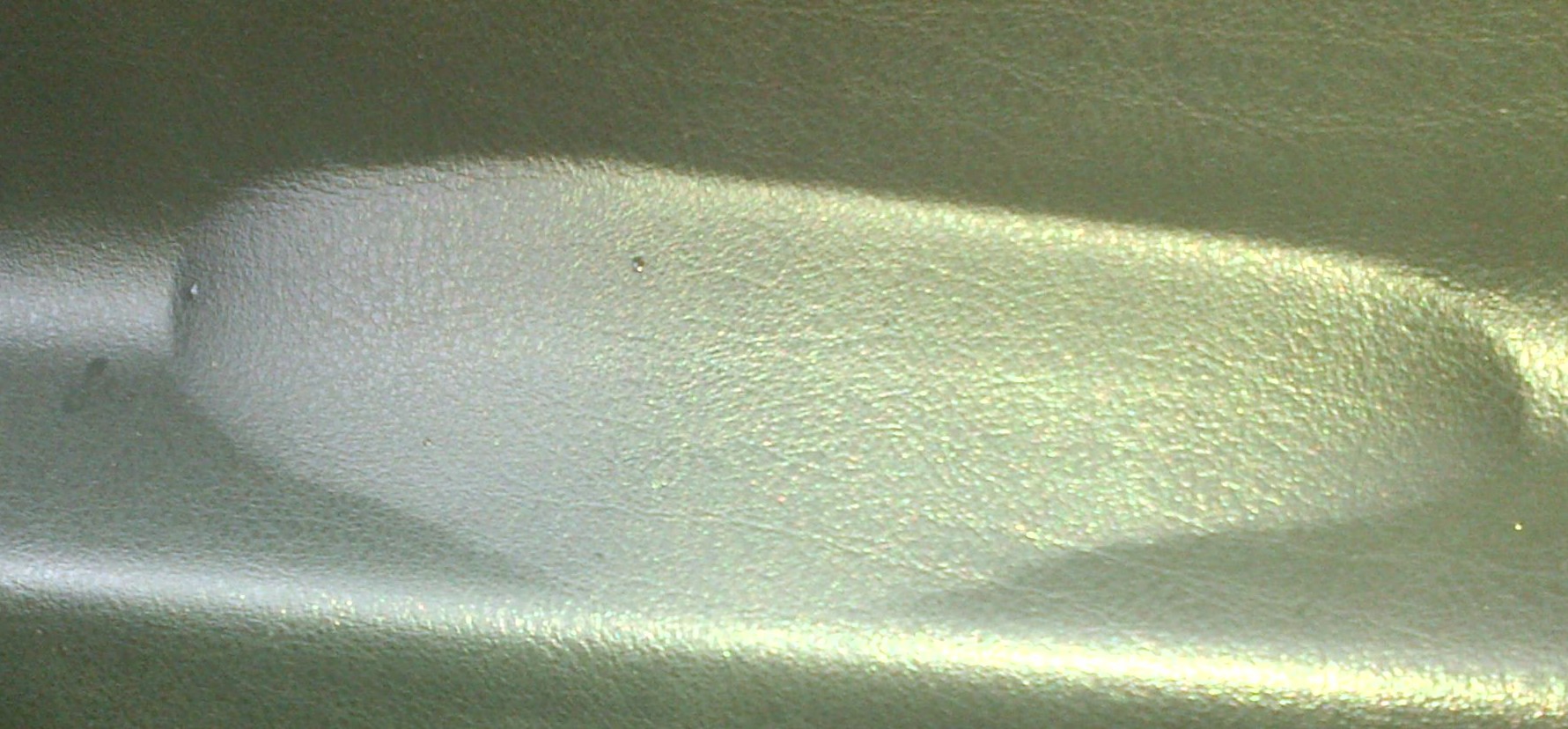

by RedCalibra33 » Tue Aug 25, 2015 5:20 pm
Has any one found a solution to this common problem? I'm thinking of piercing a small hole and spraying glue in!!! :pray:

I can't just leave it as I've always hated the sight of this problem.
I'm gonna heat up the material with the missus hairdryer, make a small hole at the end and squirt is some 3M spray glue with a straw attachment, then hold it in place with a rolling pin!

:axed: Major Fail!!! Do not try this at home!!!
3M spray glue not instant enough! And heating the vinyl did indeed allow it to stretch but now its just rippled!
Neighbour who is an upholsterer has quoted me £75!

by rips » Fri Aug 28, 2015 12:05 pm
That is similar to the path I was looking at:
Slit the bubbles open & stick the vinyl back, aligning it at the top & leaving a hole along the inside angle.
Create an insert to cover the hole up.
I'm not quite sure what I would use for an insert though.

Re: The dreaded door lining bubbled!!!
by HOT-ROD » Fri Aug 28, 2015 2:06 pm
Would be quite easy to make a cap to fit it to be fair and all I would do is pad it out a little and cover it with the same material the door cards done in so it looks like it was ment to be there. :think:

by HOT-ROD » Fri Aug 28, 2015 5:47 pm
Was thinking more like taking an old door card and cutting the arm rest off so you could curl it down the side a little then you could probably just glue it on top with some contact adhesive.

by RedCalibra33 » Sat Sep 12, 2015 9:38 am
How about this? Bit too chunky maybe? Just awaiting dimensions from seller.
