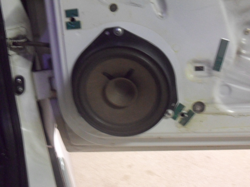

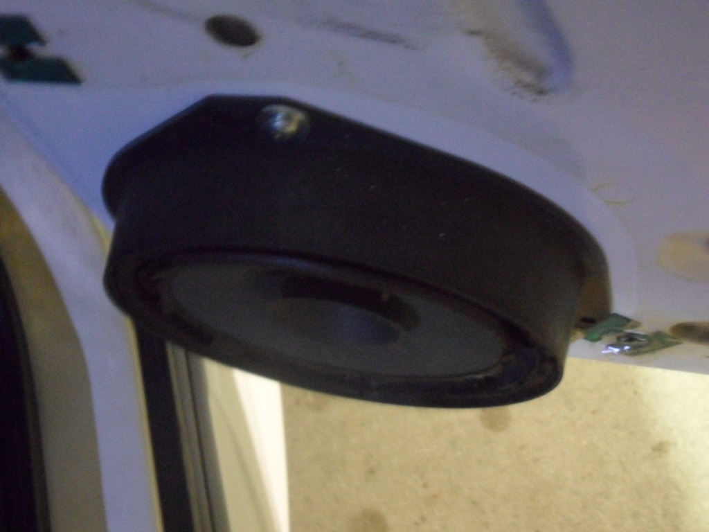

I'm looking at replacing the Front Door Speakers...
Are the Original Speaker Mounts, discarded when the Speaker is replaced?
Or are the mounts removed, and then fitted onto the New Speaker???
Re: Front Splits
I used all Hertz's in mine and I'm please with the end resualt.
As For the mounts, I think they were reused.
Re: Front Splits
It's all one piece, remove speaker and promptly discard all into the bin
I made up some mdf spacers from 18mm that extended further into the door card that the crossover mounted to
With the tweeter I removed the standard one and re-used the mount for the new ones.

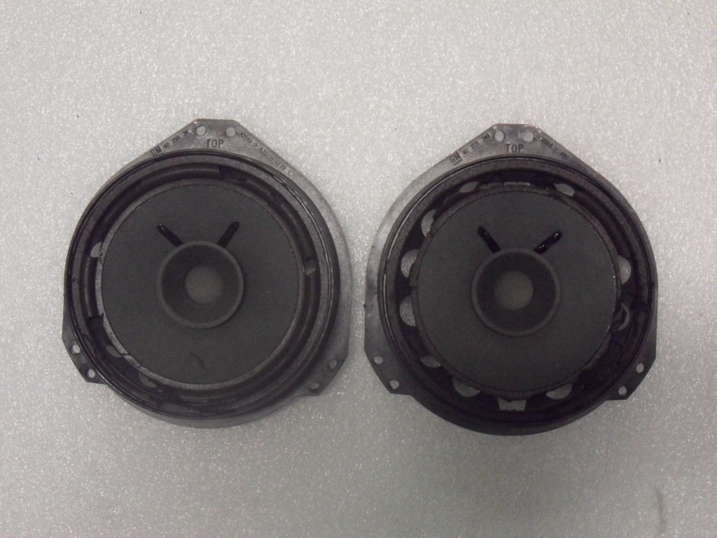

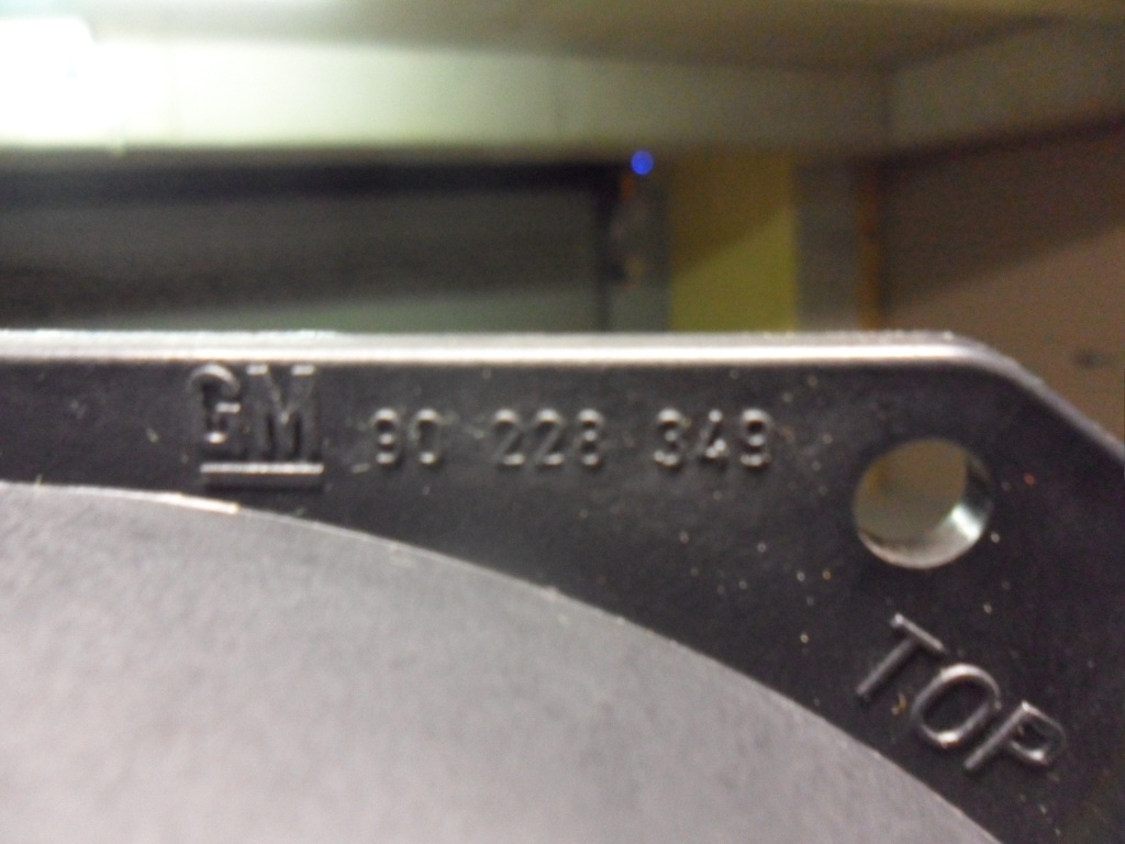

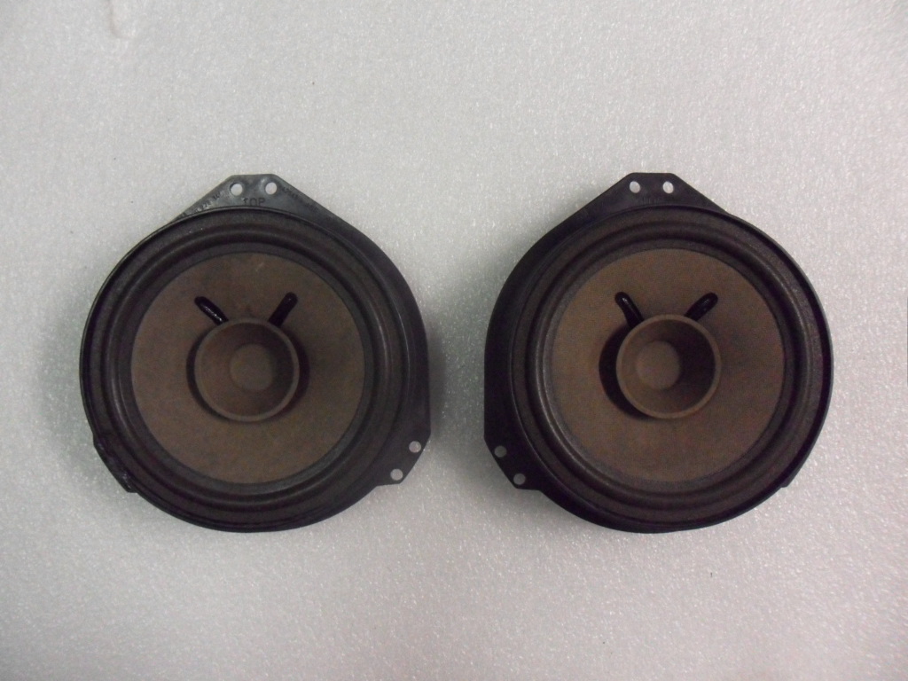

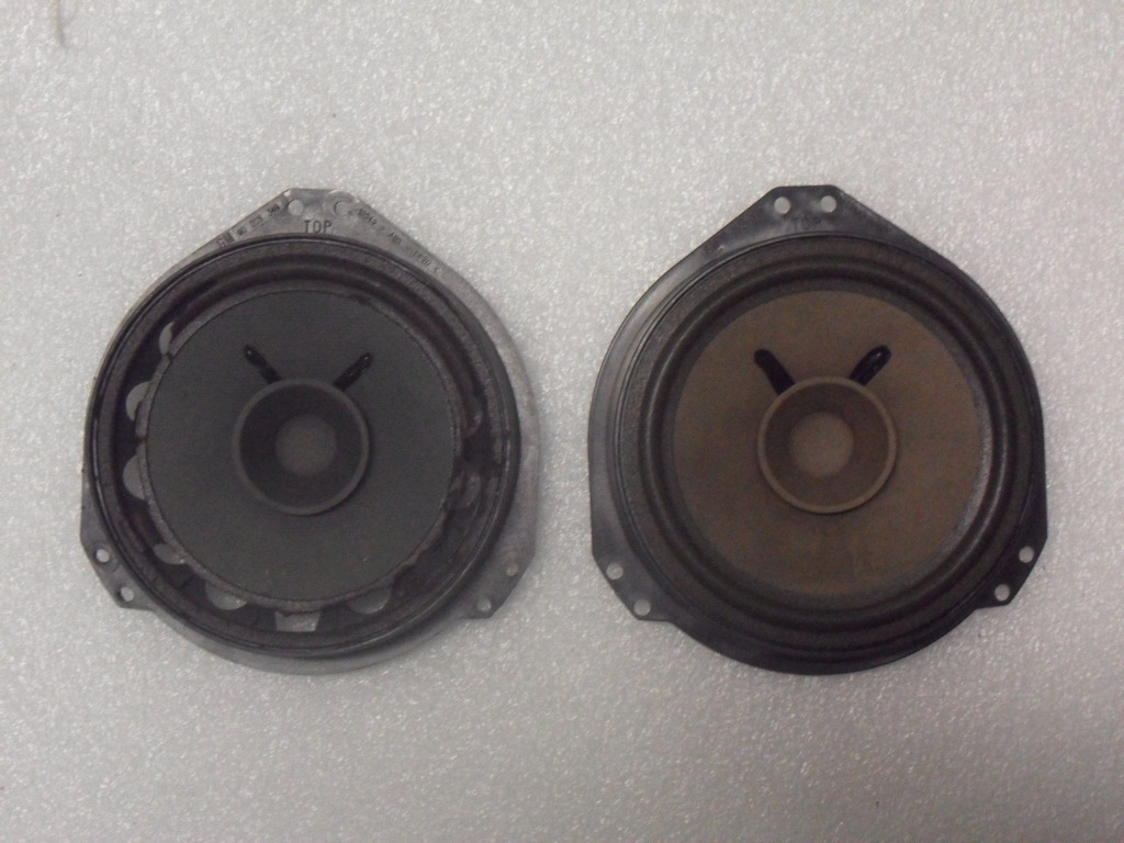

Replaced the Blown Speakers today...
Discovered that the Vectra front speakers, are exactly the same as Calibra front speakers!
So that worked out well for Me...
