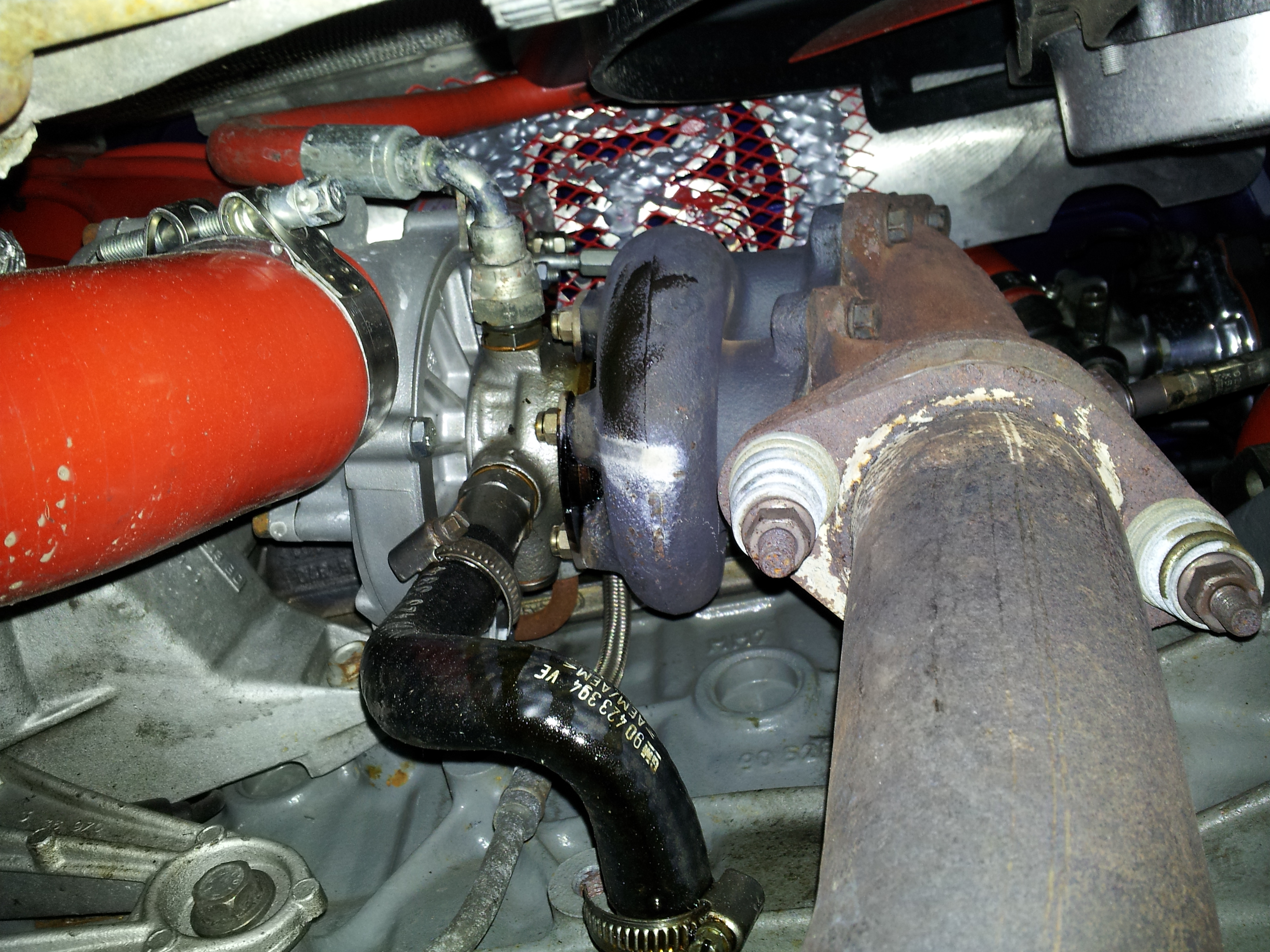

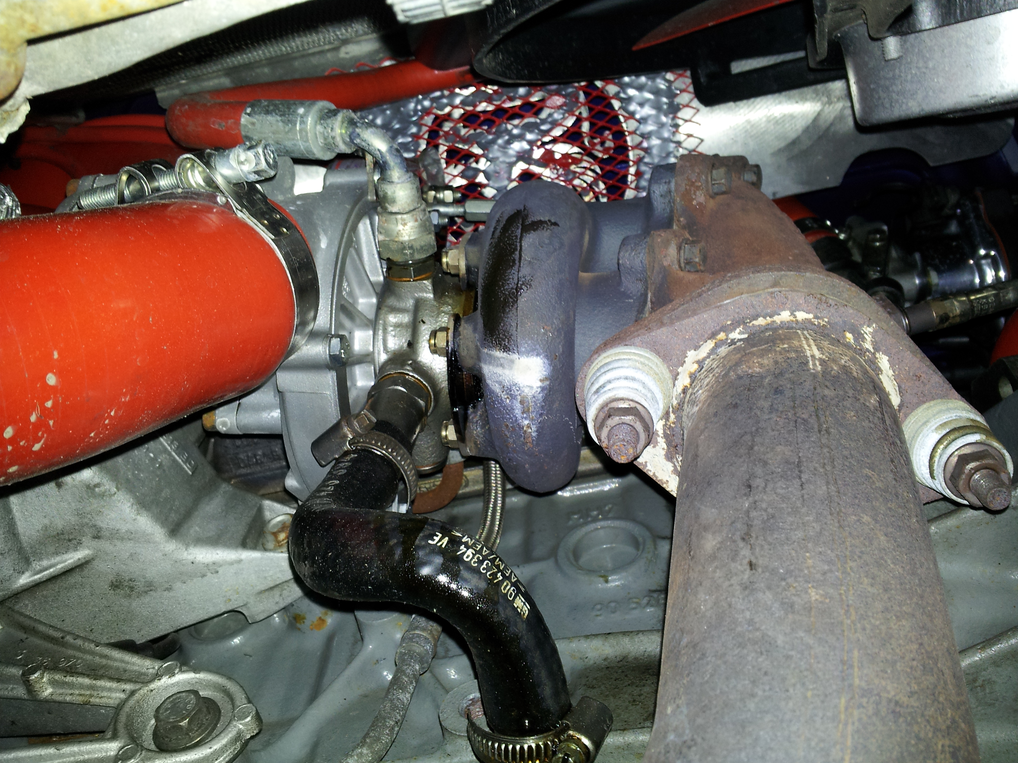

Well that was one of those days you wish you didnt do a job lol
Removed the elbow to check the inside of turbo and right at the start i got a problem.
One of them horrid cast 11mm bolts sheared of like it was made of butter
Now ive got the problem of trying to remove it from the turbo
And tbh, it seems like i might have done this damge for nothing!!!
Not seeing any damage in there to the penny valve ect other than the fact its really loose??
Not sure if this is the normal as i cant truely remember how it was on the other cars in the past.
No cracks tho ! Did seem rather white in there and i noticed the end of the lambda sensor was white also.
Added some pics anyway to show what i found. Ended up removing the whole turbo as i now have to fiqure out how to get the dam cast bolt out of the turbo ! Tried to drill for extractor tool but none of my drill bits will scratch the dam thing

Re: Not feeling the power from my turbo!
Hold up! Is that a small crack in the rim i can see there?? only tiny but looks like it might be one
The Turbo can leak oil onto the outer casing. Mine did it.
You can see it on the drain pipe and where I've rubbed it onto the casing. It Wasn't coming from the pipe fitting.
If you have high oil pressure you really need staggered oil seals.
