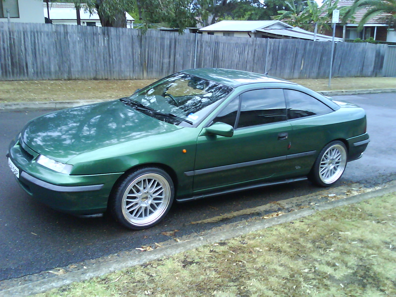

Im liking the look of those wheels....it'll look superb when all 4 are on
Re: Rio Verde Green V6
BMJ wrote:As a note, the tyres are 225/35/18 and the rims ET is 47, and there is plenty of clearance behind the wheel...
You've done very well there...
The New Rims look much better with that Deeper Dish Style...
I think you should have gone for the 40 Profile instead of the 35 though, with 235's at the Rear...
It's looking really good...

MadOnVaux! wrote:Im liking the look of those wheels....it'll look superb when all 4 are on
Thanks MadOn Vaux. I'll be fitting the new tyres and rims sunday and getting a wheel alignment shortly thereafter. Brake calipers are going to be red on slotted disc's all round.
EddeyDancer wrote:BMJ wrote:As a note, the tyres are 225/35/18 and the rims ET is 47, and there is plenty of clearance behind the wheel...
Thanks Eddey. I might try 235/35/18 down the track for the rear, but im definitely sticking to the 225/35/18 on the front.

I know what you mean, I like the snow flake design also and went for a similiar design in the 18's.
Below is a picture of the new rims fittted.

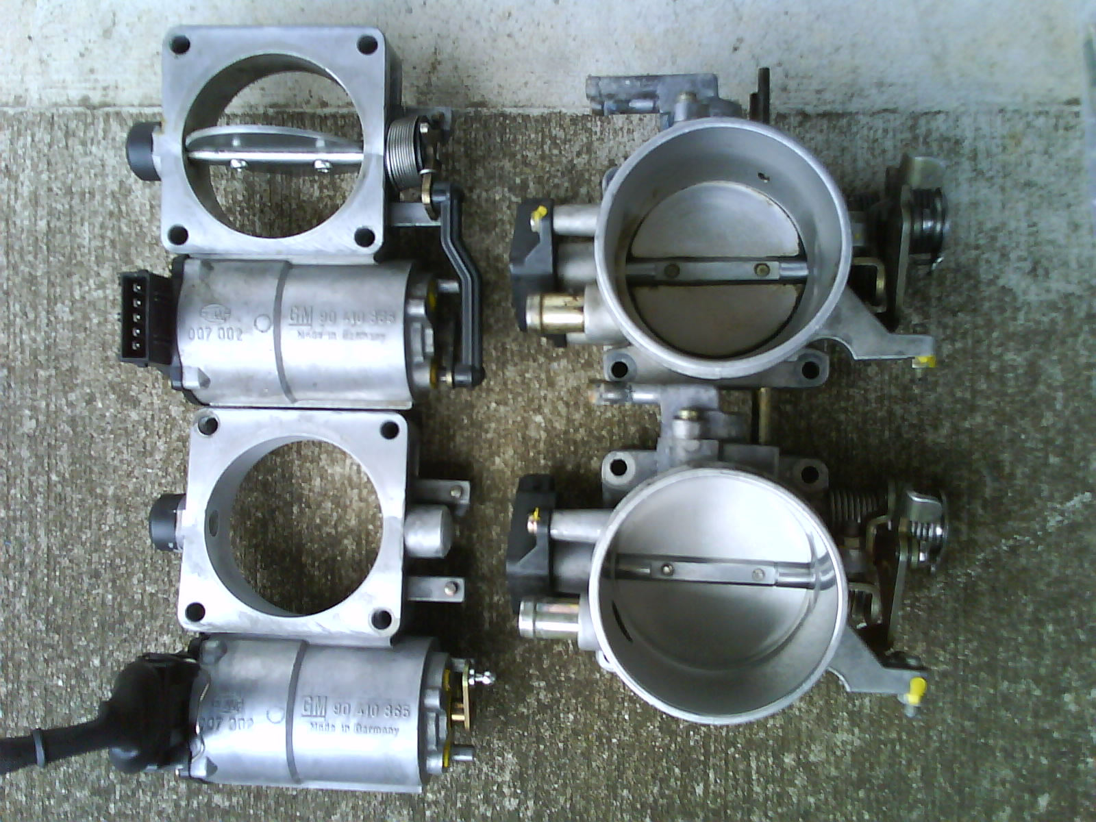

Hi Guys,
I received the reworked throttle body and traction control body just before christmas, the internal diameter of the throttle body was increased from 64mm to 72mm before the butterfly and after the butterfly increased to 68mm to match the traction control internal diameter of 68mm. Also I had the traction control body blanked, as this will soon be made redundant by the a quaife limited slip differential that is to be fitted soon.

If you wish to get this done here are the details.
Throttle Body & Traction Control Modifications.
With permission from Gav Howe.
ebay seller name: sneakapeak99
Description of ebay sale, Quote:
"Please note this is to send your own throttle body to be worked as its very difficult to source these now. The buy it now price is £60 free uk delivery
c25xe v6 MODIFIED throttle body which is machined out to a 68mm bore from the original standard 64mm bore. A new butterfly has been CNC machined to the precise angle to ensure a snug fit, using 2mm ground aluminium plate with the spindle modified to suit. All throttle bodies are re-greased and internals polished to a mirror finish.
PLEASE DO NOT MISTAKE THIS PRODUCT WITH SOME OTHERS FOR SALE WITH THE ORIGINAL MANUFACTURED 64mm BORE. ALL c25xe engines have this as original equipment. This may be the ONLY place you can get them at the modified size of 68mm creating that extra power beyond that of the standard 64mm bore.
This 68mm throttle body will unrestrict your v6 and allow it to pull strong all up the rev range and iliminating any flat spots you have. 10+ bhp and 18+ lb torque increase
All work is carried out by myself to guarantee highest quality. I am a qualified Engineer and skilled Machinist, with all machine work carried out on a state of the art cnc 3axis milling machine and lathe. I have many years experience in the motor sports trade, building and tuning many popular petrol engines. I can modify many types of throttle body, and can offer other engineering services on request. Please check my feedback - 100% positive... "
I've also asked Gav if he would match the Traction Control and he said, there's no need to as that already has a internal diameter is already 68mm. But he will blank it off for you and polish the bore.
