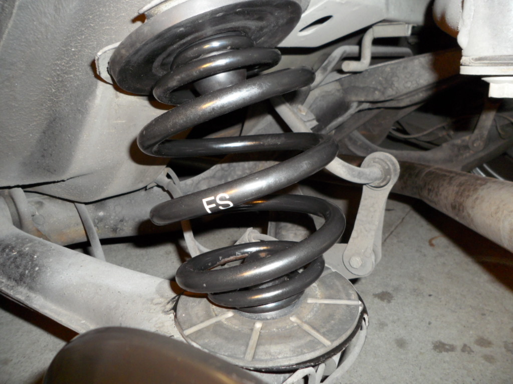

Re: REAR SPRINGS PAD BUSH KIT
by EddeyDancer » Tue Oct 16, 2012 3:20 am
It can be seen clearly in this photo, at the base of the spring...
