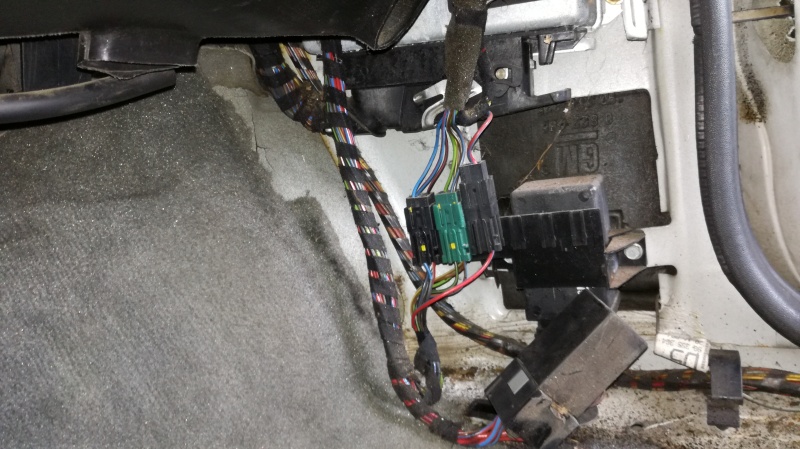

It seems like my ABS is the first type so I guess the issue is in the ABS ECU.
Took a look at the passenger footwell, got a random relay hanging off and I have no idea what any of this does, the big Bosch box is the engine ECU or ABS? My car is a 1993 German made Opel Calibra 2.0 8v. Where do I find these surge arrester relays? The diagnostic definately shows nothing.

by Cliff » Fri Jul 01, 2016 1:54 pm
Hi! So you have the 2E version which is good because it's serviceable. Your picture with the larger metal box is the main ECU so not ABS.

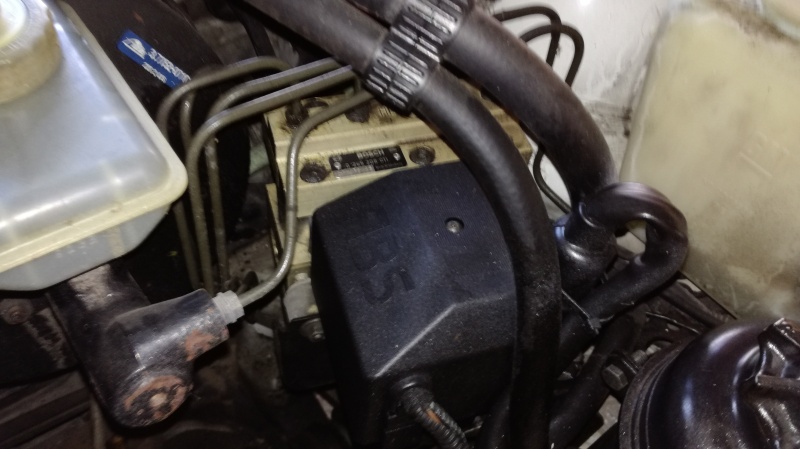

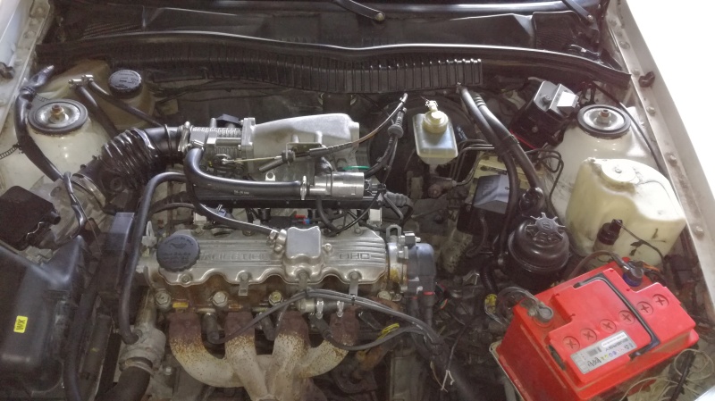

Thanks :) Is the engine fuse box behind the ABS in the engine bay? Because in my case there is no engine fuse box then.
Edit: Engine pic
I did notice I'm missing a foglight relay haha.

by Cliff » Sun Jul 03, 2016 5:14 pm
Hi again - sorry for the delay. Confusing you don't have the engine bay box but that's just because I haven't seen that before.
Here's the wiring diagram for early models:
And late models:
Early models show the existence of the surge arrester relay which should be in the engine bay. Later models didn't have it. Both are protected by fuse - I assume you've checked that's ok?
Early model ABS control units were separate and mounted at the side of the drivers side seat (assuming this is an Opel?? Otherwise passenger side seat). Between the seat and the door is what I can only describe as a plastic "lump" hiding the carpet that you can see on the opposite side. Not the same as the footwell covers that you removed in pics above. You remove the cover lid and the ECU is there. Later models were attached to the hydraulic unit. I think yours is later 2EH not 2E as I said earlier but checking for the ECU in that plastic lump would confirm.
If you confirm that fuse is OK, that this is later model and no ECU at side of seat (here's a pic):
Then it's time to check for power at the ECU hydraulic unit in the engine bay.

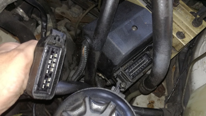

by chargerbandit » Mon Jul 04, 2016 1:04 pm
Okay thanks for the tips. So I searched for the ECU in the interior, it is not there. Then I tried multiple fuses and probed the socket and the power is there. Then I unplugged this big connector at the ABS unit (which looks like the one at the interior ECU, so I guess my ECU is under the ABS?) and the plug itself doesnt have power, but the pins on the ABS socket have power, ranging from 4.7 volts on some, I think one pin has around 11v and one was 3v. Picture attached, what's the next step, new ECU?

by Cliff » Mon Jul 04, 2016 3:00 pm
Yes your ECU is on the block. You can do one more thing which is leave the ABS ECU plug unplugged, remove the lid from the ABS unit and remove then test the two relays. In the meantime I'll see if I can find a pinout for the connector so you can check you have 12v on the right pins.

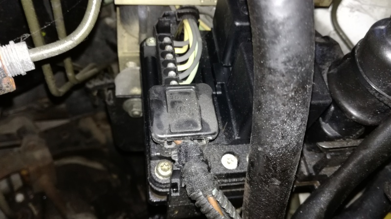

by chargerbandit » Tue Jul 05, 2016 11:21 am
So I took the cover off today, took out the relays and tested them, I am pretty sure they work fine. So I was trying some other points and these leads that come from the side give almost no reading on my multimeter (something like 0.2V) even when the car is running. Maybe that is the source of my problem?

by Cliff » Tue Jul 05, 2016 12:17 pm
Ah-ha - yes - is it a 4 pin connector?

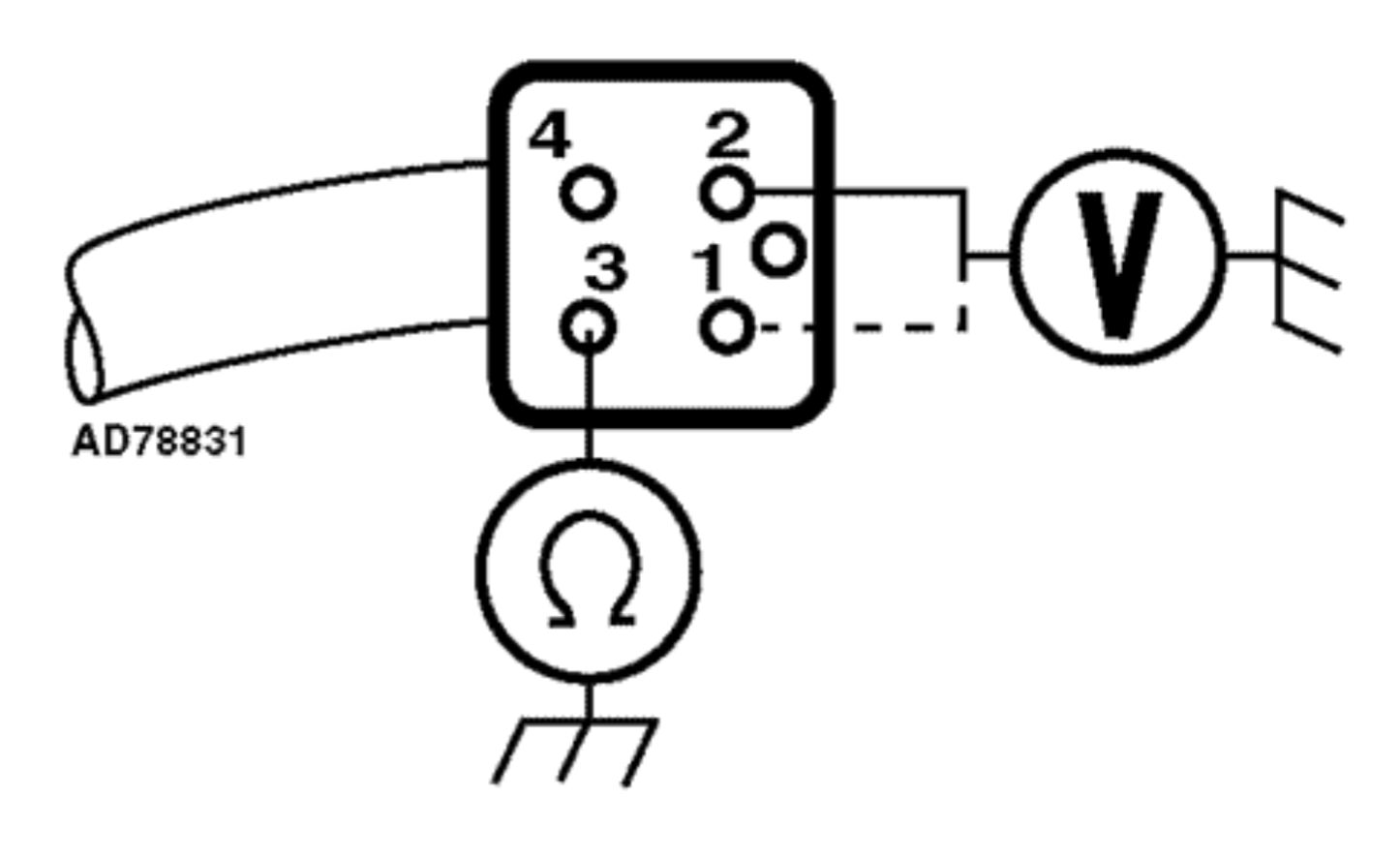

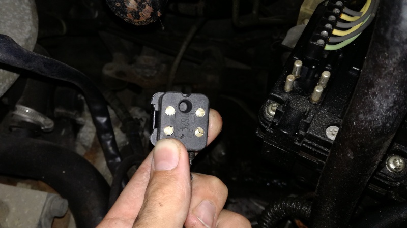

by chargerbandit » Tue Jul 05, 2016 12:47 pm
This is the connector, I went back and remeasured the stuff, the top two pins show 12V while the bottom two nothing. So I went and started remeasuring those other wires and when I grounded I think the yellow wire the ABS started making noise? Also those wires previously showed nothing now they mostly show 12V and it confuses me. I am out of ideas here.

by Cliff » Tue Jul 05, 2016 12:55 pm
Check the connections as follows:
Pin 1 to earth - 12v with ignition on
Pin 2 to earth - permanent 12v
Pin 3 to earth - 0 ohms resistance (this should be earth/ground)
Posts: 515
Re: ABS not working
by Cliff » Tue Jul 05, 2016 12:56 pm
If pin 3 has a high resistance to earth/ground then you have a bad connection somewhere - you can trace it back and find the break or simply splice to ground (new wire).
