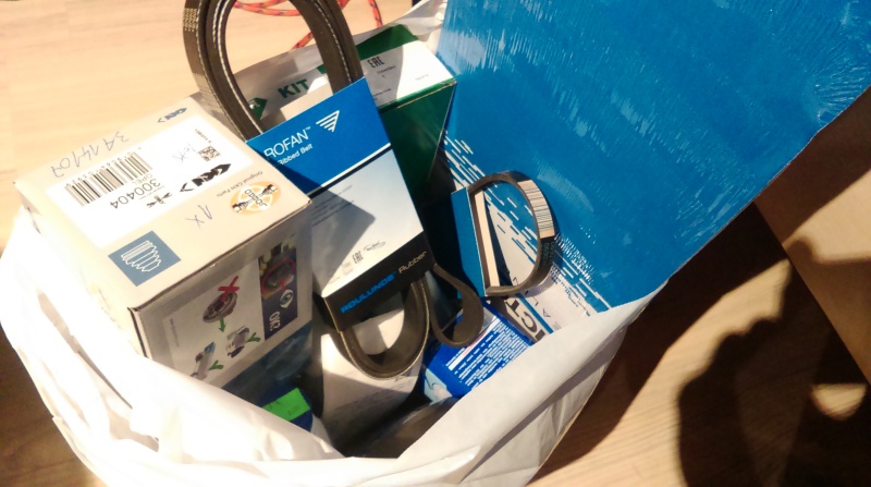

First step was to do some serious maintenance on the engine, all the belts, pump etc. Previous owners tried to kill the car but they didn't succeed. Belt was barely holding together, water pump was held in by regular silicone and was leaking super hard... Replaced everything, did some work on suspension - bushings, rear brakes (those damn handbrake plates are almost rusted through), brake lines.

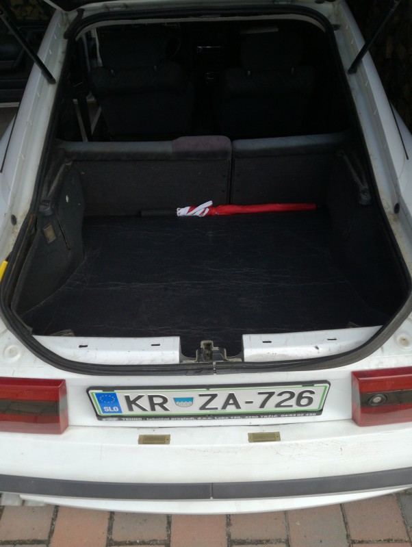

Also reupholstered the roof lining and the trunk. Plenty of parts broken or missing and it will be a challenge to find some of those.

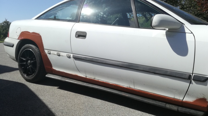

Next step - replacing sills and quarterpanel and then off to paint!

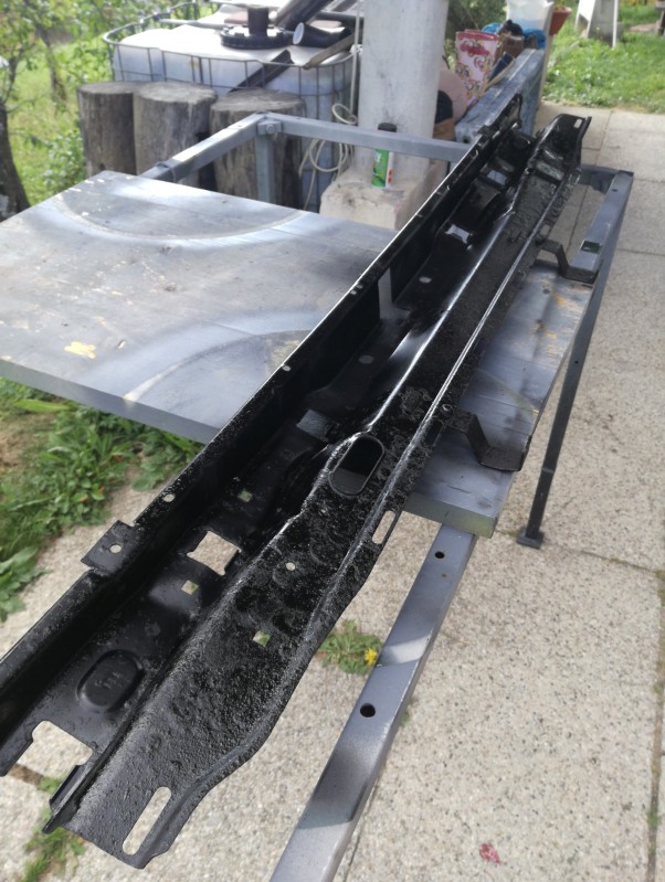

Boom, no more rust! Getting ready for paint.

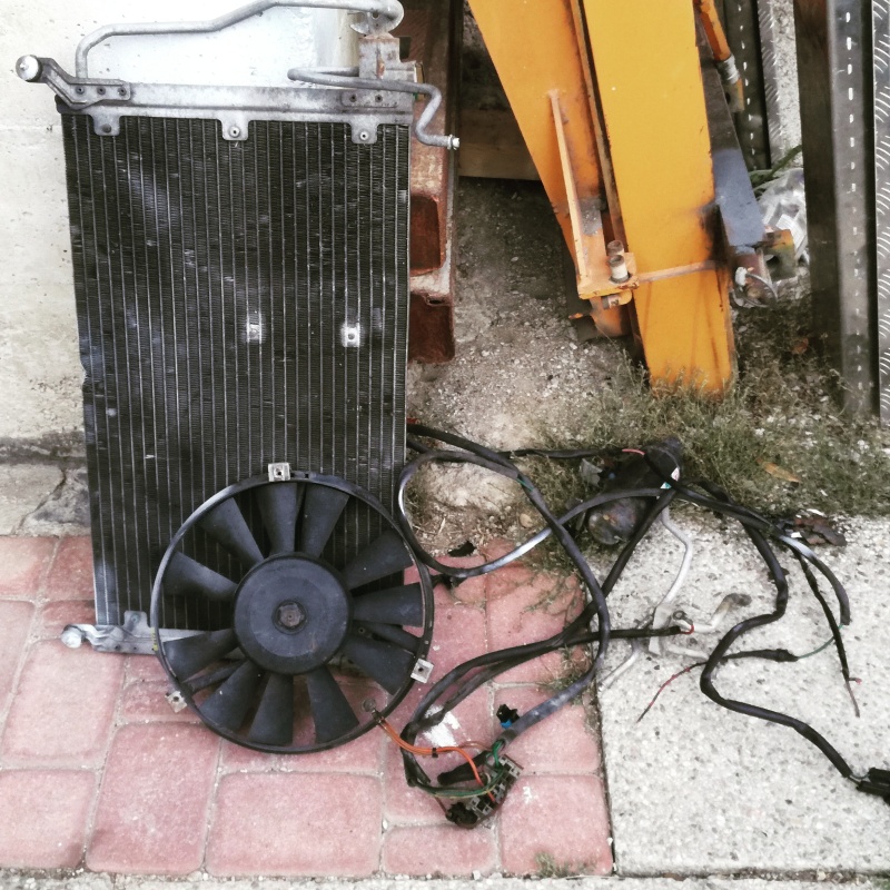

AC delete wohooo weight reduction, it was shot anyways and its a R12 aftermarket system so it was sketchy at best.
